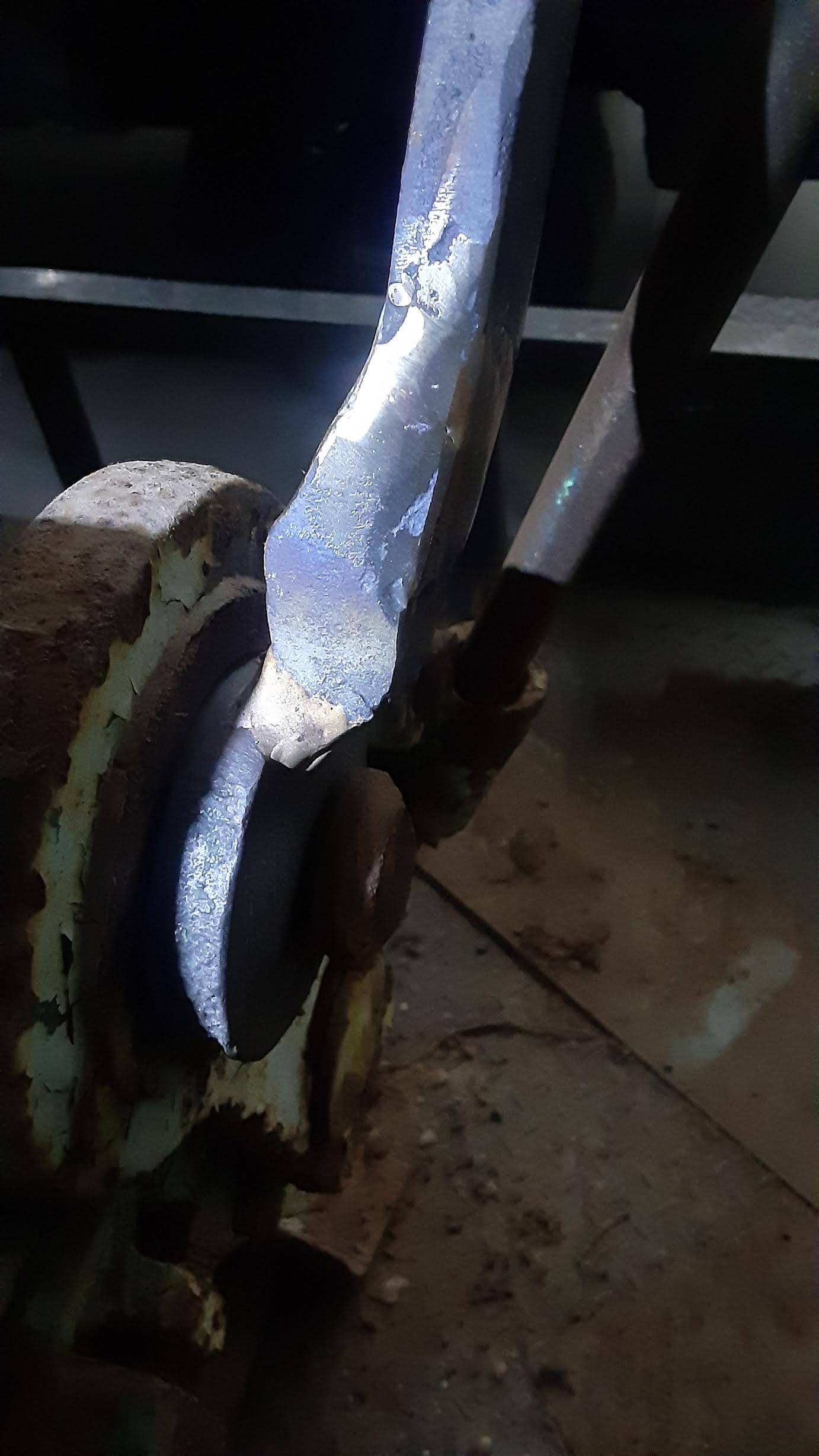

This is a method I use fairly often for cast iron repairs, using a TIG welder and silicon bronze filler rod. Broken part is sand blasted, with most attention on fracture area.
Set up parts so fracture is aligned just "sitting there", a clamp and shims can help.
Grind away material to gain surface area for the silicon bronze to adhere to but leave enough for the parts to be perfectly aligned at the cleave.
Tac either end, top and bottom, make a root pass and come back with a few more to fully fill the joint.
Sand it, if you want it to look pretty.
   / One way to repair cast iron.

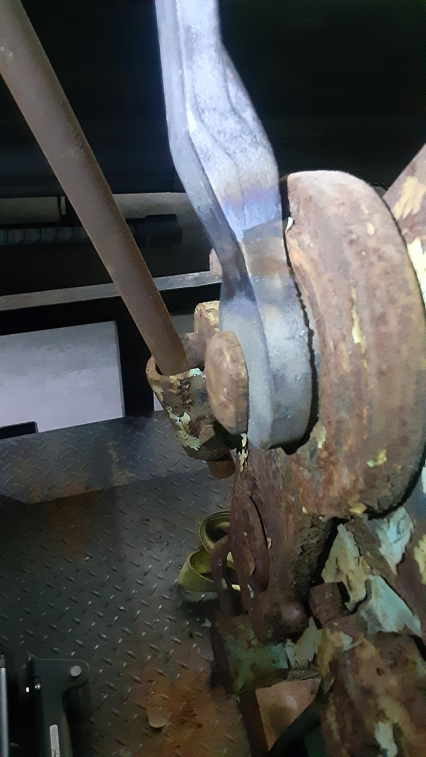

It’s the eccentric cam that operates the clamp on an 8ft brake. This is it installed.
It is a fairly decent repair method due to ease (no pre/post heat) and the other side has been knocked off twice and it failed at a different spot than where the first repair was, up into a thicker section of the arm.

Thanks for the update. That brake looks like it's been in service for a while.
It was, went down hill in storage at our farm though and broken (again). I am in the process of cleaning it up now. Becoming functional again is the first step, after getting it back home.
I also had to straighten the arms for the counter weights but that’s a different forum.
There are a number of ways to fix broken cast iron parts, what one I choose depends on a number of factors but the method above is an easy one. Certainly not the most difficult and I try to not complicate things, if I don’t have to.
A TIG gives me more control than a torch without all the extra flame.
