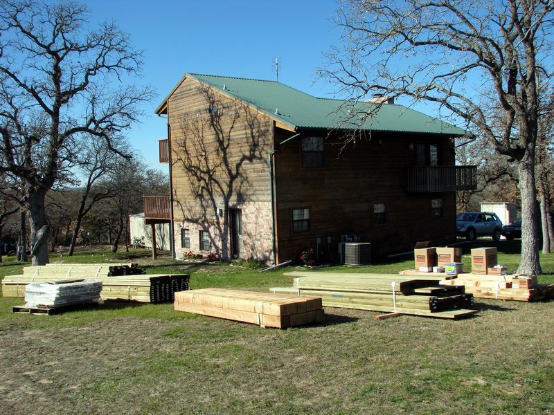

Uh. . . Some assembly required.:rolleyes:
The crew was supposed to be here today to start, but because of Thanksgiving being tomorrow, they want to wait until Monday. I don't blame them. Thanksgiving and the days around it should be spent relaxing and enjoying family and football.
Say what you want about box stores, but Lowes gave me a 20% discount on materials and delivered them exactly on time as promised. I will let them know how pleased I am and that they can expect more business from me.

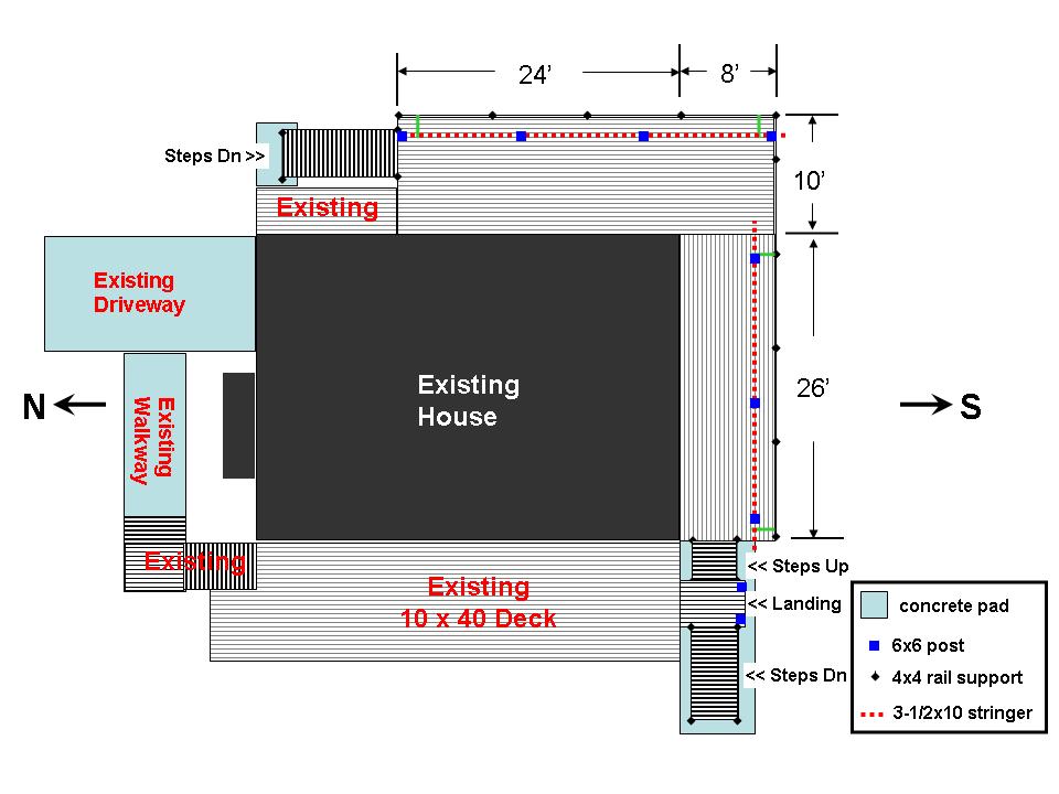

My sketch of a top view of the deck shows that we will have decks on three sides of our house when completed. I'm excited. I've wanted this for many years. I'll post more pictures next week as the deck is completed. The contractor told me to expect two days work and one day for final finish-up with a partial crew.
I created the BOM and ordered all materials. The crew will show up and build using my existing deck as a go-by with only slight modifications that I want done differently. I've calculated fasteners, Simpson brackets, flashings, and all dimensional lumber. I'm a bit anxious about all that, but I think every thing needed is here.

Nothing like seeing bundled wood ready to go. 20% !!! nice bonus
2 questions..
1. Is it covered by your homeowners insurance sitting there??
2. Will you be home or going outa town?? ...:D

2 questions..
Yes we're going out of town, but we'll leave our attack kitties to protect it.;):D

Nice to hear Lowe's is giving discounts. I wonder if it's a local thing, or if they are becomeing more contractor friendly. I've received discounts when buying from them, but it's hit or miss, and nowhere near 20%!!!!
On you diagram, when you say stringer, is that going to be a header type beam with two dimensional pieces of lumber and plywood between them? or a gluelam type beam? The 3 1/2 inch width has me confused. The run is short enogh that a gluelam would work, but it would have to be protected, or treated to withstand the elements.
I'm also curious about yoru post placement at the corner of the building, where the two new decks come together. It sort of looks like you have extneded the support beam past the post and cantelevered it out to where you will have to run your suports for the outside corner of the deck. If that post was lined up with the outside edge of the house, then you would have direct support for that beam and joists. If you can eliminate a cantelevered attachement for a main, load bearing beam, I would sure do so.
