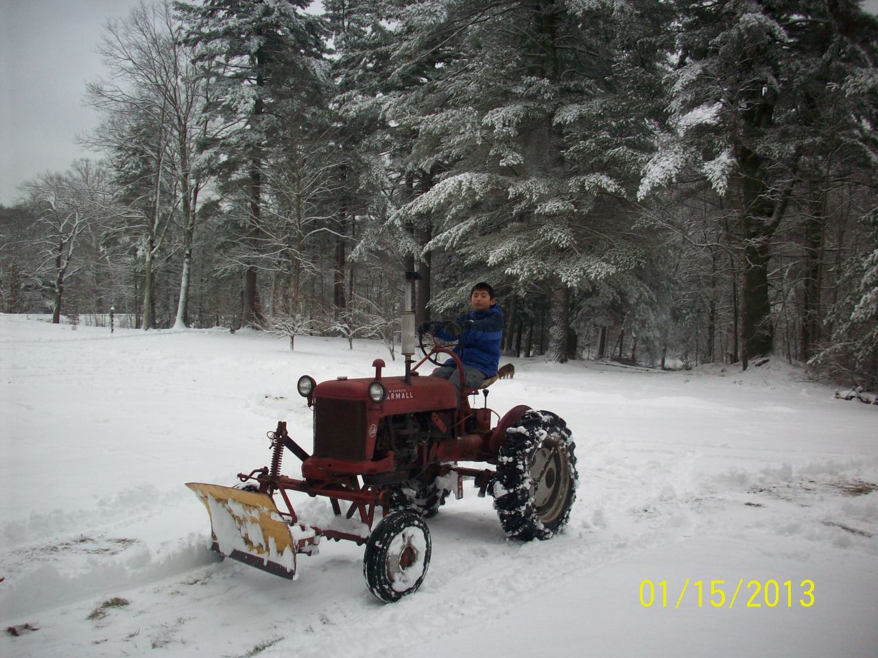

100_1831.JPGthis is how we roll in CT
   / Pictures of your snow weapons #1,543
<img src="http://www.tractorbynet.com/forums/attachment.php?attachmentid=300083"/>this is how we roll in CT
Great cub always fun even in the snow.

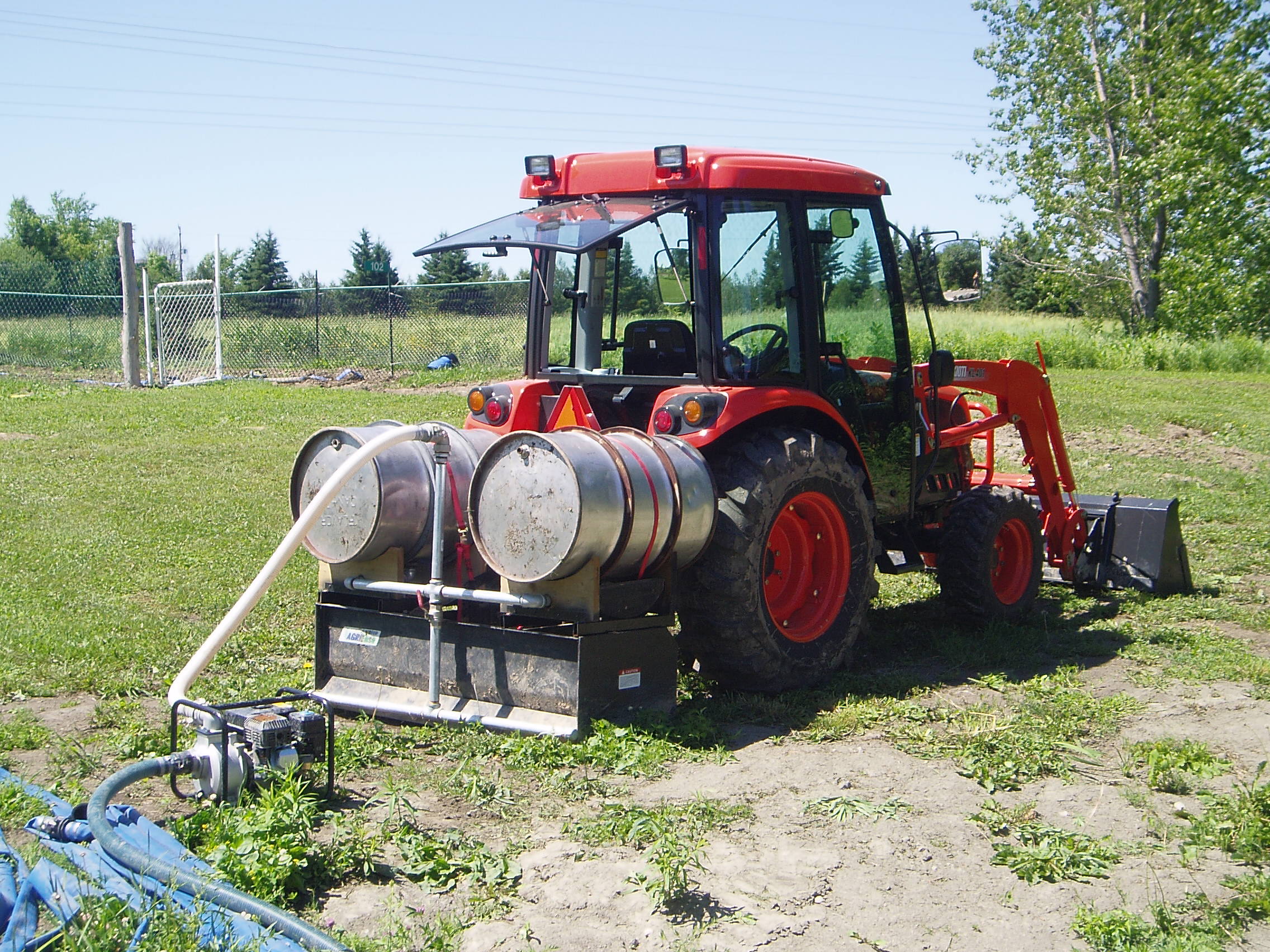

Getting a little in Ottawa. I took the zamboni off last night and put the blower back on to get ready, but looking out the window, that might have been optimistic.
Zamboni? Is that some sort of 3-pt attachment??? Photos?
   / Pictures of your snow weapons #1,549
Sure, I guess it's on topic, more of an ice weapon. This is last years version but it is improved every year. This year I took the rear blade off the box blade and sharpened the front blade on the bench grinder. I installed nylon runners on the sides to adjust the bite that the blade takes. The biggest change for this year is trying to get hot water. I have the wood stove we just replaced at the cottage, so I fastened it to a pallet, installed one 3' length of stove pipe and built a heat exchanger that slides into it out of 40' of copper pipe. I have a pump that draws water out of one tank, through the heat exchanger and returns it to the other tank. Since the two tanks are connected, the water simply circulates. My first try was last weekend and the circulation pump my friend gave me didn't work, although I did manage to make some steem. I just bought a self priming transfer pump, so I'll give it a go after tomorrows melt down (calling for +10 - 12 C).
