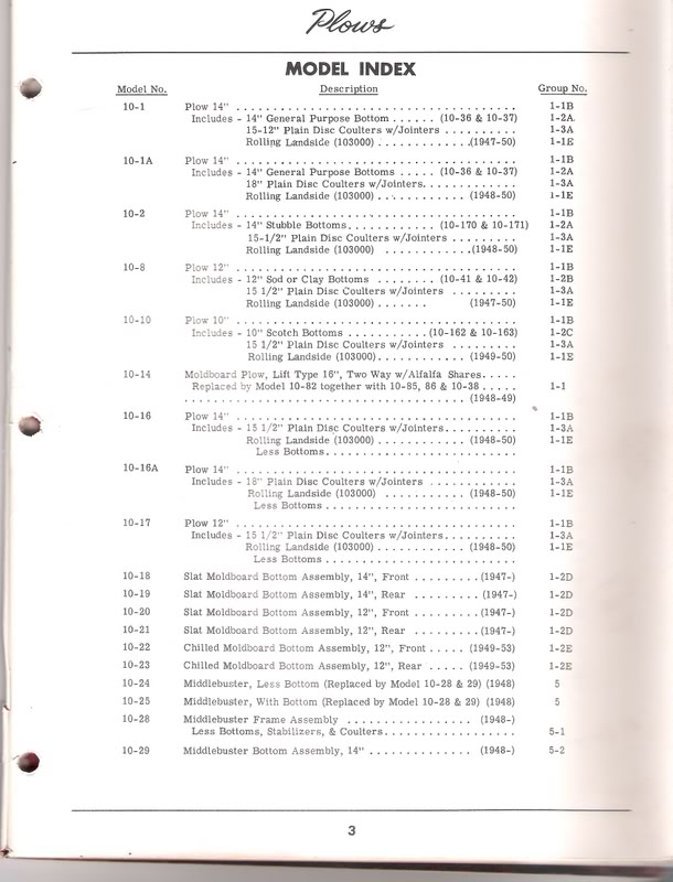

WHAT THE DIFFERANCE BETWEEN A 10-1 AN A 10-2 PLOW?

as far as my understanding goes, the 10 part refers to the size of furrow it turns (eg it would turn a 10" wide furrow) and the -1 or -2 refers to the number of bottoms (eg a 10-2 would turn 2- 10" furrows).

NOT the case in this case. I've seen plenty of 10-1 and 10-2 plows with 12", 14", and 16" bottoms, and NEVER seen a 10" Ford plow.

Jim,
I did a search and found this info. It isn't much but it may be a start.
