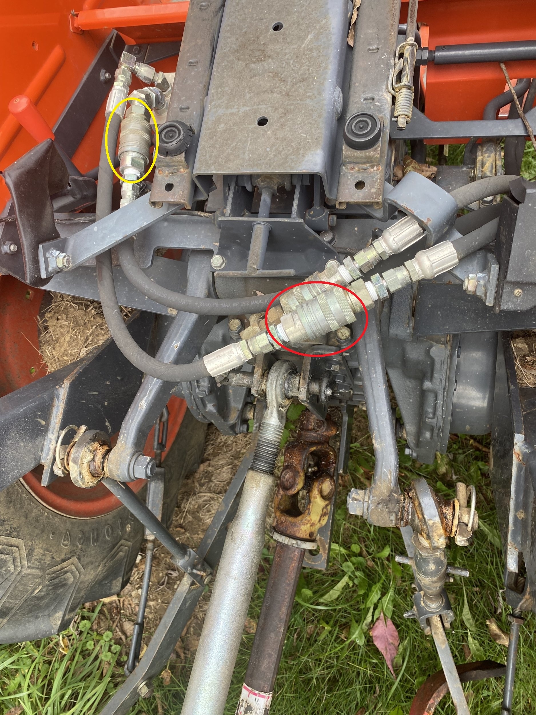

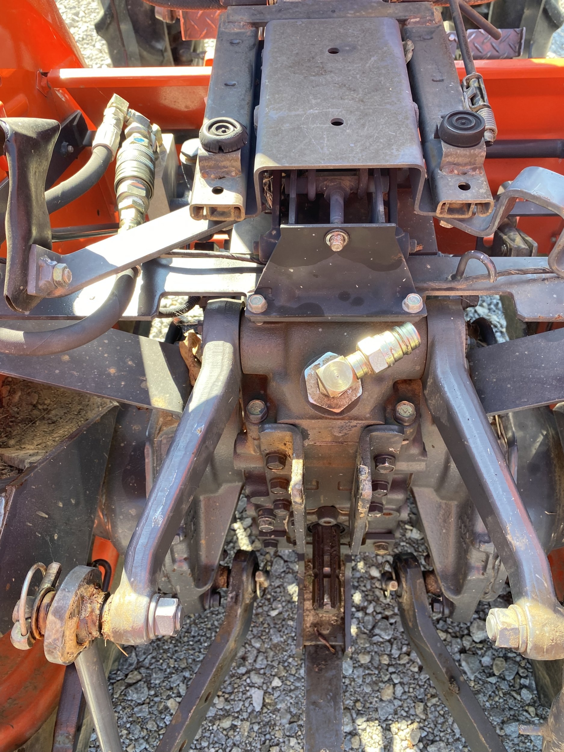

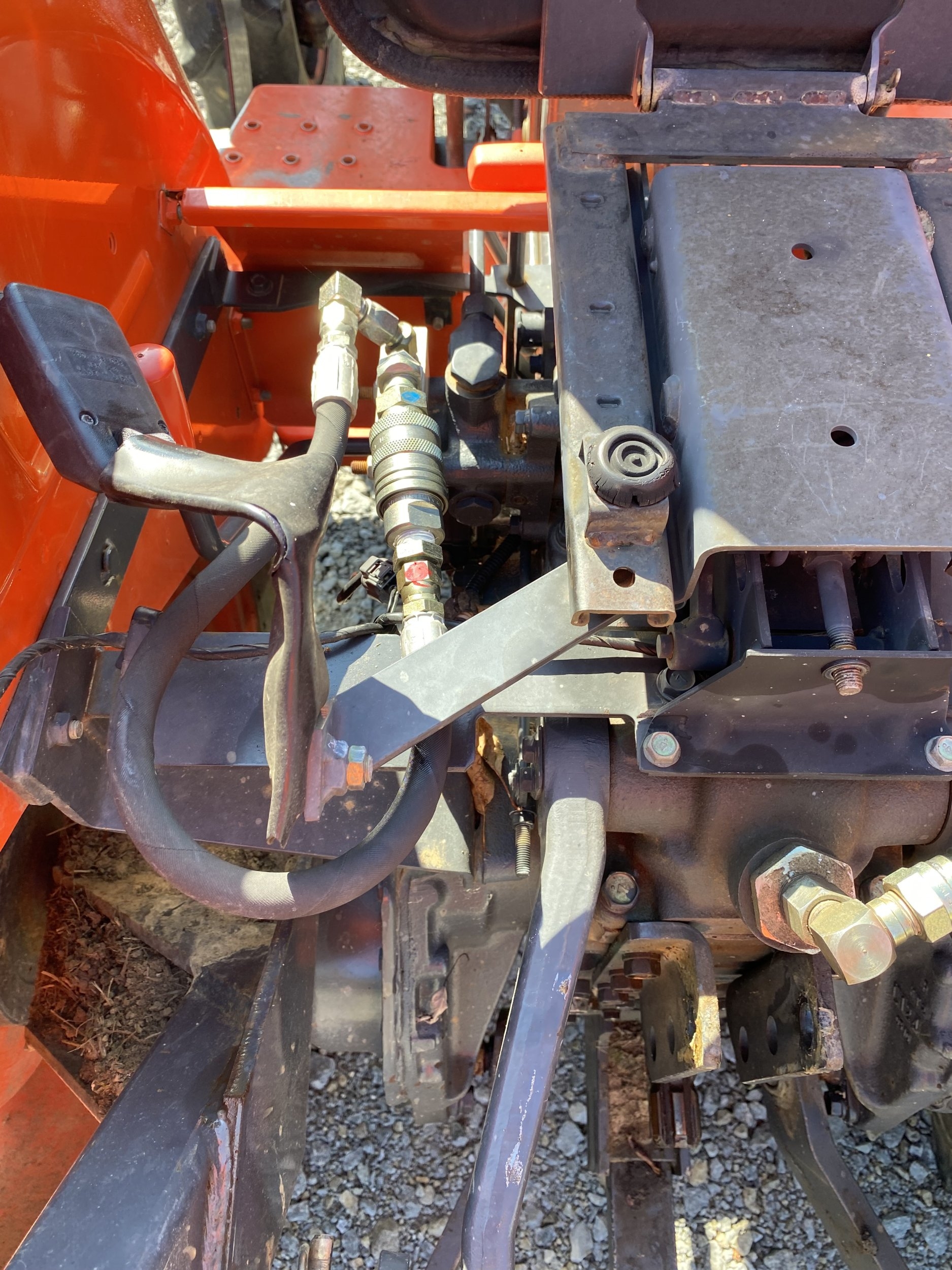

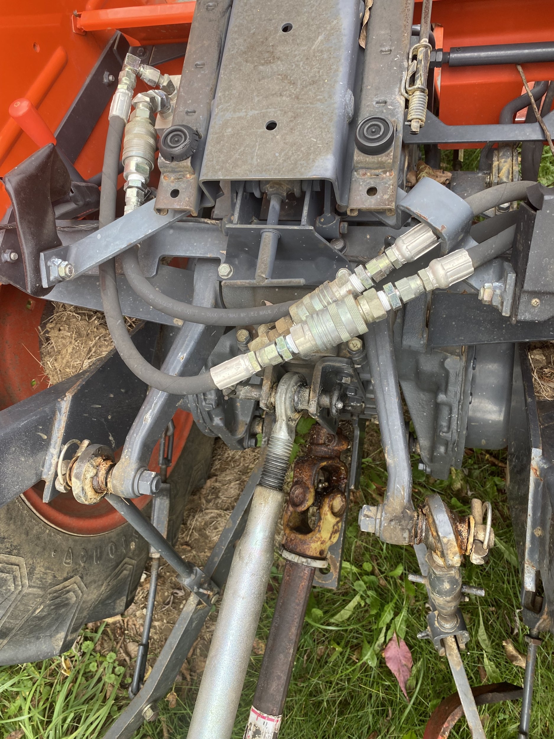

I’m removing the Bush Hog 2246 from my Kubota L3000dt. In the Bush Hog manual it says “when loader hydraulics are disconnected from tractor the tractor hydraulic circuit must be completed. Failure to do so will result in hydraulic pump damage.” When I connected one of the pressure lines to the return line, completing the circuit, the three point hitch did not raise. I can only assume that the pressure is completely dumping. Does anyone have any experience with this process?
