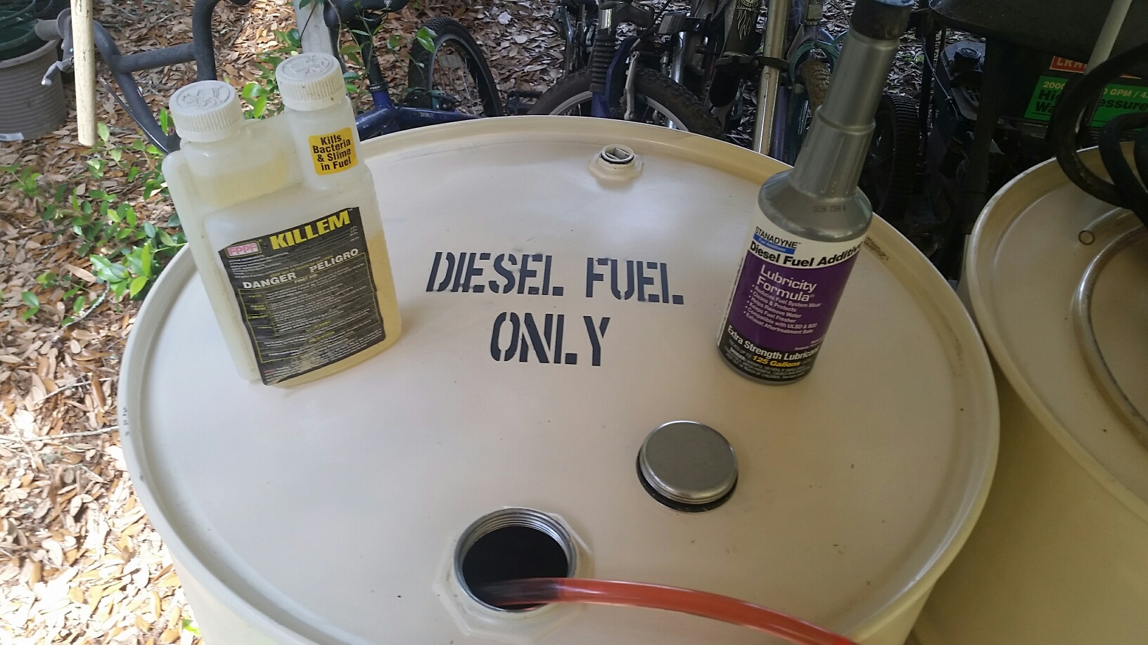

I thought I would do an update on this. I decided to leave the bungs loose to allow fuel to expand and contract. Drums were filled January 2nd. I pulled about 30 gallons out of one a couple of months ago. Emptied it today and took a few gallons out of the other drum. Before I started today I took a sample off the bottom of both drums and have no water or sludge. When drums were filled I added an once of Killem Biocide in each one and half a bottle of Stanadyne lubricity formula.

A common problem with diesel powered boats is condensation in the tanks that leads to algae buildup. I had that problem on my sailboat with two 50 gallon tanks that were always vented.
Out in the high desert with lower humidity, it might not be as much of a problem. I have two 300 gallon fuel tanks for my oil boiler that show no signs of any water or algae after just two years of sitting with open vents.
I also have six 55 gallon drums full of stored fuel for heating later. They are all tightly sealed. No problem with them either. They will build up some pressure but they are designed to deal with it. A nice idea is to paint them white or keep them out of the sun, but it's not necessary.
One other problem is if they are upright and collect water around the bungs, where the tank seal can be higher than the bung opening. Or have melting snow sitting on them. Be sure to have them absolutely tight and sealed or the water will get in when they cool. I used steel bungs and wrapped teflon tape over the top of the o-rings before I installed them.
