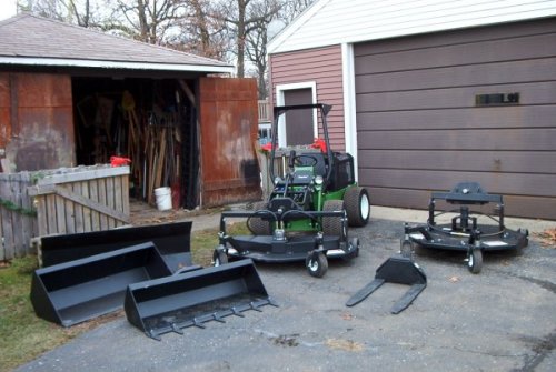

My tractor tires are 42" outside edge to outside edge. I have a 60" mower. I like having the mower wider than the tractor as others have mentioned is a lot easier to get next to the fence and buildings.
It should be noted that my mower is out front on my FEL arms, and not behind the tractor, but the principle of getting close to stuff with the mower is similar.
Also as mentioned, the wider the mower, the more likely the scalping on uneven terrain, unless the deck articulates.
