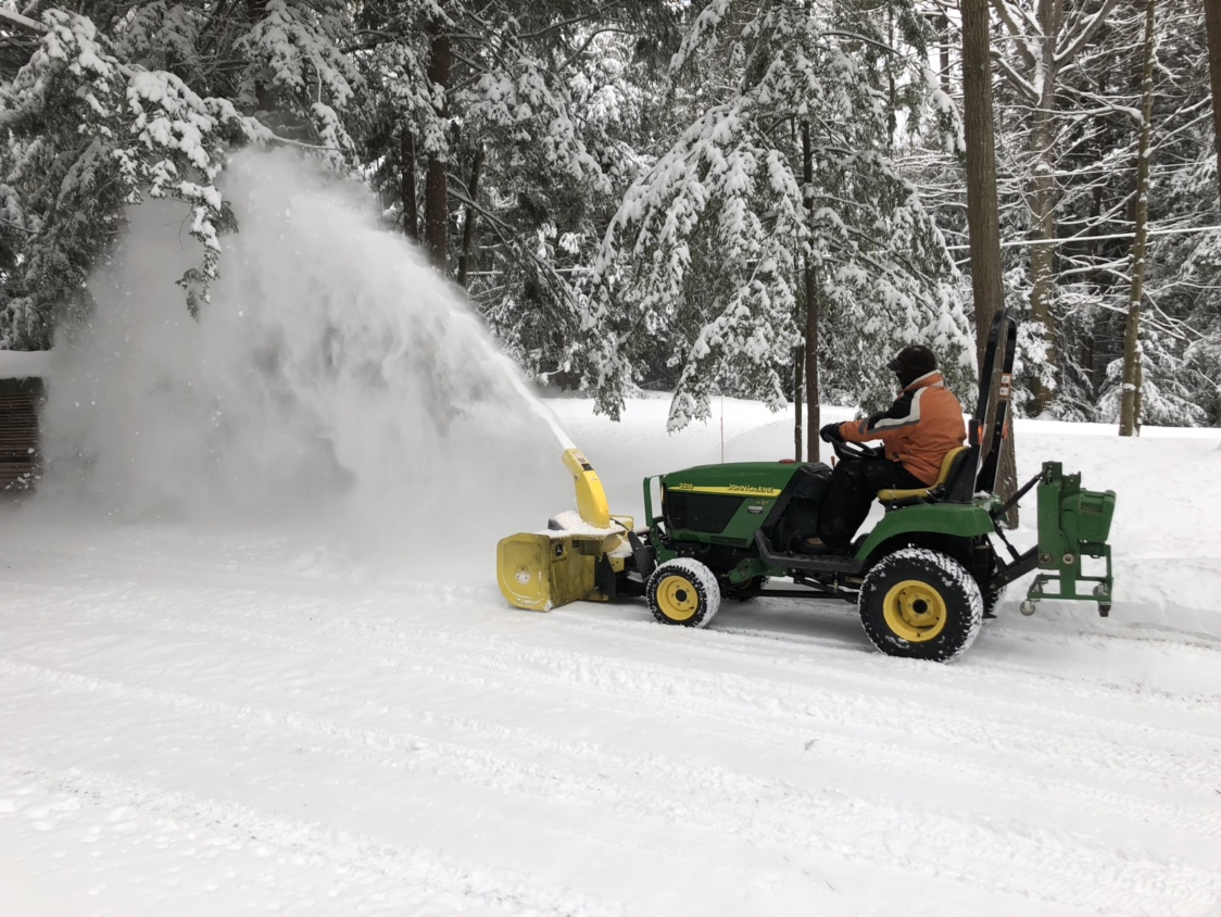

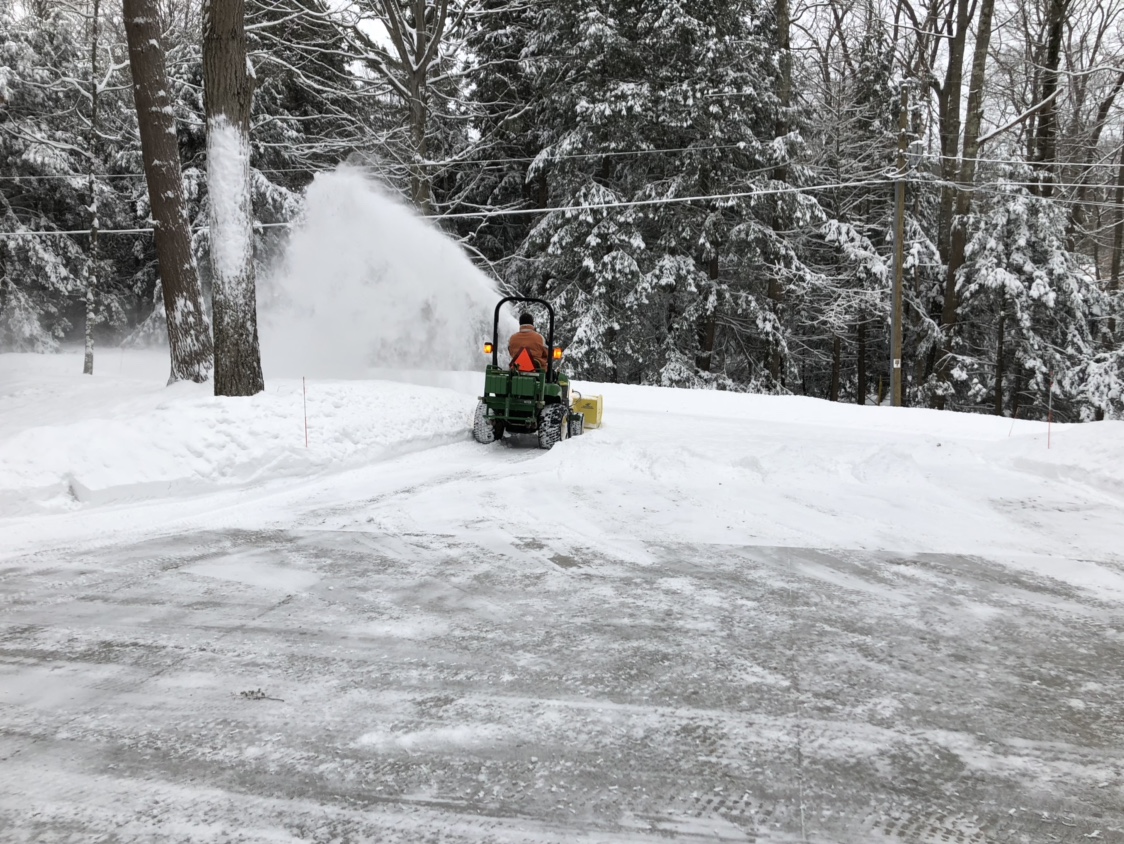

All I use for my CUT.

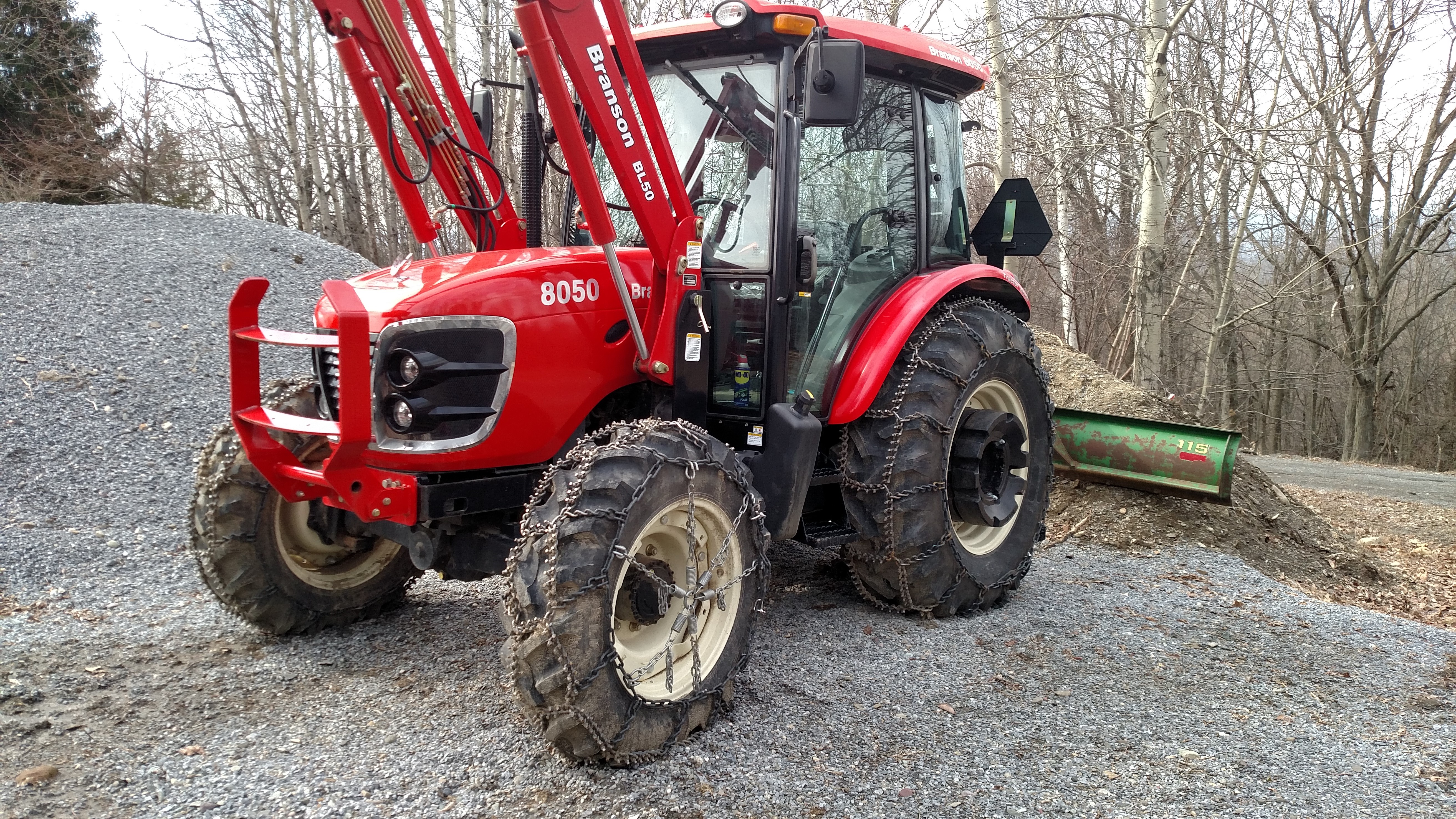

Now if you use these on the front you can get a lot of traction in snow or frozen ground, more then summer at times.
