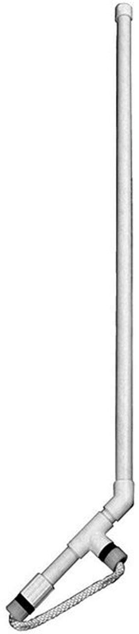

I use this for olive stumps. RM-43 is glypho with imazapyr to discourage regrowth.
