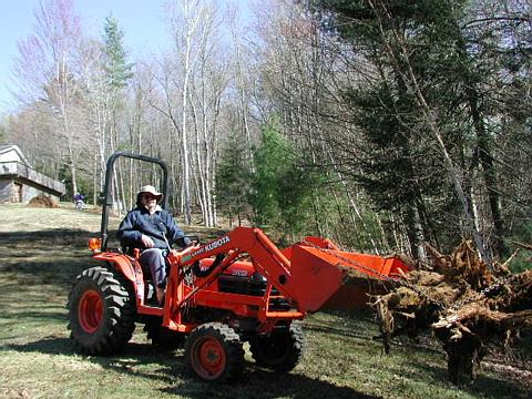

Here is a picture of a stump I dug out with my FEL. It took some digging and some time, but out it came. I just installed a tooth bar and am anxious to try it on another stump.

Wow, that's a heck of a stump for an FEL! Do you approach it from different angles till it comes out or..?
