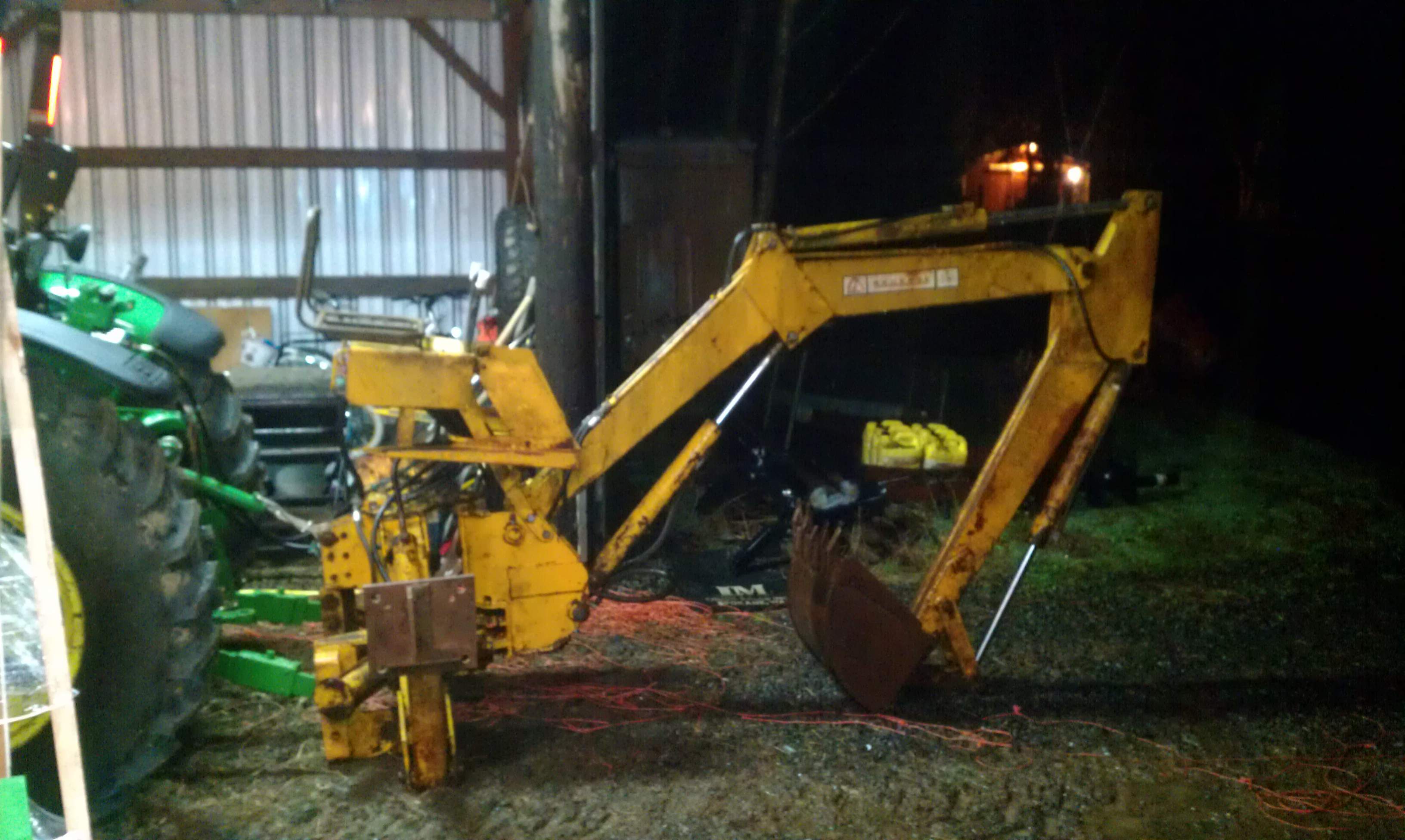

Here's the Talley:
Used ARPS 730 $2200 and bought less than 10 miles from home.
Replace Gresen valve section, add PBY, new o-rings, etc about $200 at Baum Hydraulics.
Stabilizer cylinders and fittings from Surplus Center were another $200. Probably another $250 in other hoses fittings, welding rods, pins, fasteners etc. The steel was nearly free, at most $.06/lb scrap price.
Still well under $3000 for the whole shebang. I didn't keep track of my time. I started on the subframe arount May 1st.
The dig depth is supposed to be 9-1/2 feet. It's about all the backhoe I want on my tractor.
   / Subframe for ARPS 730 backhoe #12
You have done a great job of mounting your BH to your tractor and have also sent an excellent lot of pictures in regard to it.
Is the swing angle 180 Degrees?

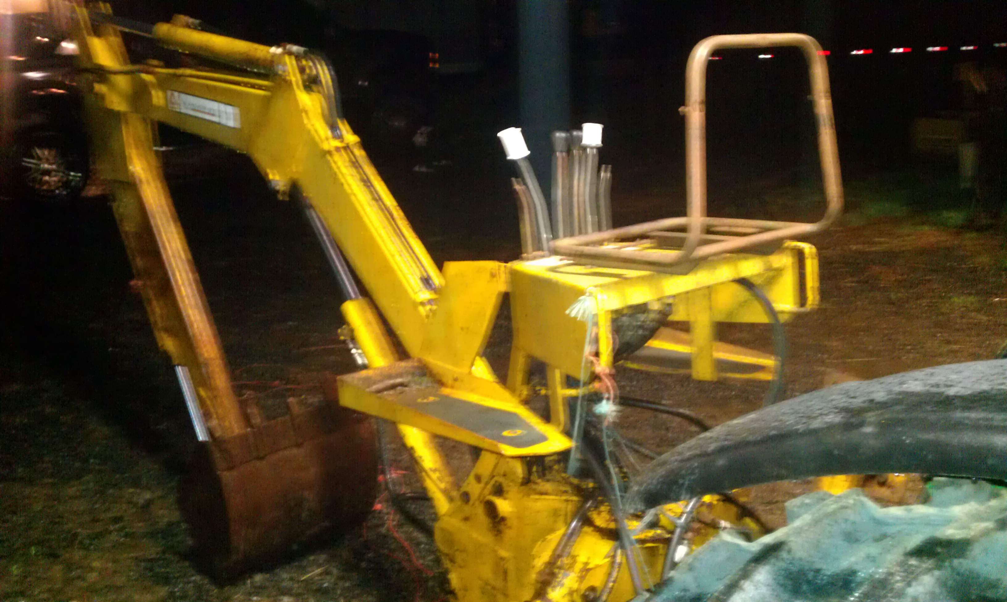

RW - Thanks for the kind words. Yes ,the swing is 180 degrees. It uses a pair of single acting cylinders to pull a pair of large chains that drive the swing. This design was common to several of the ARPS models.
irwin - Thanks - Yeah, it's good to have this one knocked out. Who would've thunk just mounting the thing would be such a project? I really have to applaud the guys on here who build the whole thing from scratch.

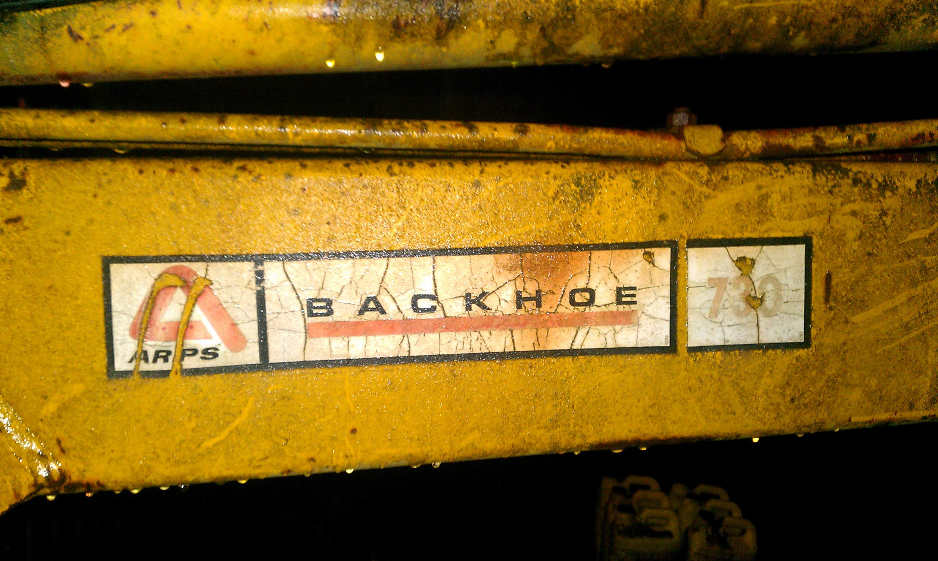

TTN -You have the same one? Mine has a name tag visible in the left picture on the horizontal plate just to the right of the swing bumper.
I think it's a pretty neat design, especially considering the vintage. It has the bent boom and I don't think I've seen any other units with the seat that swings with the boom. (I did learn that riding with the boom provides extra incentive for smooth operation.)
Mine has signs of age but not wear. I'm guessing that with the manual stabilizers it wasn't originally bought by someone who dug for a living. Let me know where (if) your's is showing wear and tear so I can keep an eye on mine. My tractor is a Kama KM554 (55hp Chinese). 3RRL has the same model. To use the 3-point mount I think a bigger tractor would be better.

Hey Brad havent done anything on my backhoe yet. I had sold it 2 times but the folks that bought it both times said its too heavy for their tractors. What it is it has a Deere type quick hitch some one put on it and the 10 or so inches it runs out puts it too far back for alot of tractors. I was looking at it after I read this thread again and found a faded logo with 740 as the number. I havew thought of building a pontoon for it and sell it to a dock building company for light dredging in ponds. This is a straight old machine otherthan the 2 cylinders and the last person that had it bent the seat mount unloading it here after I bought it back.
Interesting hoe, BRAD, and good job with the subframe. I missed your
earlier posts and I try to read all hoe threads if I can.
I have not seen any hoe that takes the operator for a ride like yours does.
From your pix, I also see that there seems to be a shock absorber spring
to limit the shock at the end of the boom swing. I have not seen that
type of link chain in that size for swing action, either.
