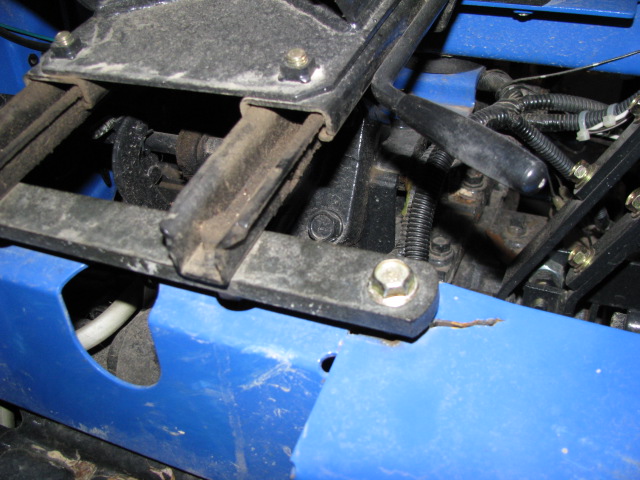

I broke the seat where it mounts in the front. Has anybody else had this problem? The dealer of course is going to fix it under warranty. Being 6'3" and 230 to 235 lbs. I guess I lean back more than I thought. Anyways, you guys out there with TC24DAs' check your seat bracket mounting points for stress/possible failure.

First I've heard of this. The TC18, TC21 and TC24 all share the same seat. Owners of all 3 might want to double check.

I seem to recall Lageorge having the sheet metal break on his first "problem" TC-24 and checking mine when it was delivered. It is a weak link in the seat system. My pivot bolts where the seat tilts forward are constantly coming loose, and I notice when I check them after tightening, the sheet metal flexes very easily. It is only a matter of time before it will fatigue and break, especially given the design of the seat with the spring suspension. I'm a fairly small guy (165lbs) and I still worry about it. There isn't even much metal to work with if you needed to weld it.

Well, I can add my name to the list of those with the broken seat mount. I had one side on mine break this weekend, so I pulled the panel. The other side was well on its way. I will contact New Holland and let them know what happened, as well as my dealer. I don't think my tractor is under warranty anymore, but maybe they will cover it. It looks like that sheet metal piece that breaks is now up to $350, so if no warranty coverage or recall, I will use what I have and overbuild it.

I've got the same cracks on my TC18, but I haven't done anything about them yet since I discovered them last year, other than losing 75 pounds (but that wasn't because of the seat issue).
I'll look at building some sort of brackets as a repair eventually when I get around to it but it hasn't caused any downtime for me yet and I've got some other more important things occupying my time lately...
