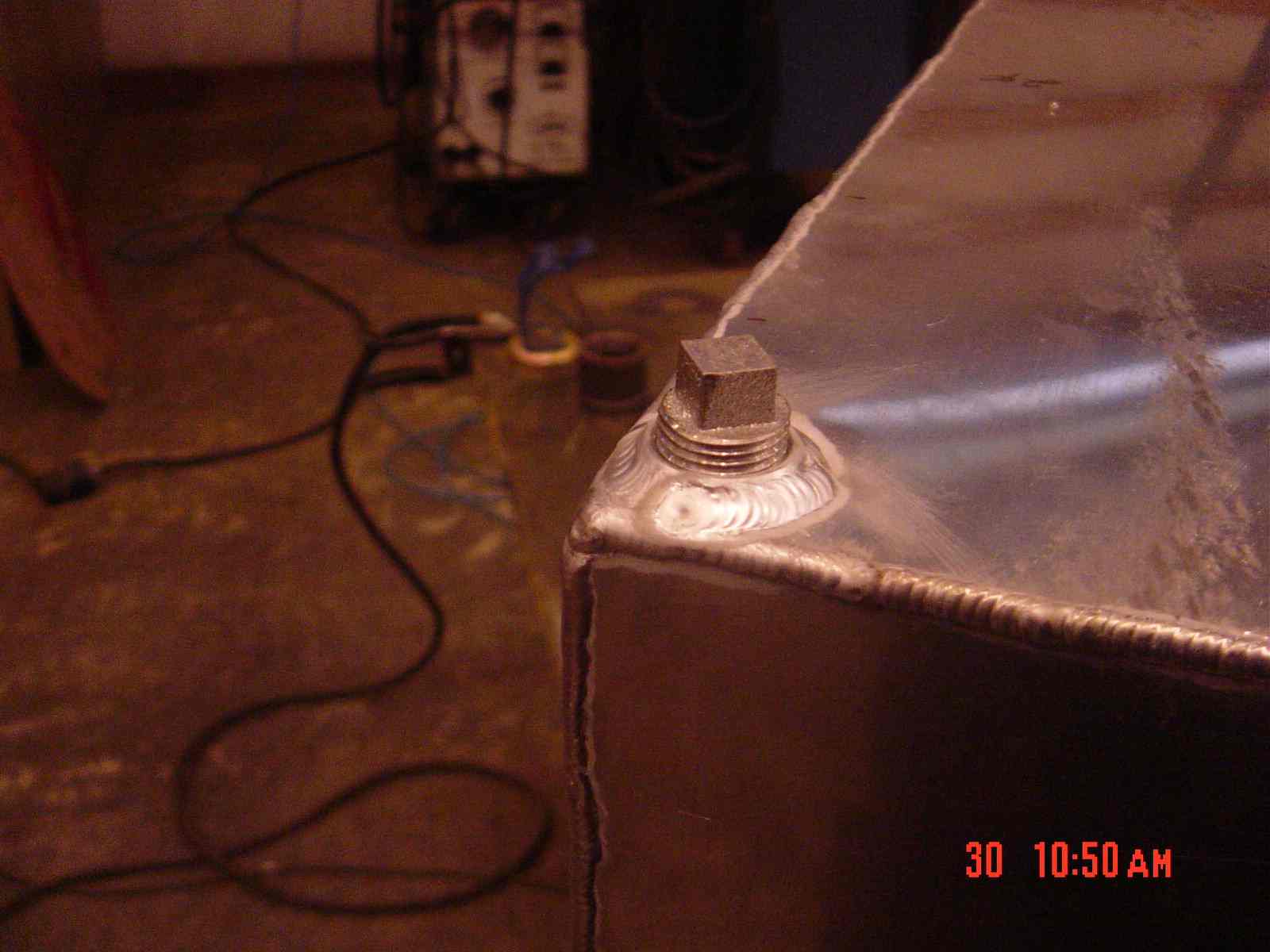

can you stack dimes on a flat surface? Aluminum is harder than steel, it does not fusion weld like steel.

I can not yet stack dimes on aluminum. Should I be in AC or DC with the green electrode. I know my gas cfm is good
   / TIG welding aluminum #14

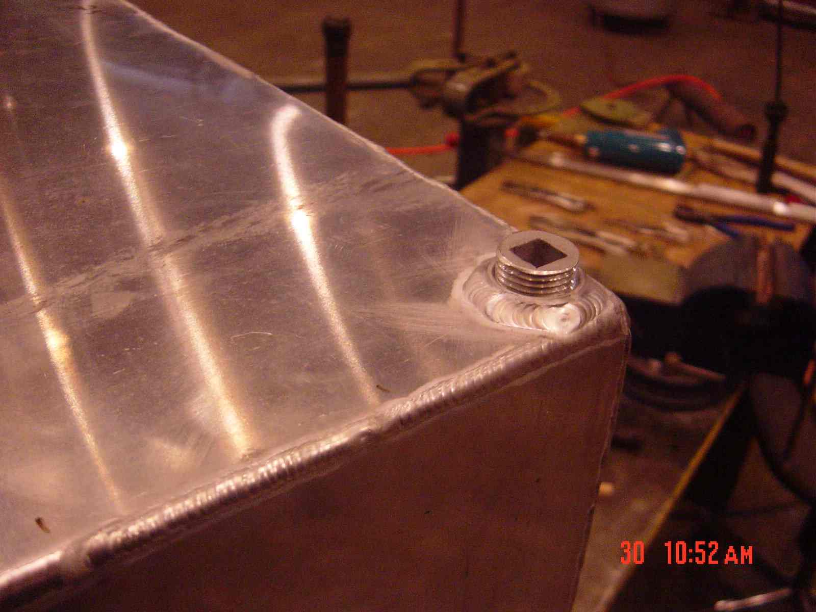

You need to be in AC with high frequency turned on. The photo shows that you have some contamination. Are you using high frequency? The photo doesnt look like it, it should hear and feel the vibratory effect of the high freq. unit working, this aids in the fusion process.
THe black sooty stuff is contamination and will keep your metal from adhereing. If you strike an arc and get that black soot, it isnt clean enough. Use a stainless steel brush to clean the metal and then wipe it down with Acetone. Dont forget to clean your rods also. Then dont touch them with your bare hands, use a pair of clean cotton gloves so you dont get oil from your skin on the rod or plate. Use a large cup size 10 or more and tungsten stick out should be about 1/8". I think you said you had the balled end so I assume that you know how to do that by setting your machine like you are going to stick rod and striking an arc with your tig rig. The ball needs to be perfectly round on the end and not off centered or you will get some erratic arcing.

I weld aluminum as a profession.
Follow the guidelines with your Miller machine.
As a base use 190-200 and pedal the amperage to get the base material to puddle FIRST. This should be around 150-175 for non-anodized aluminum plate. THEN add rod to the front of the puddle and work it into the base metal by moving back to the previous "button" on the weld bead and then forward before adding rod once again. Repeat.
Your picture shows a lack of shielding gas coverage: Check you distance from the cup to the base metal AND the CFM of the ARGON gas. It should be 15 or so. IF you're welding outside of a sheltered area with a breeze blowing this WILL greatly affect the shielding gas' ability to cover your weld.
The base metal alloy is a big factor in the choice of filler rod. However as stated by one of the other posters, I would guess that it is a 5xxx alloy.
Either 4043 orm 5356 rod will work.
Stick out, the measure of distance your electrode is past the front edge of the cup, plays an important role as well. while your learning ( and even after) keep the electrode even with the front edge of the cup or no more then an 1/8th of an inch out.
Rob: I don't mean to give you a hard time, but you might want to find a local welding shop to do this. Your question of AC/DC for aluminum is more than basic, and frankly indicates you probably have not done a lot of TIG... TIG takes a bit more practice and know how than MIG, the welder at a local shop who does it 8 hrs a day and charges probably 40 bucks an hour will make that look great in no time, plus I suspect it will cost under 50 bucks..
It almost looks like you are on DC????
