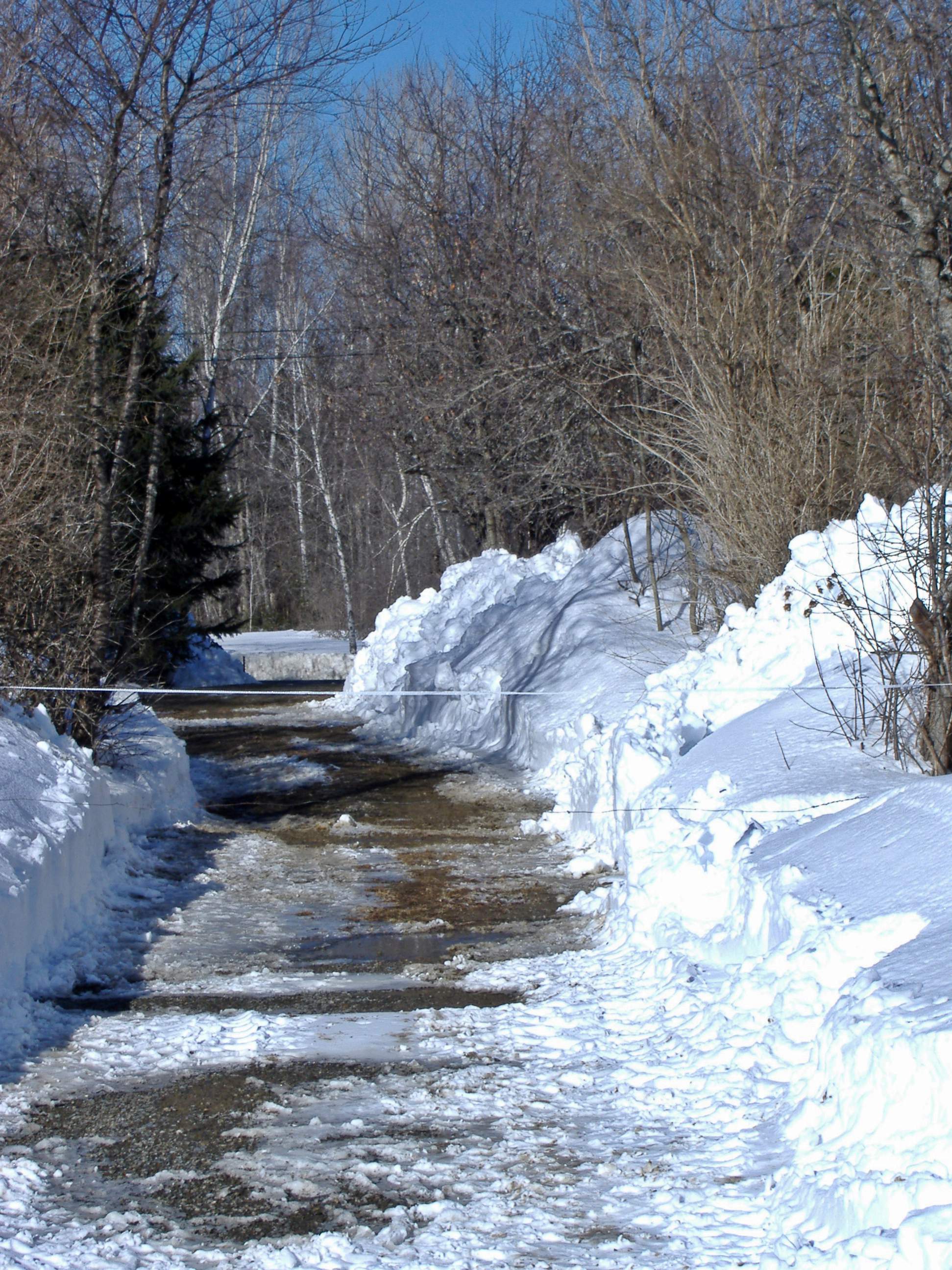

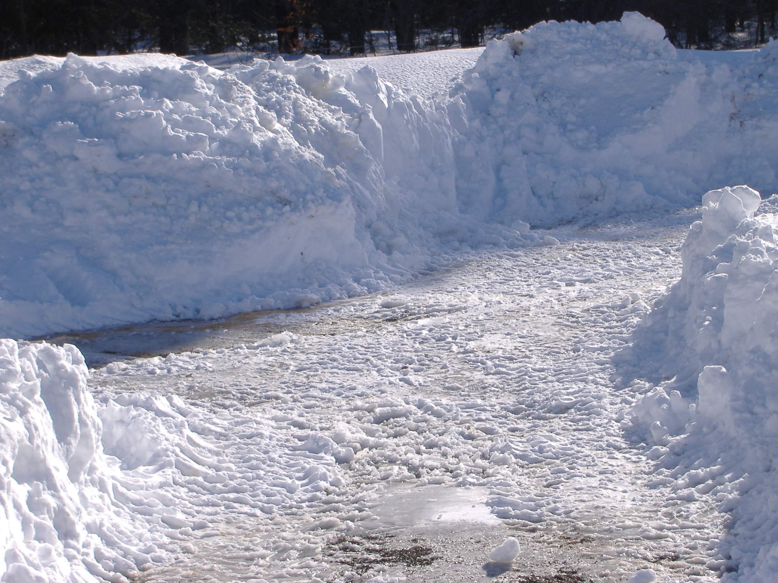

A rear blower will be your best friend.
Pushing with blade or bucket will very soon have you running out of space plus traction becomes a problem.
You have 'lake effect' which matches to some extent our snow events north of Montreal so I know a bit about what you face.
Bite the bullet and get a PTO blower and you'll never regret it.
OK frt mount sounds nice but rear is much more affordable plus there are many more deals to be had.
Rear are generic while front are model specific.
Shop around for used if the budget is tight just be sure that it is a bit wider than your wheels.
If you do go used rest assured that just about all repair and maintenance parts are generic 'off the shelf' at most machine shops or bearing suppliers.
A decent used rear blower might just match the costs of wheel ballast and chains making the outlay of $$ a bit less painful.
I might add that pushing loads of snow can even shred the best of costly chains.
