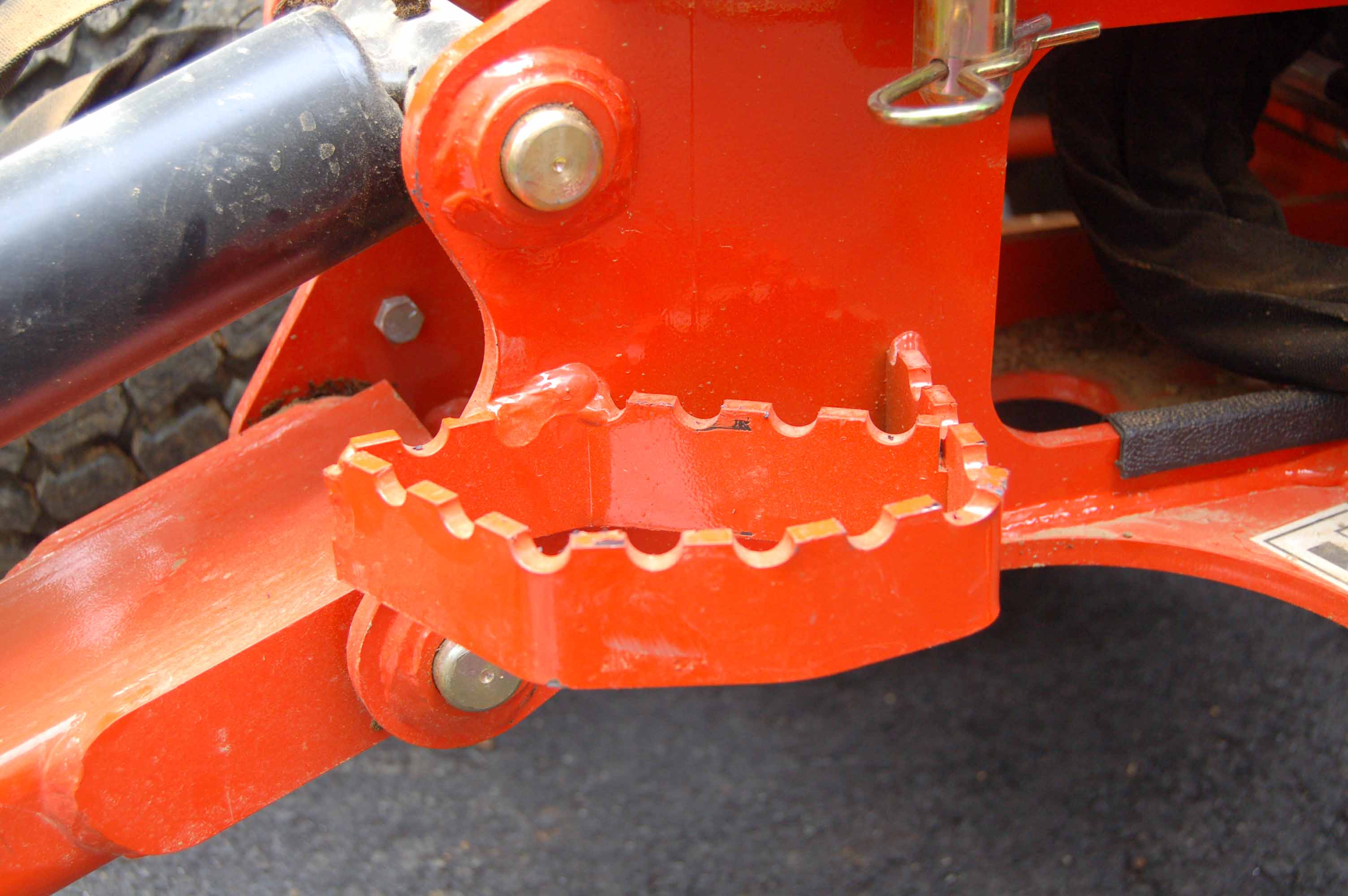

I hated that I had to give up the ability to tow a trailer unless I removed my BH. I use my trailer too darn much.

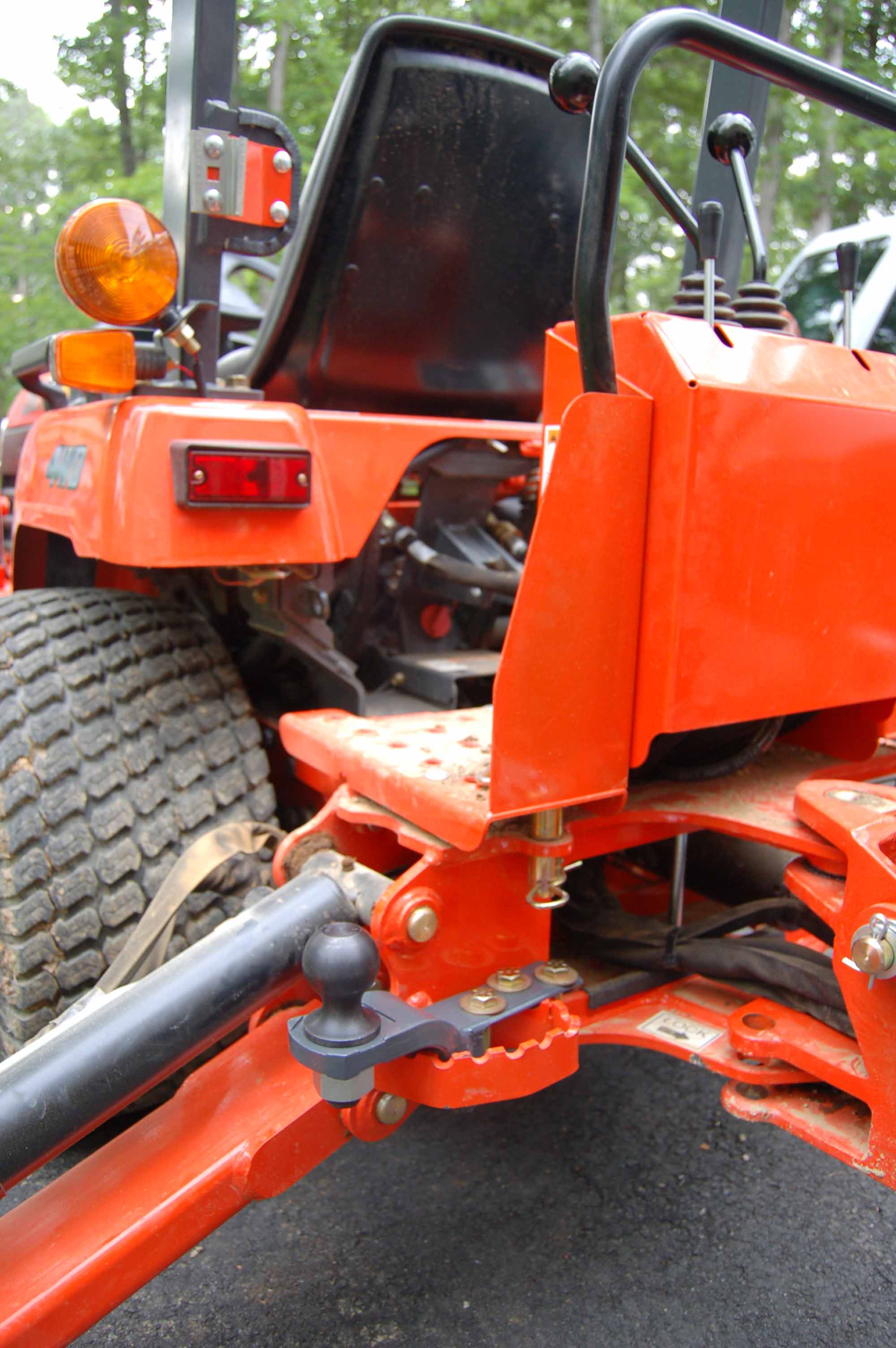

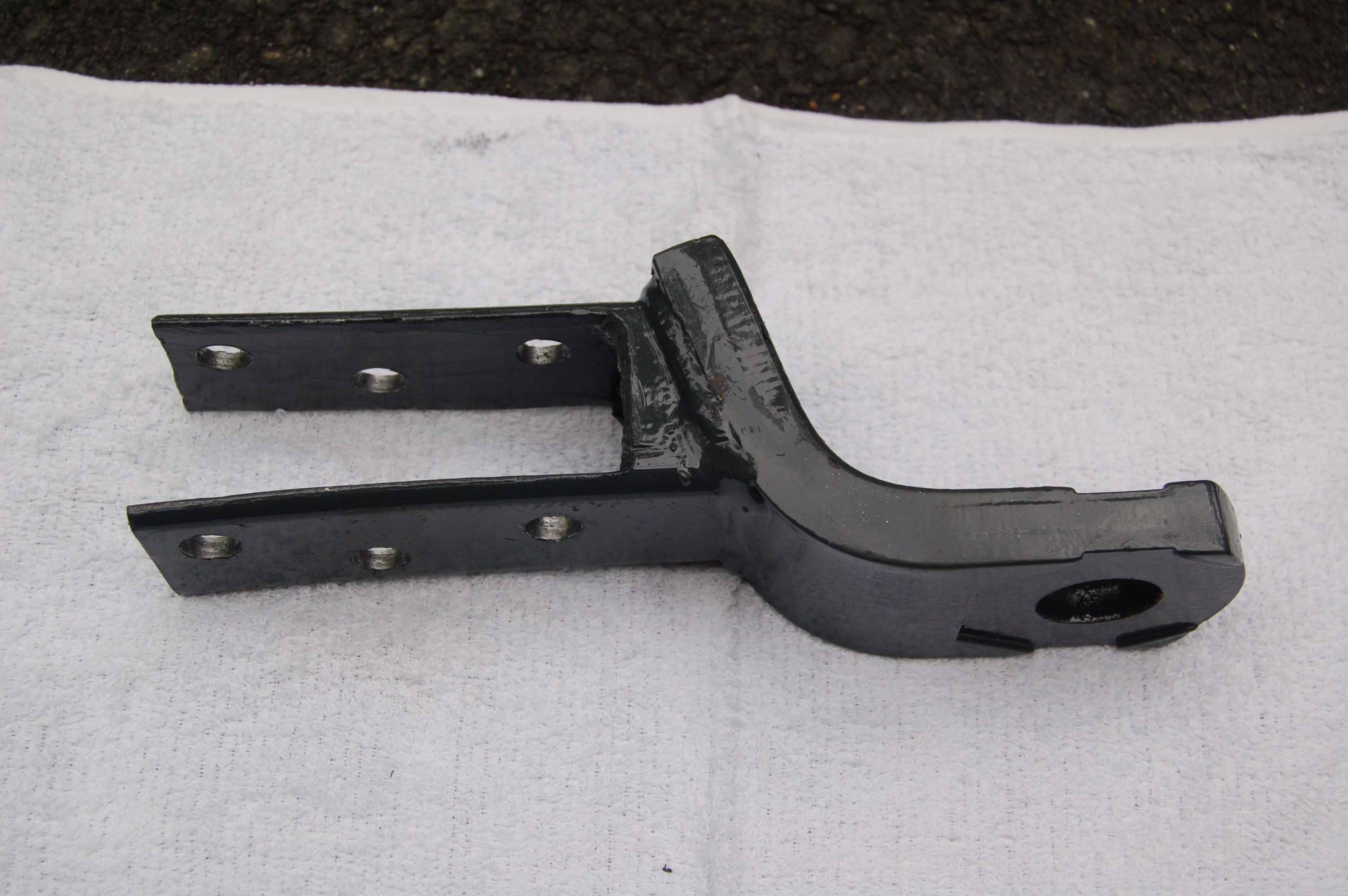

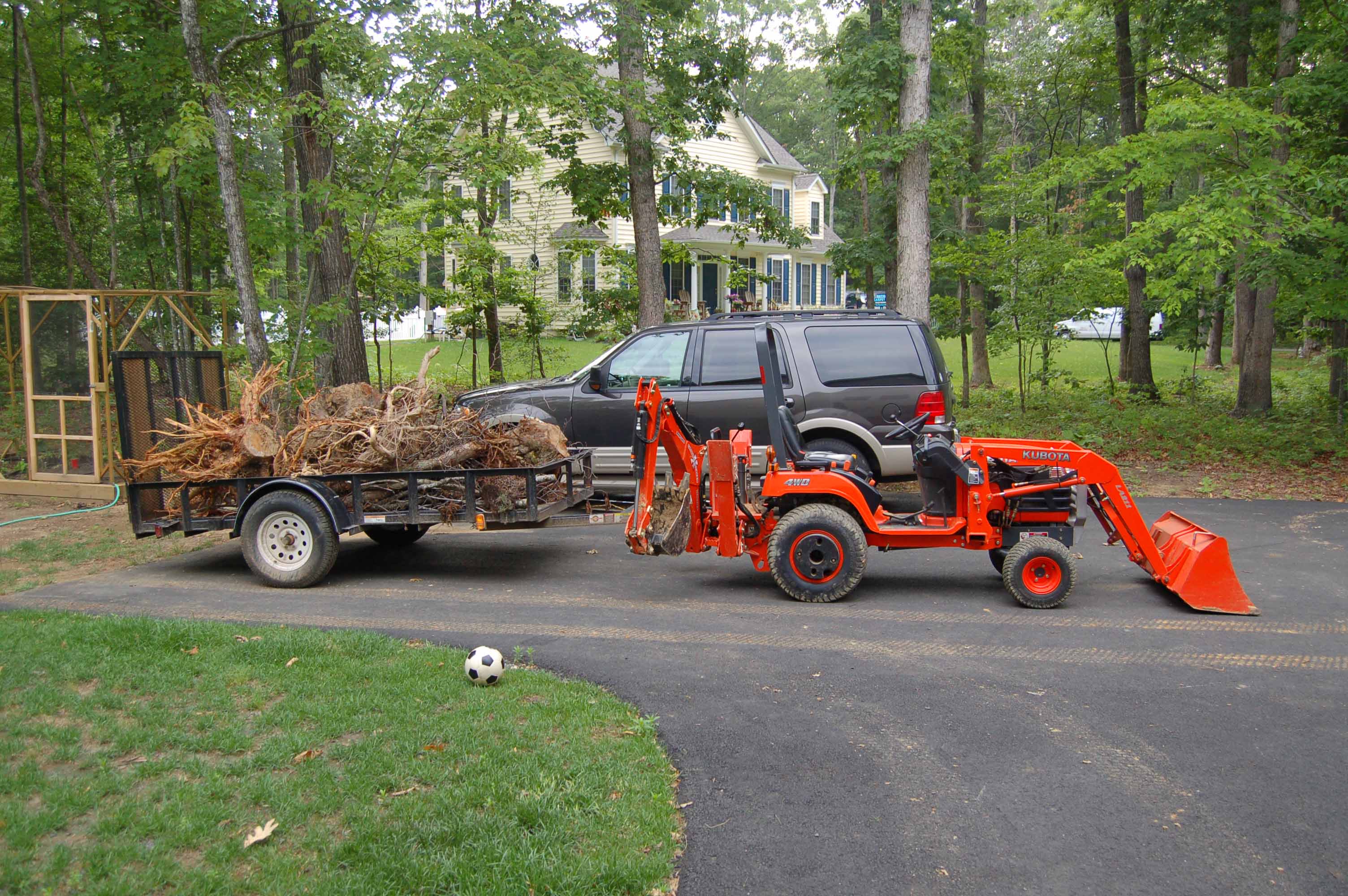

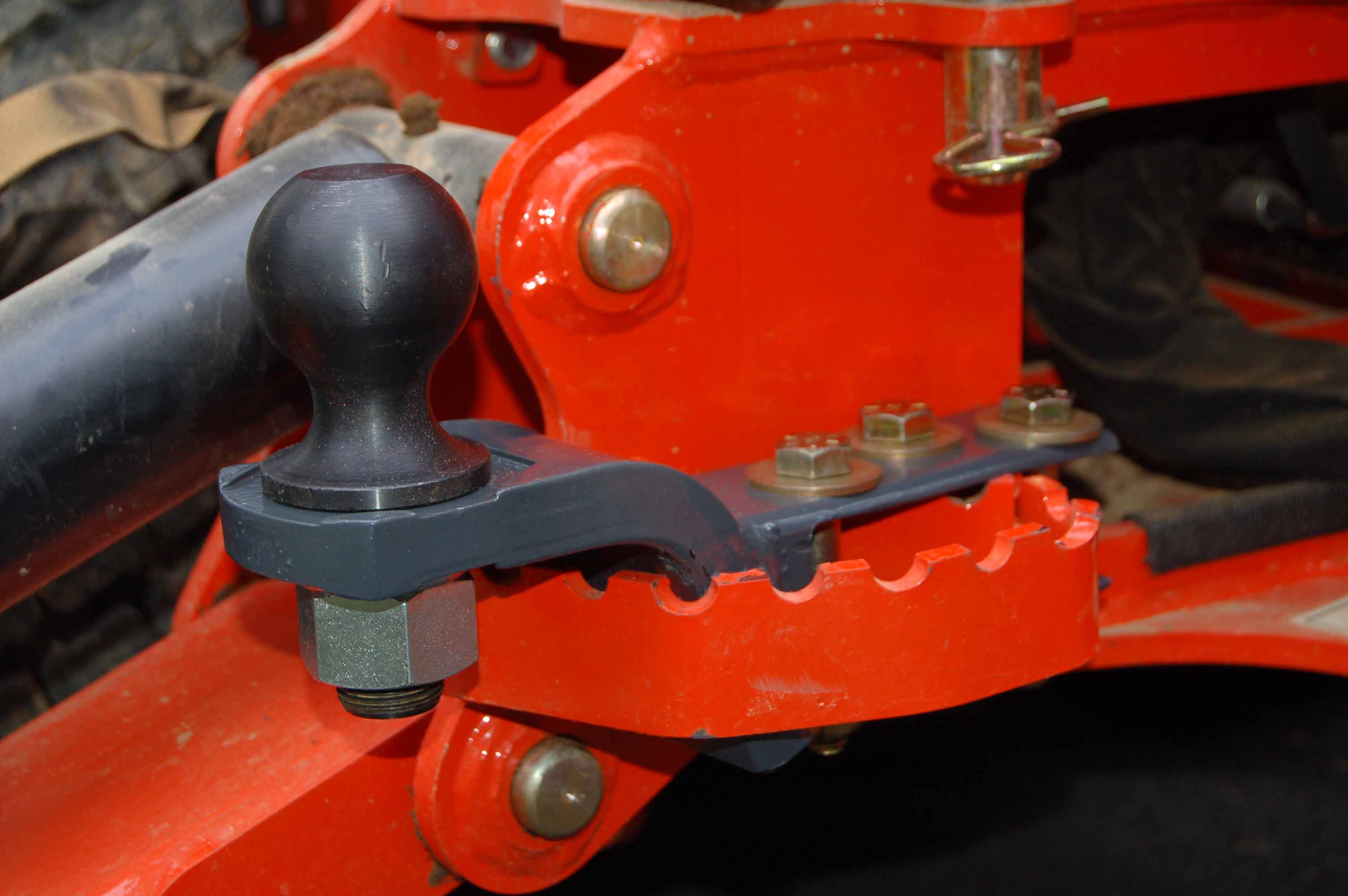

I came up with a nice way of mounting a modified reciever hitch draw-bar into the steps at the back of the BH6000 so I could tow a trailer. Not that I would try to pull a sailboat with it or anything, but it certainly lets me move the trailer around with a fairly hefty load (as evidenced by picture). The ball is fairly close to the machine and is quite stable.
Not much worry of the step bending with as close as I've mounted it...not a huge moment there and the step is thick and repeatedly welded. The tongue of the draw-bar actually rests on the step, so there is lots of support on all ends of the assembly.
When in use, I swing the BH boom all the way to the right side of the machine...right hand turns are a little limited by the trailer hitting the bucket/dipperstick, but I get around just fine.
It took about 30 minutes of grinding the draw-bar to make the slots, then I cut to length. The bolts are simply 1/2" Grade 8 tightened as much as possible.
Not the most elegant thing on the planet, but it works pretty well.

Sometimes you really DO need all your junk all at once. The need was created by wanting to haul the stumps to a builder burn pile, but since several were 400# to 600#, I needed my BH to help remove them from the trailer once I got there.
