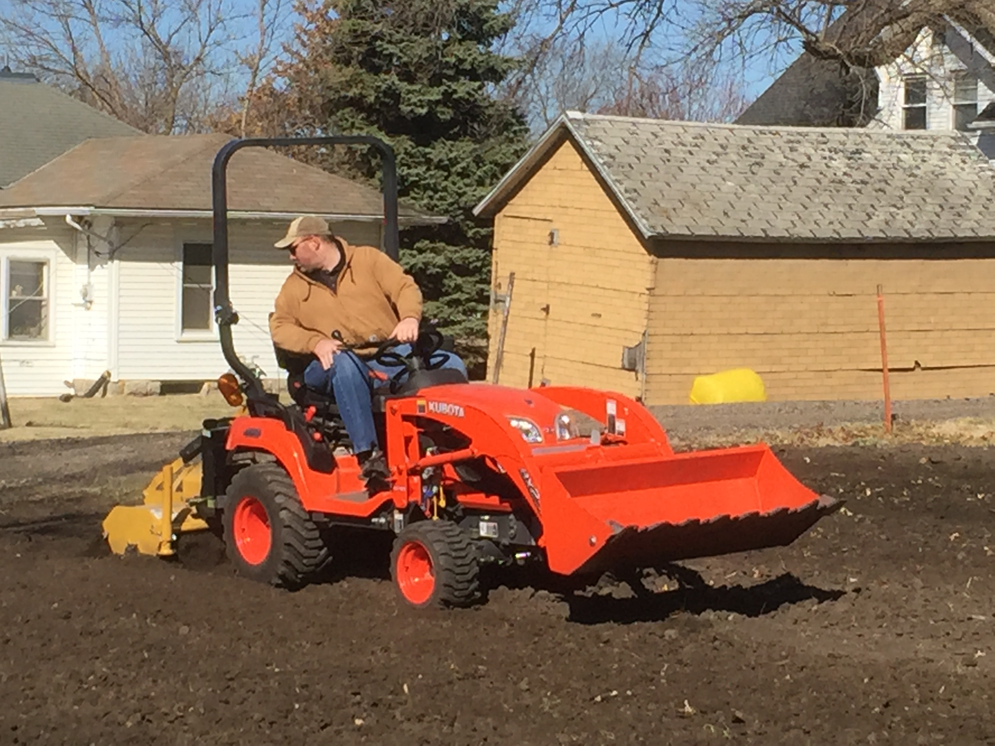

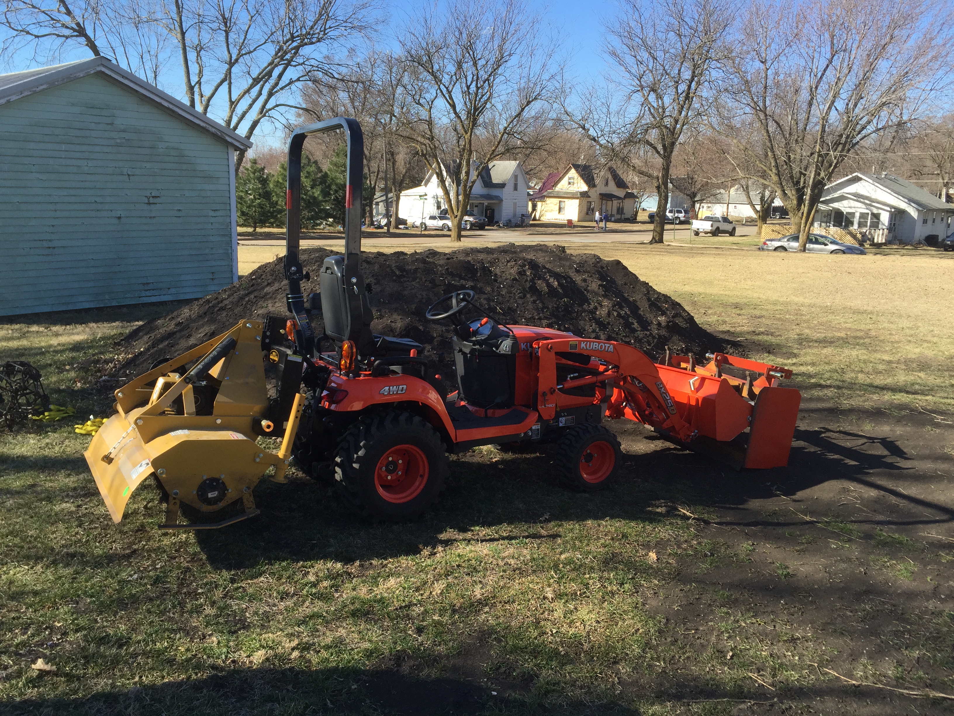

Attached are some pictures of my setup that a friend took a week ago when I tilled his new yard. The tiller is set on the second hole.
