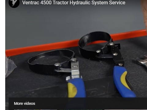

I had a hard time with the larger filter. The band on on my filter wrench would not slide past some of the framing. If you look closely at the wrench used in the Ventrac video, the band on the wrench used has a 'notch' in it allowing it to slide past the frame and around the filter.

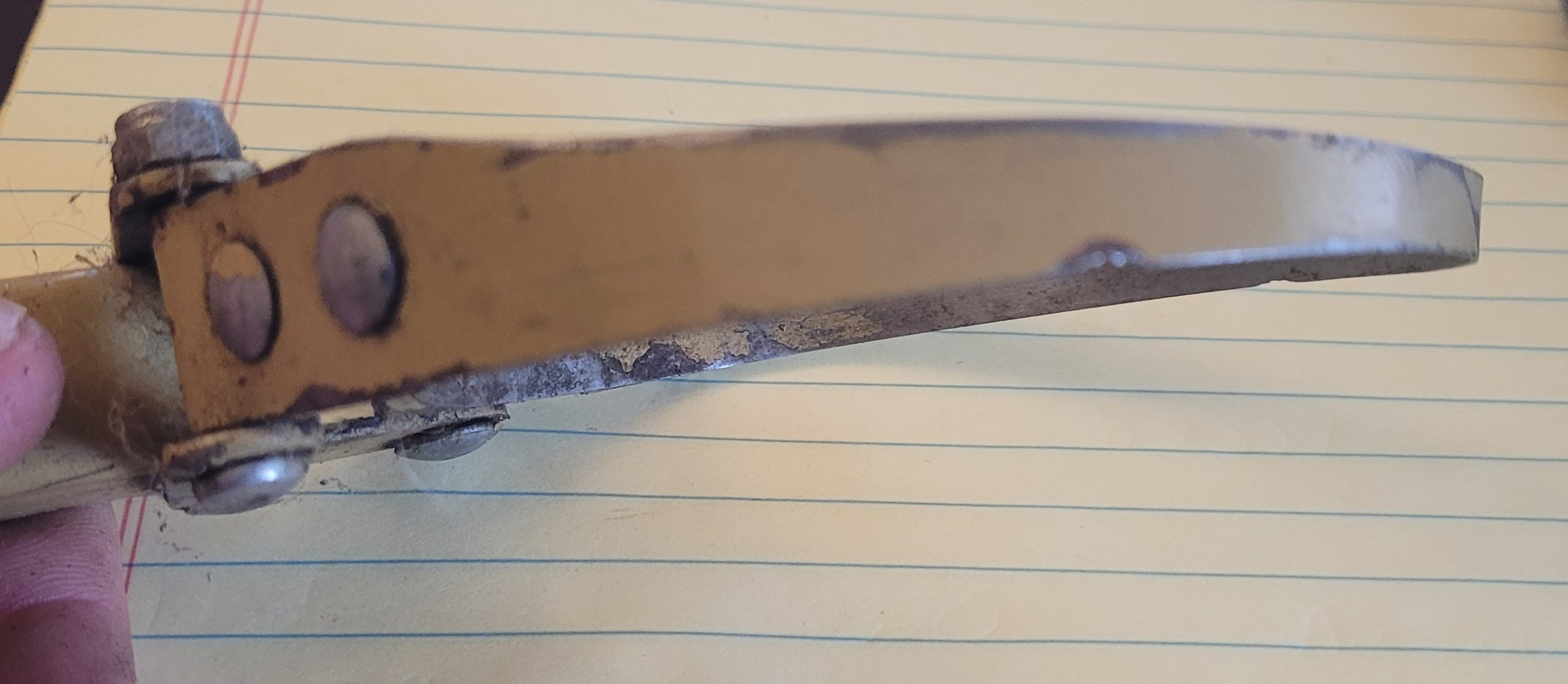

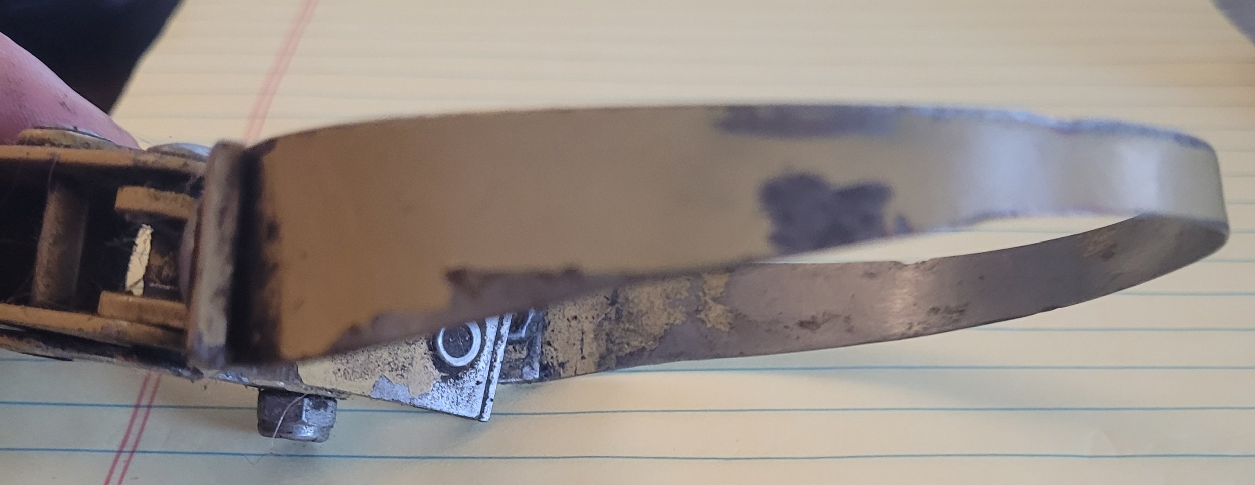

Thank you for the feedback and concern. I will pass that along to those who make the videos. I appreciate your patience too, as I tracked down that answer for you. The wrenches are standard oil filter wrenches that we grind the band down so that it will clear the frame and oil filter. I’ve attached three pictures: the first being from the video and the latter two current pictures of one of our Service Technician’s wrenches that are ground down.
I hope this helps!
I've attached the photos Ventrac sent.
I'll now grind down the band on my wrench in a similar way. You live and learn!
