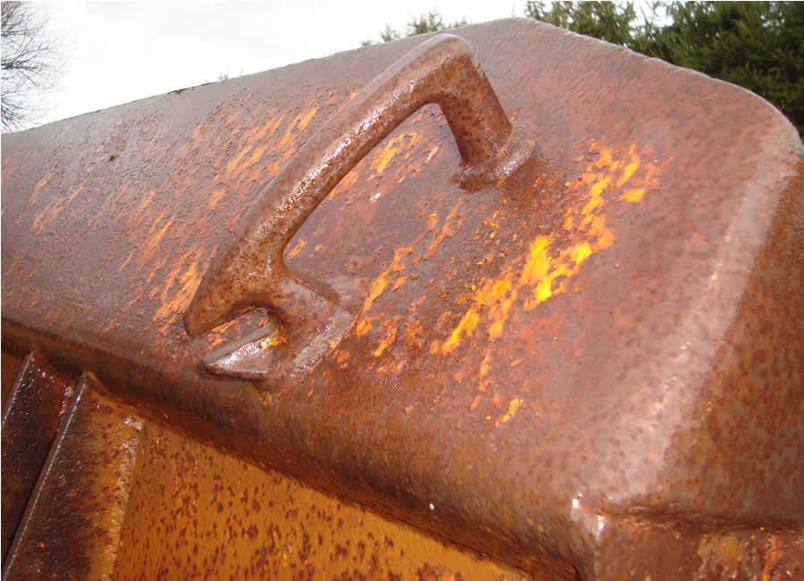

For that reason I use a little different system, a 2" x 4" x 1/2" plate welded to the bucket, a nut welded to the plate, and a clevis type hook attached with a bolt into the nut. The bolt is the sacrificial link that gives way when the strain is too much. When that happens, you pick up the clevis type hook, a new bolt, and re-install the hook. You are on your way in short order if you keep a couple of extra bolts in your tool box.[/QUOTE]
Greasemonkeyok
Your system sounds promising but, I can't understand exactly how you attach the clevis type hook to the 1/2 inch plate? Could you explain further? A photo would be even better.
   / Weldable grab hooks #17
Take the pin out of the grab hook, and run the same-sized bolt back through into the nut as described below. Actually, I also threaded a hole in the 2" x 4" x 1/2" plate below the nut so that the bolt is held in place by threads in both the nut and plate.
Also, I cut a shallow grove in the plate for the backside (left in the image) of the hook to impede its tendency to sway back forth. I suppose you could tack weld it if you wanted.
The plate would be to the left and perpendicular to the hook in the above image, the nut would be in the same location as the cotter pin, and the bolt would be inserted from right to left through the hook into the nut. With a little adjustment when you are welding and a little grinding, you can get it to fit snug.
For nut placement, drill the hole in the plate, thread the hole, then run the bolt into the nut and plate toghther. With the nut snug to the plate, weld the nut to the plate, checking the alignment periodically by running the bolt in and out.

Thank you greesemonkeyok. When the bolt breaks, is an easyout required to remove it?
   / Weldable grab hooks #20
... When the bolt breaks, is an easyout required to remove it?
Good question.
The release in tension on the bolt head when it breaks, generally at the threadline, makes it easy to back out. The threadline on the bolt is the fulcrum and weak point. I prefer Grade eight bolts because they don't seem to bend, they just snap.
Also, carefully tapping the hole in the plate prevents tension between the threads in the nut and the threads in the plate. And, cut the bolt short enough so that it doesn't bottom out on the bucket wall when tightened down. If the bolt is too long, it will bottom out on the bucket wall before it cinches the hook down, and then it would be difficult to get the thread portion of the bolt out if it breaks.
BTW, some of the pressure on the hook is on the back side of the hook that sits in the groove in the plate. Can't say how much that adds to the overall capacity of the setup, but I haven't had a chronic problem with the bolts breaking.
Another advantage is that if you have a job that the hooks will interfere with, just unbolt them and toss into the tool box. Sometimes small branches get caught in the hooks when moving a lot of brush.
