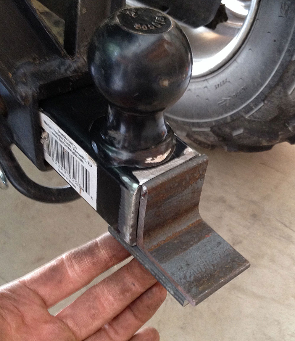

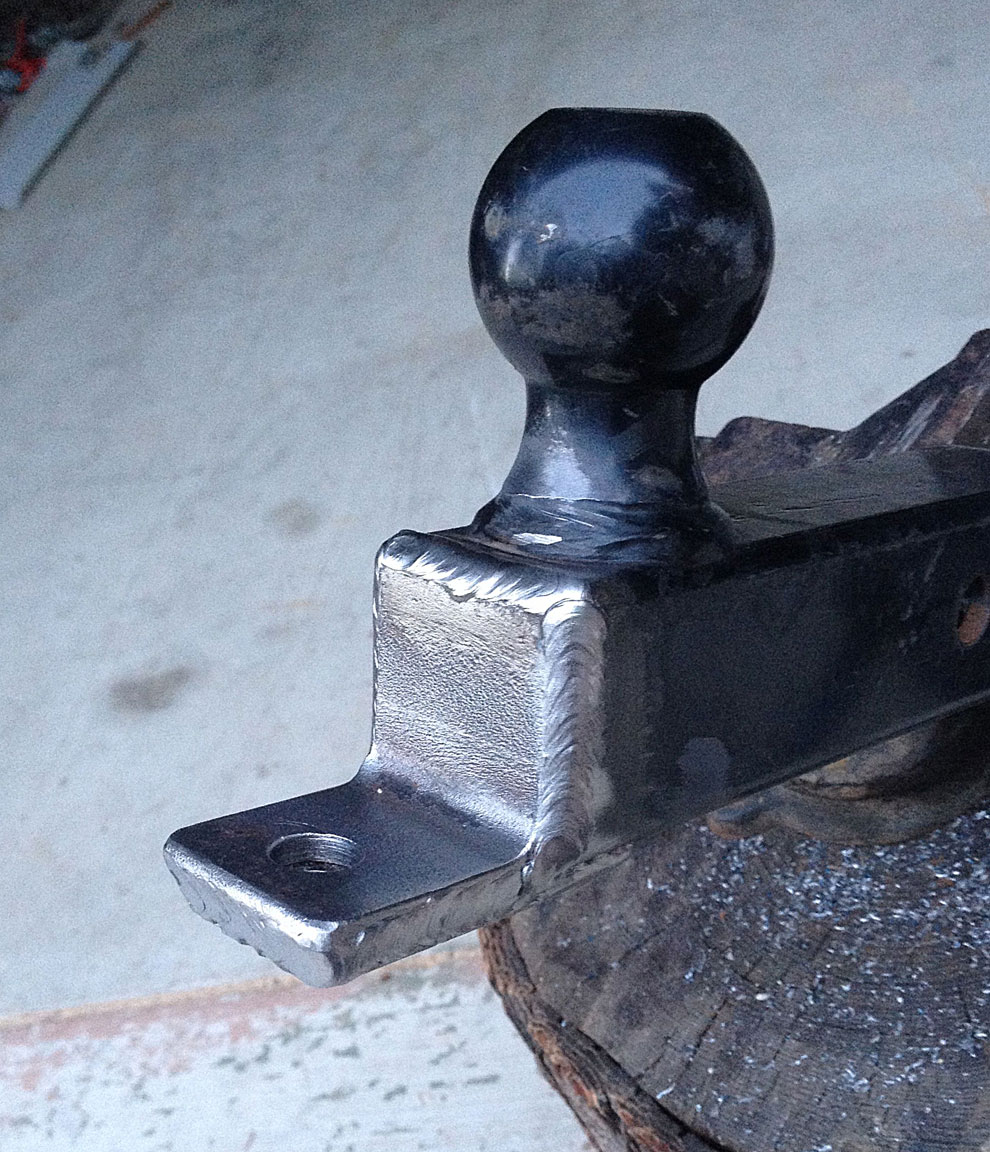

Here's an example of welding a trailer hitch for an ATV. Miller Multimatic 200 running on 120v from a pair of Honda EU2000i generators. Welder was 'preset' for 3/16" thickness. The angle is 3/16", the hitch sq. tube is 3/16", and the doubler below is 1/4".

While I do not understand the actual application that you are using this for, why use 3/16"?
Hard to believe that the Harbor Freight receiver hitch is 3/16" tube but to mount a piece of 3/16 angle to the end and then put a doubler that by the picture looks to be only at most 3/4" overlap back along the bottom of the receiver tube (if your fingers are huge then maybe more than 3/4" but not more than 1") seems to be structurally weak at best. Maybe if you are not putting any strain it would work but I have unfortunately seen 3/8" and 1/2" steel get bent where I would have never thought it would bend.
The penetration of the weld would need to be 100% just to give the full 3/16" its full strength. And as I already stated I think the 3/16 is a bit weak IMO. Without beveling using the 3/16 rated welder on the 1/4" plate doubler minimizes the ability to do a multipass weld with the smaller 3/16 " machine. I have seen comments by some folks that I respect on this and other sites (WW) say you can do a job with a small machine but it takes multi pass welds and beveling to get full penetration.

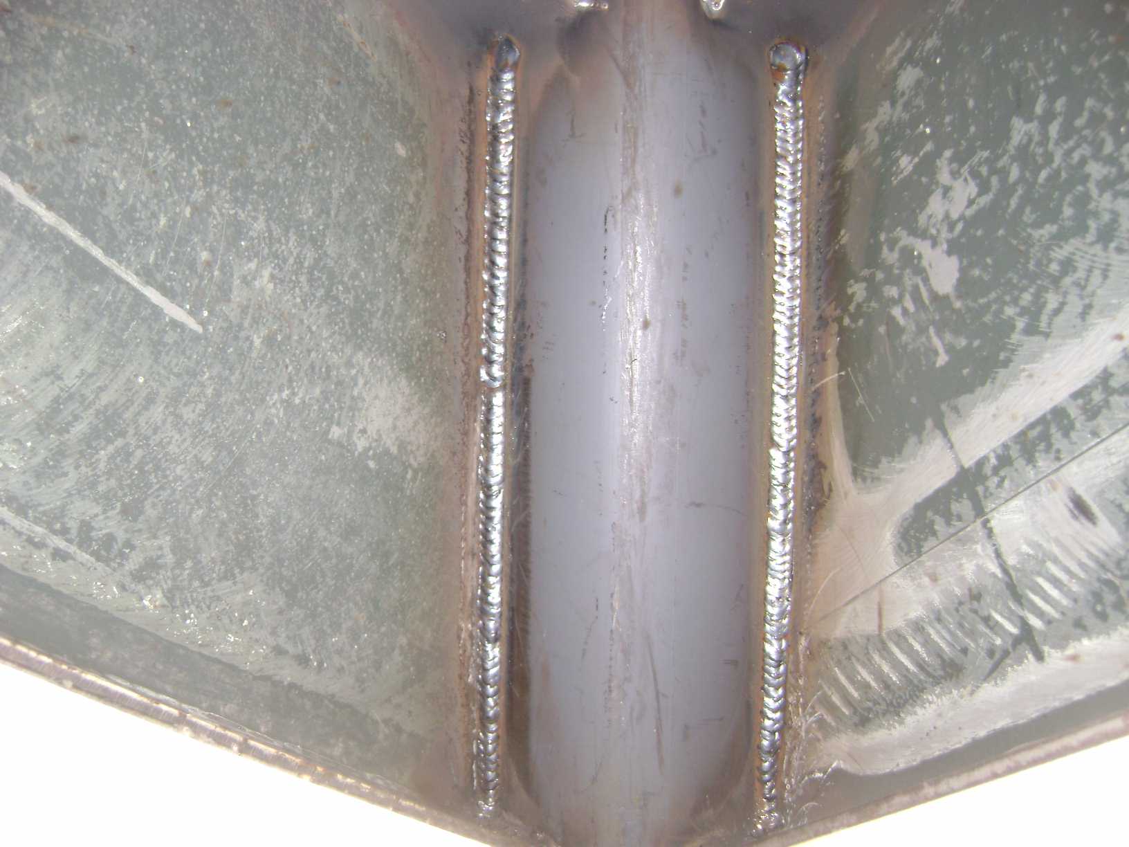

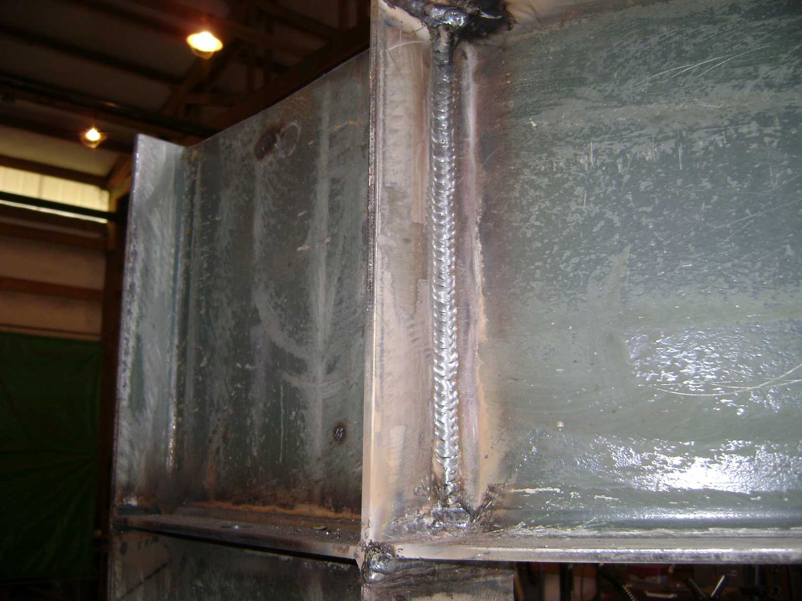

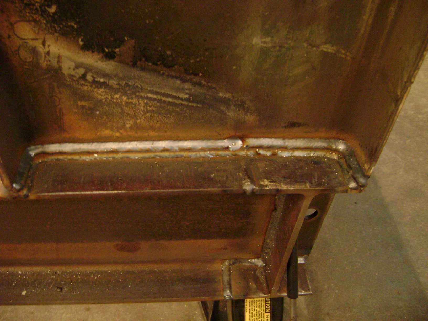

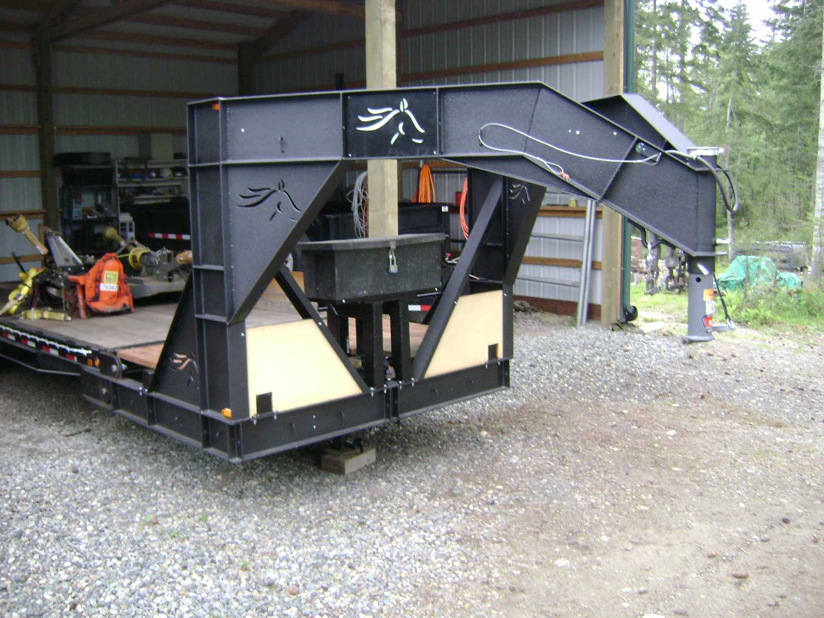

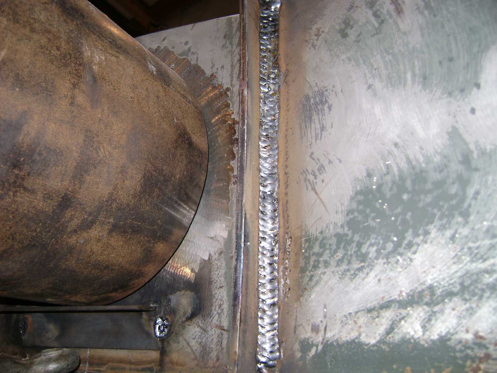

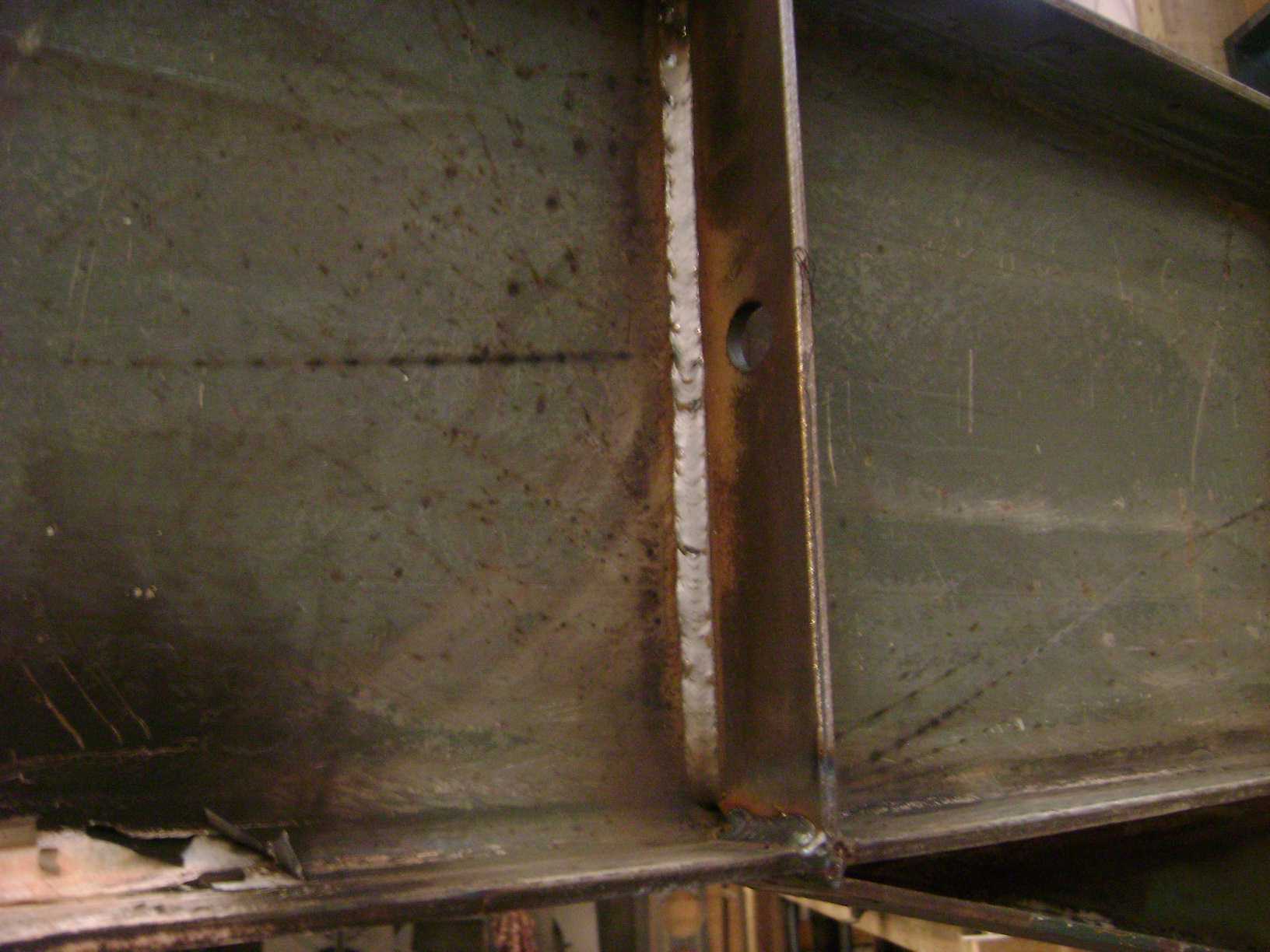

They do look very good!:thumbsup: But are you willing to bet your life on them? I'll bet my life and every one else's life on the road with my Mig welds.
Here are some Mig welds I did on my gooseneck trailer. As you can see I don't need a vice to weld.;)
