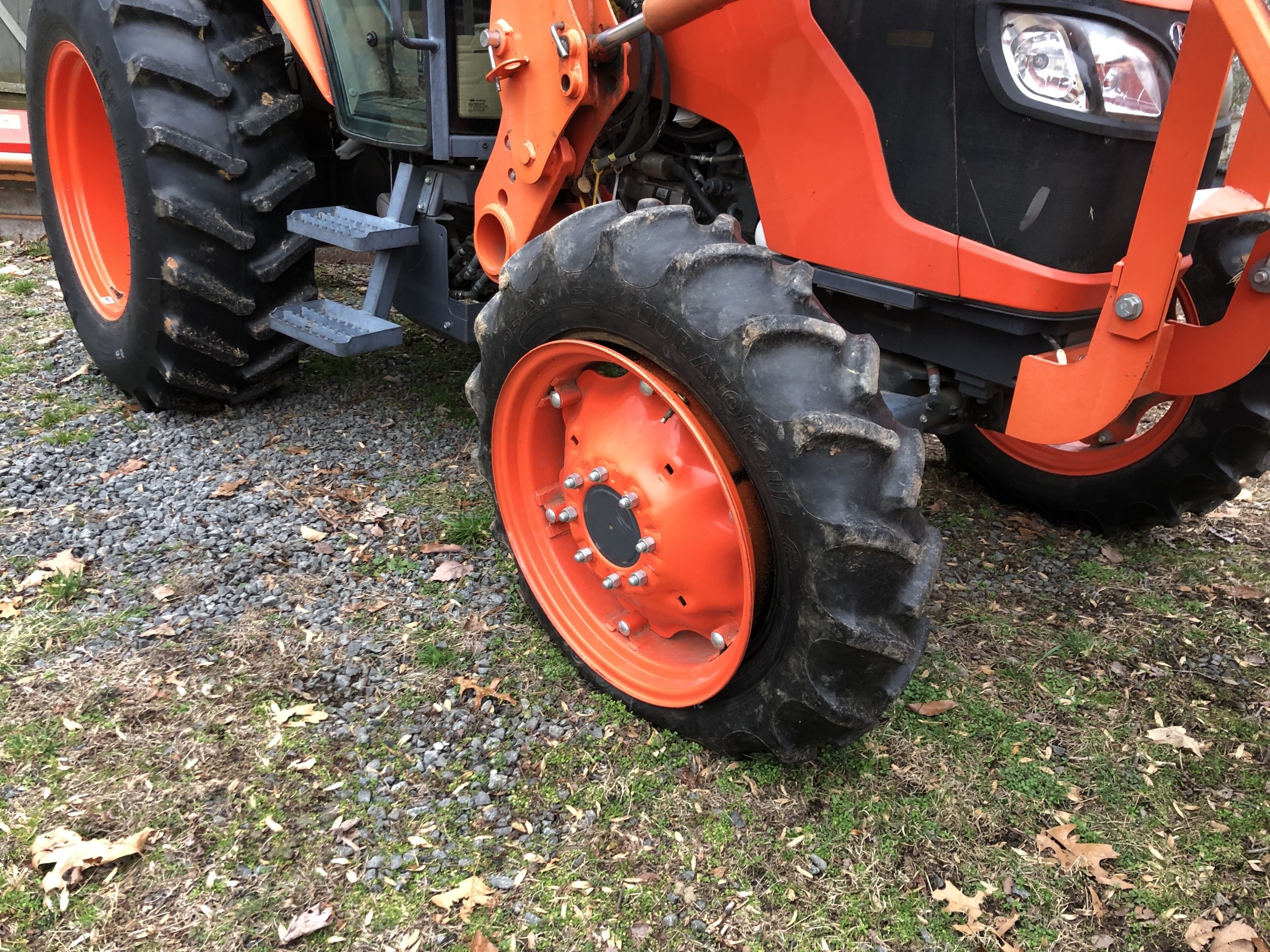

My Kubota M5140 has been sitting for about a week and this afternoon I notice the tire just popped off the rim.
It was fine this morning and this afternoon off the rim. Not just flat - completely off the rim. No holes observed yet. Vandalism highly unlikely, weather had been mild (in the fifties last few days). Anyone seen this before?

Low air pressure when was the last time you checked it...
   / What happened here to my tire? #4
Sure have. Tire went flat and popped of the rim. Been there done that.
you may be lucky enough to reair it up by pulling wheel off of tractor and laying it on a bucket, adding air while jockying around tire on rim. Sometimes works without lubing rim up . If not, trip to les schaub.
