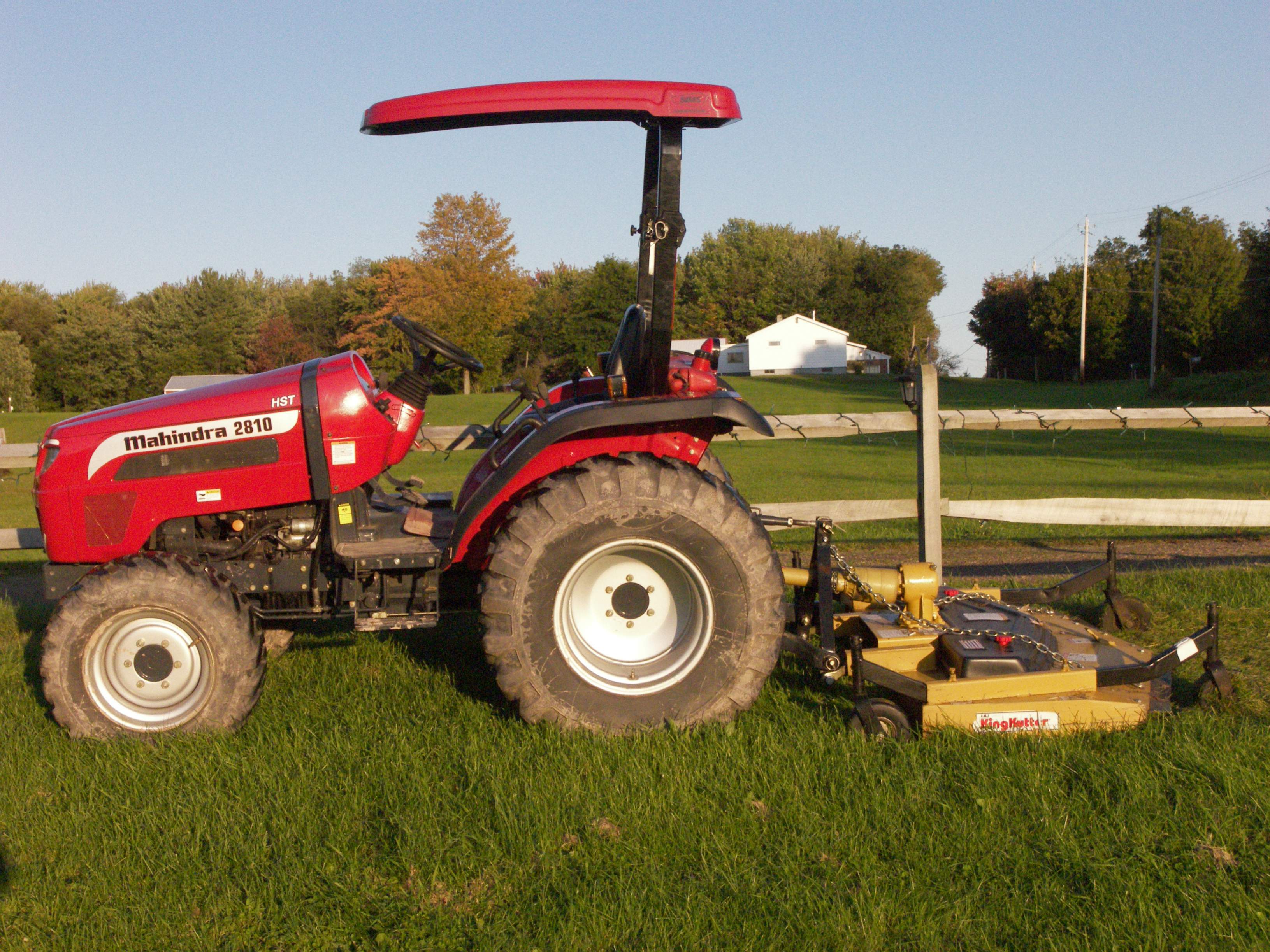

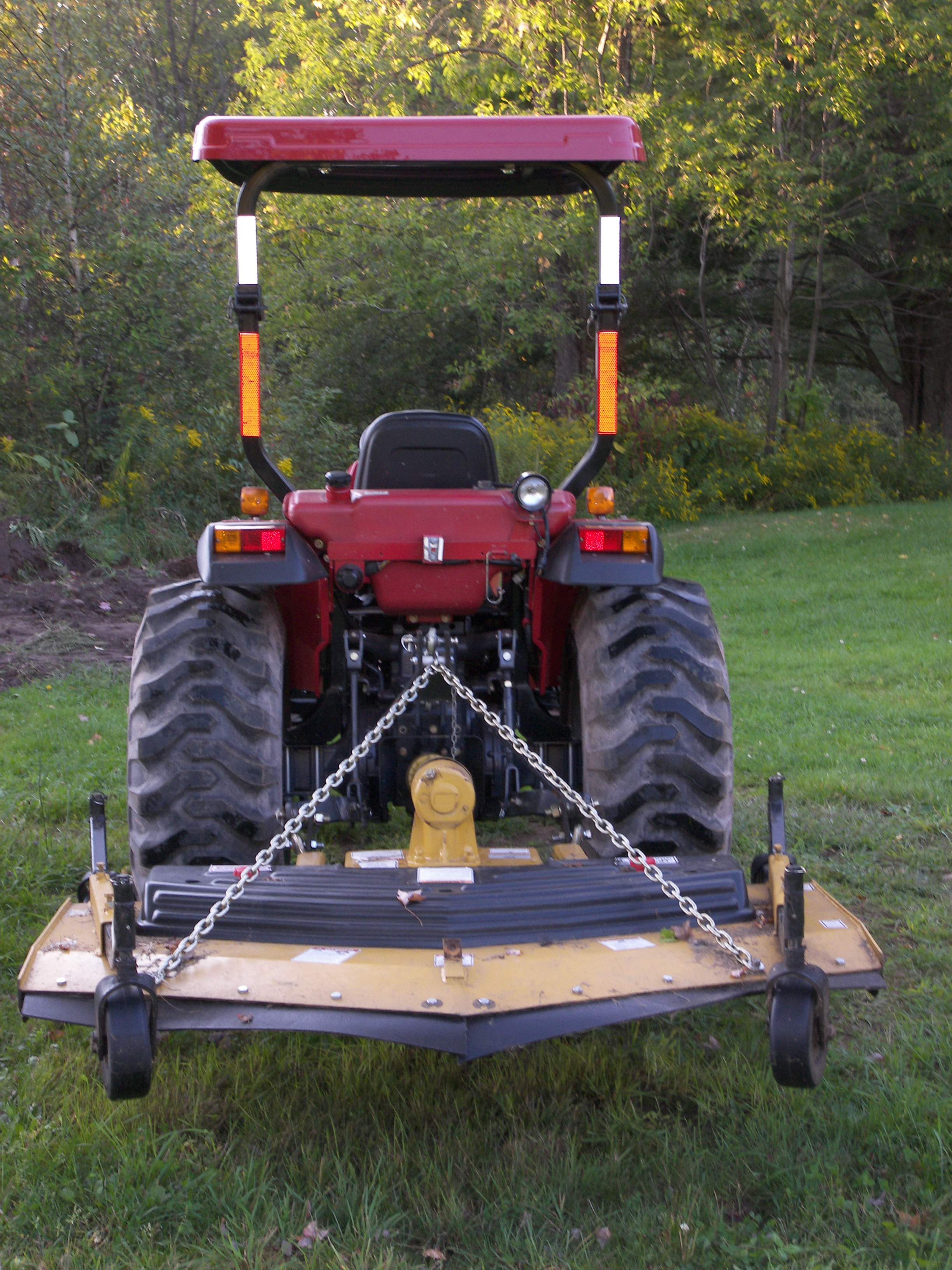

   / What size Rear Finish Mower for a 37 PTO HP #9
I would not hesitate to go 96" on the mower. I wouldn't settle for anything but a rear discharge finish mower because they "clump grass" a lot less and requires a bit less HP to run also.
I have a KK 72" RD finish mower which i run behind my Mahindra 2810HST and Kioti DK35SE HST. My grass last year grew about 8" a week and neither tractor had a problem mowing at a decent speed.
My KK is going to be 4 years old soon, its mowed 5000 acres and i still have the same belt and blades on it. It came with Oregon blades and they hold an edge nicely giving a nice "striped" finish look after mowing.

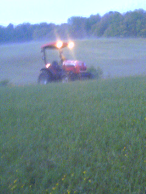

I've done no maintainance up to yesterday other than greasing the wheels and spindles. I bought new wheel bearings and 4 axle bolts at TSC yesterday for $46. Cant complain about that cost for the amount of mowing i do. I'm going to keep this mower another year or so and then buy a new 96" KK if i can find one . Heres a couple of pics of my mower. . .Good luck . . .John
