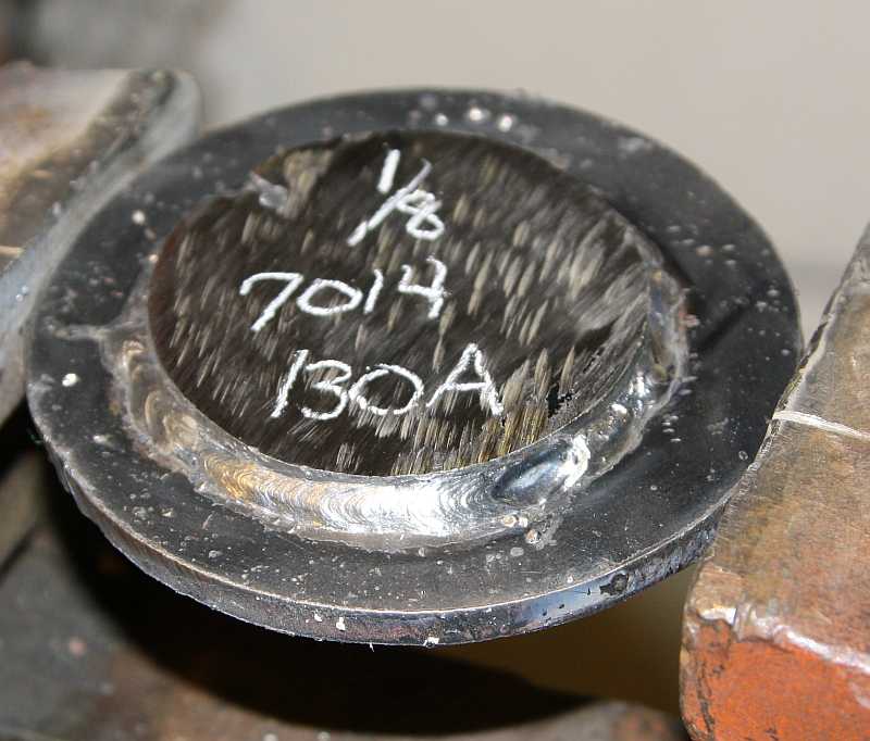

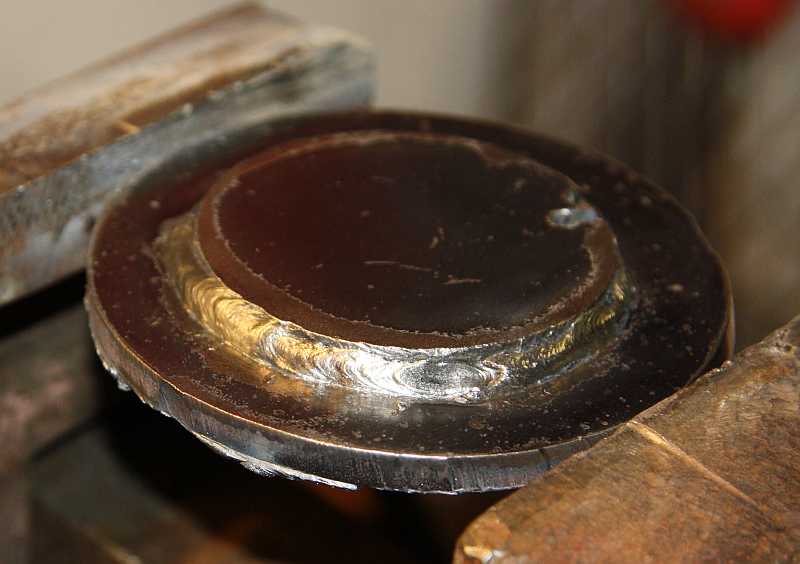

If you read my other thread, you know that a local shop agreed to supply me with their drops for welding practice. I go get a bucket, weld them together and then go back and exchange them for more drops. I don't have to pay for practice material and their drops come back heavier. Not much of a gain for them, they're really just doing me a favor.
Anyway.. they're cutting circles out of 1/4" plate on their plasma table for a customer. The foreman suggested that I weld the small ones onto the large ones to get used to welding a curve and holding a consistent rod angle while doing it. I don't know how successful I was, but it's good practice I suppose.
I decided to stop playing around with all the different rods and stick with 7014 till I can get a consistently good bead with that (or I run out of the 5lb I have). Then I'll move on to the others.
Here's what I ended up with.

Looks like you're coming along pretty good since last week.:thumbsup:
   / What the welding shop has me doing... #3
Looking good ! I have seen some "pros" work that didn't look that good. Nice deal you set up with the scrap material , good thinking !:thumbsup:

When you get yours, you'll find that there's not much of a learning curve to 7014 and fillet welds. 130A seems to do well for 1/8" rod and 1/4" material. All you have to do is figure out rod angle and speed.
Butt welds are a different animal. There is a reason why I haven't posted any pictures of them. LOL

When you're ready to challenge yourself mount the base at a 45 degree angle on a piece of scrap then weld the second disk to it. weld in a continuous loop to get all positions. MikeD74T

Looks excellent to me, Haywire..
You should be proud of that work!
