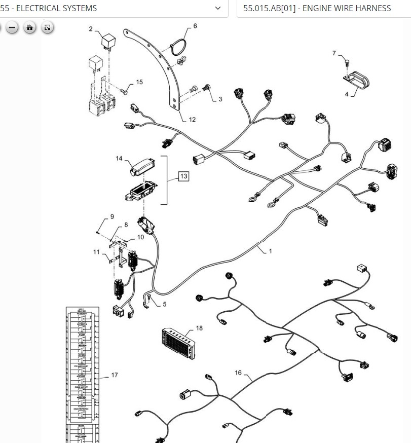

I got my hands on a shop manual. The trouble shooting page leads me to three things, range switch (I know this is good), safety module, and 3A diode. I can't find anything else in the manual that shows where the 3A diode is or what the safety module consists of.
   / Workmaster 60 dies in neutral #8
According to the parts diagram, the diode is in the electrical panel probably under the dash cowl. 17 is a relay layout and shows a Safety Run relay that might be the safety module. 18 is the 3A diode. Might be that shape, but not what I would expect.

Thank you sir. The relay in the safety circuit or module was bad. Popped a new one in and back in business. Back to loading logs on the sawmill.
