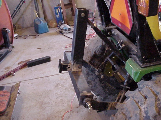

Seeing all the 3 point receiver hitches you made me do one!! Pretty easy project. Receiver cost me $10, steel was laying around, $6 for the cat 1 pins. About 2 hours labor. I can't see how anyone can charge $200 for these things. Its a simple build, and one of those, get it done pretty quick, look at it, and smile at a job well done!!
I used 3x3x1/8 square tubing (since I had it), 5/16" plate welded to the ends to hold the cat 1 pins. I welded the receiver tube to the horizontal tube, then cut out the vertical tube to fit over the receiver tube and welded it all around.
I need to try it out, then, based on the trial run, I may add a brace from the end of the receiver tube up to the vertical to brace it. Of course, I need to add hooks, but for some mysterious reason, the couple places I stopped to pick a couple up are all out of them at the moment.
Thanks for the ideas!! Now what else can I make??

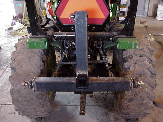

another pic

Nice looking job. All you TBNr's that can weld make me Jealous as all He** fire. I got to go learn how !!!!!!!

Great idea /w3tcompact/icons/clever.gif and looks better made than one could purchase.Do you plan on welding chain hooks or etc..

I agree that the best way to learn is to just jump in.
BUT on something that may be hazardous to human life please make sure you load test your forks before you possibly put your body under them (we all know that you should never stand under anything lift by equipment hydraulics but stuff happens).
