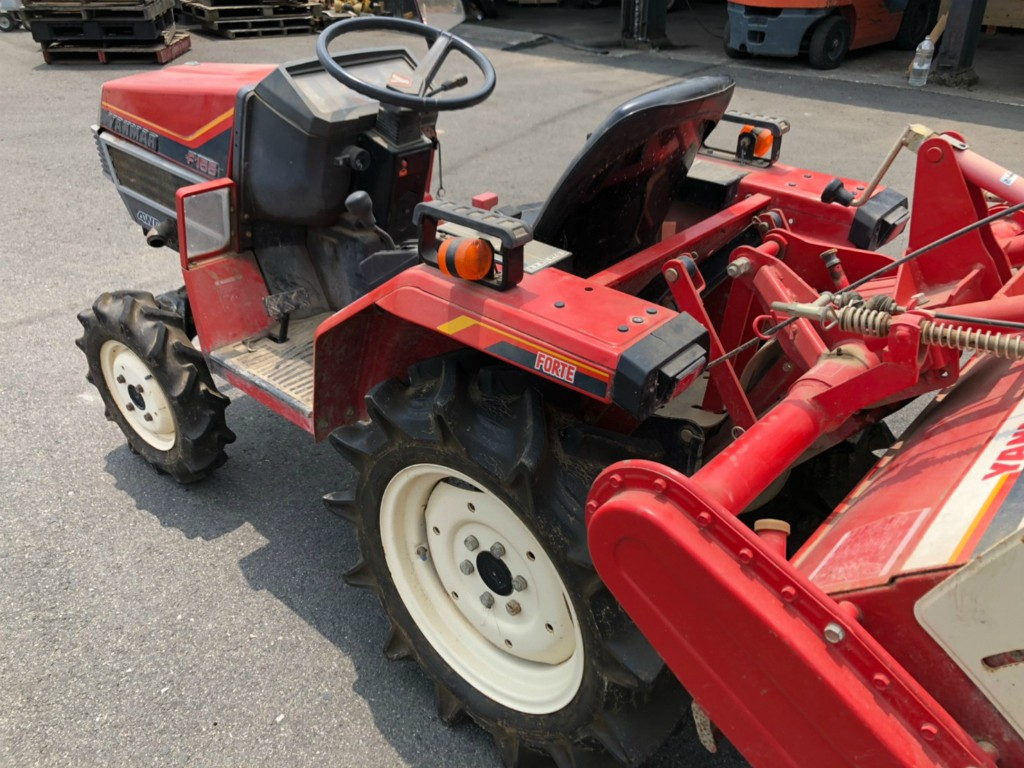

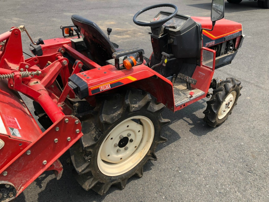

Me and Google thought we would put the tip you gave to good use. We located and have attached photos of an F155D with an attached RSA1205 tiller that is physically in Japan as I post this, ironically, on a site selling greymarket equipment.
Because the internet is forever and the above link will eventually go dead when the tractor is sold, this is the link to the page in the web archive, which is the forever of the internet.

I noticed that the For Sale machine+tiller is missing the hiller-disc wheels on the back. bummer.

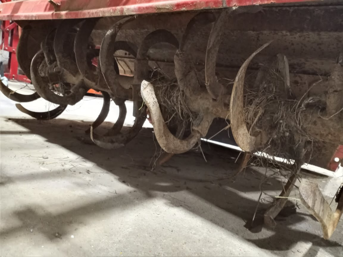

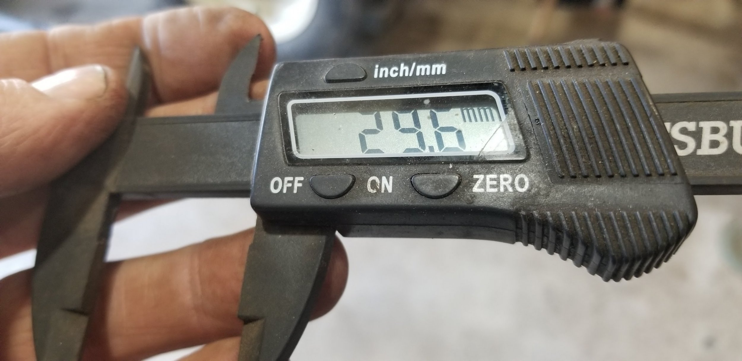

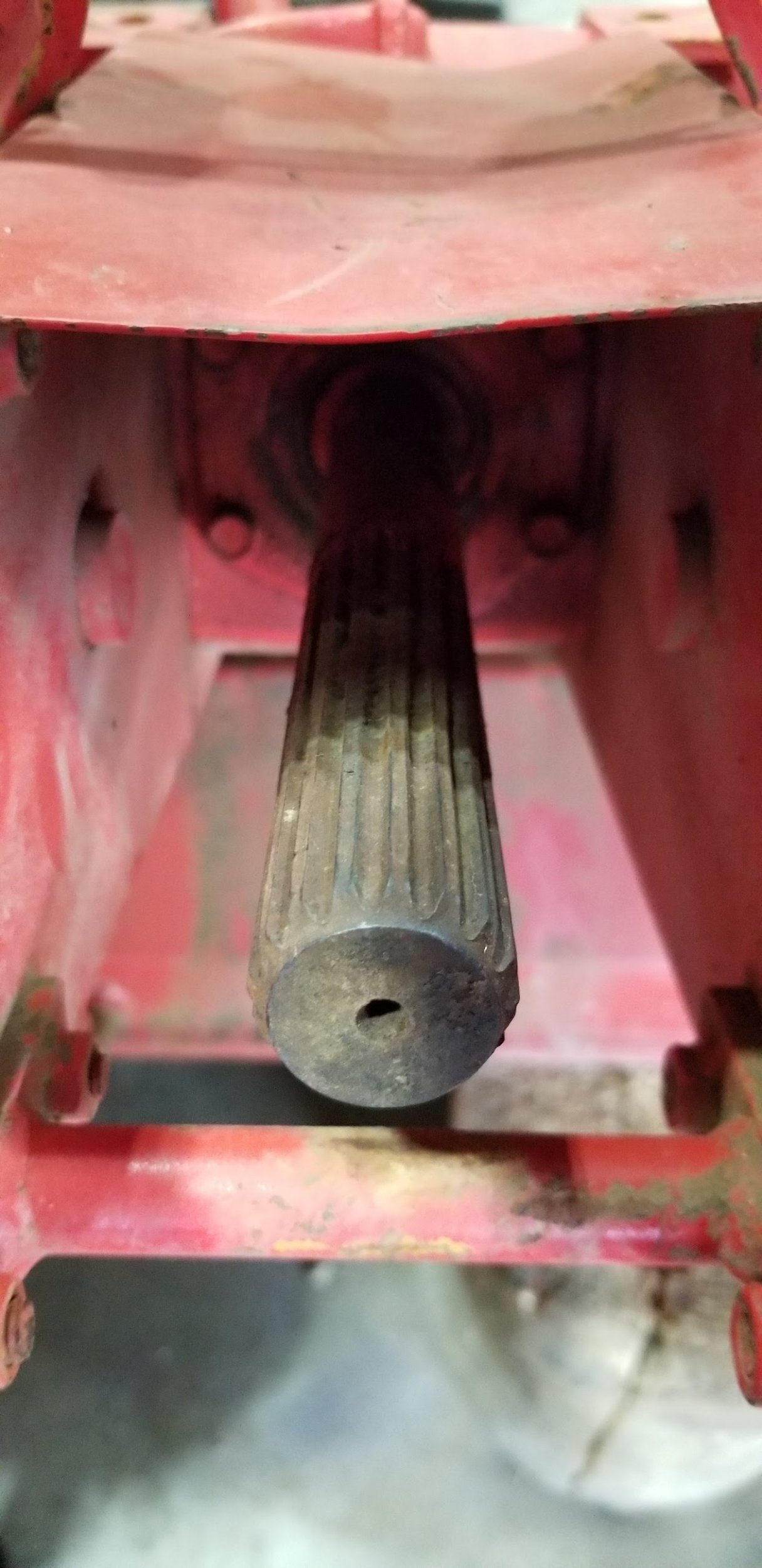

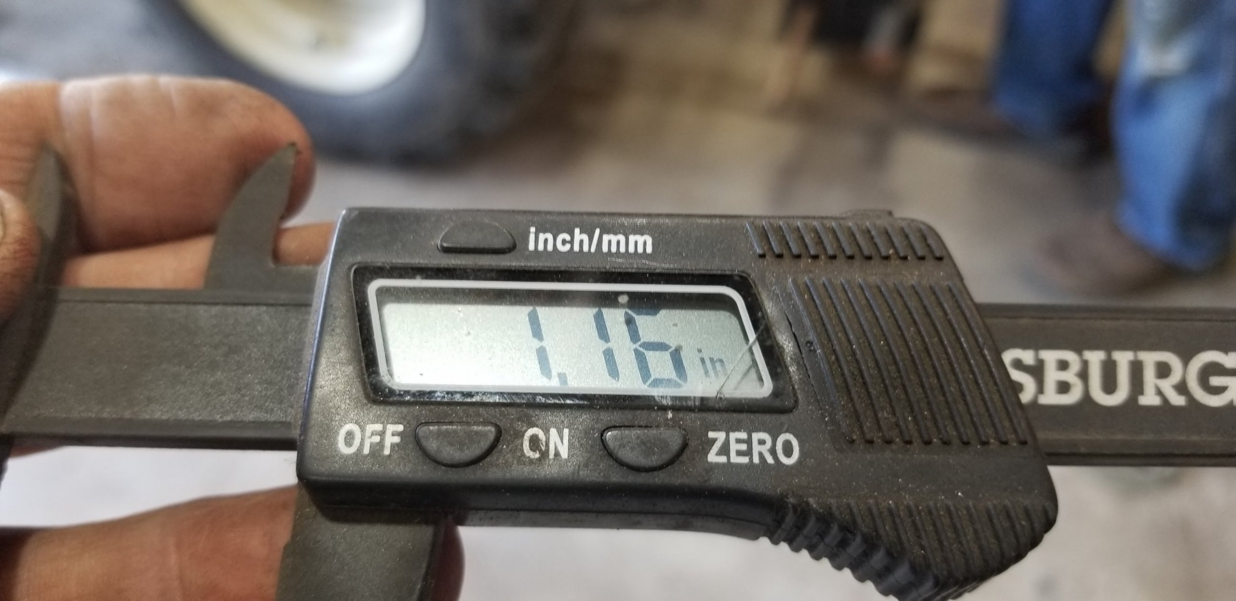

The fabrication of converting this unit to a 3pt is all but complete. I will post up some pictures of our design to do this when the following question has been answered.
The PTO shaft of this tiller measures 29.6 mm (1.16 in) at the tines with a mic and there are 16 tines 4" long with no stop notch or block of any kind and extending another 4" or so before entering the gearbox. We knew finding a direct fit drive shaft for this would be silly to even look for and will fabricate a solution easy enough (read as "buy an adapter and weld it on"). What I want to know from the community is:
Can this tiller run at 540 rpm or best at 1000? Everything I find of documentation for this thing, which isn't much, is in a language I can not read. Based on the info in this thread, (photos), can anyone give a reasonable bit of guidance to this? It needs the appropriate spline count when the modification is made.

Running a 540 tiller at 1k rpms is not something I would do for any reason I can think of. 1k rpm units have different gear reduction ratios to adjust for the increased horsepower that usually is put to them. The 1k rpm units turn the tines with much greater force rather than for any increase in operational speed. When you get up in size of tillers running more and longer digging tines more power is required to turn it. It then hits those big rocks and giant roots MUCH harder, which develops too much back force for the 6 spline to take and they will frequently suffer catastrophic failures. The only difference between 540 and 1k rpm connections is 21 splines to take the abuse. Both use the same 1 3/8" shaft diameter.
With 16 splines and yet a 1 1/8" shaft I'm not 100% sure which is the correct speed this unit is designed for and I would really like to be.

I have run my old yanmar tiller at all speeds with good results. However, with that spline, I would believe the tiller is made for higher speed then 540.
