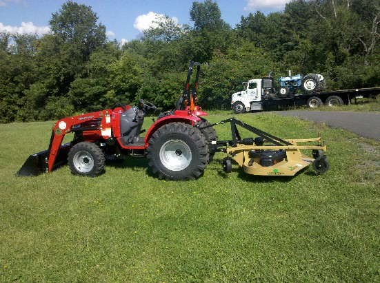

bubbwe
MAHINDRA3616SHUTTLE Mahindra
Mahindra 3616 Shuttle
Model Year: 2011
I bought my tractor new last year and used it for mowing ~3 acres, and building a motocross track on my 8 acre property. I have used the finish mower, box blade, bush hog, and york rake. I just recently did the first oil change at 50hrs. Make sure when you do the oil change you drain oil from both drain plugs or you will have too much oil in the motor. Also the oil filter is a pain to take off and on. You will need a filter wrench that looks like a huge socket to fit over the filter. If you use the plier type wrench, you will dent the filter putting it back on. The tractor is fantastic and will go anywhere and do anything. I have no liquid in the tires or wheel weights and have not had a problem going anywhere. The tractor is extremely well built and very heavy duty. Absolutely sips fuel. I would buy another one in a heart beat. The only thing I would do different would be to get the HST version as working with the bucket on finish grading is kind of hard while using the clutch.
Pros: Build, looks, performance, fuel economy.
Cons: Oil filter placement.
Photo Uploads:
