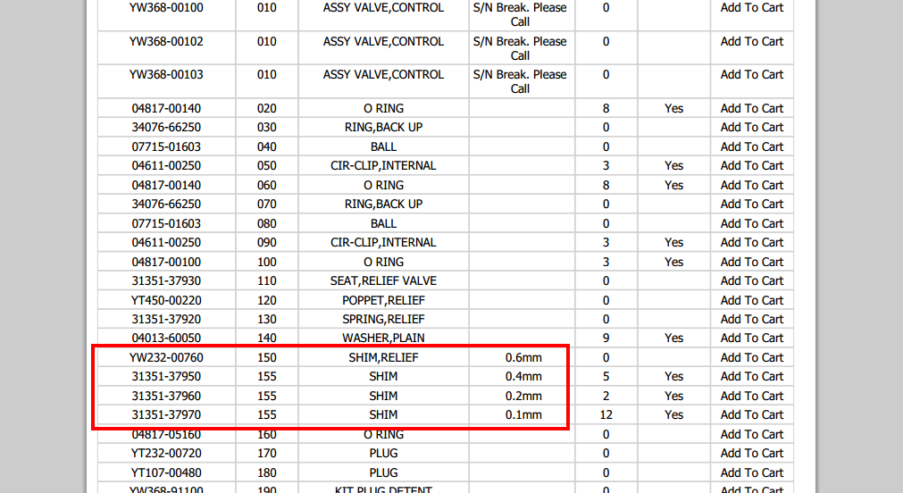

i have everything i need to adjust the hydraulic pressure. I am at home one day out of 40, and i can not find the bolt to remove to add the shims. ANy HELP.
Brand new L3940
   / L3940 kubota where is pressure relief valve? #2

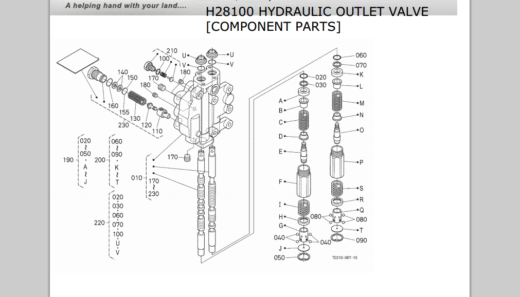

It is either on the FEL valve or on the hyd block.
Soon as I get the hyd diagram from Messicks I can tell you more.
230 - relief valve
155 - shims

It is the large hex bolt below the right work port.
ok I found it btw. The valvle that you posted a pic of is located on the right side under the 3pt lift adjustment, behind the right rear tire, roughly above the center of axle.
to orient the pic that you posted, it is made from a perspective if you where standing on the left side of the tractor near the floor board, looking to the right rear of the tractor.

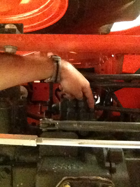

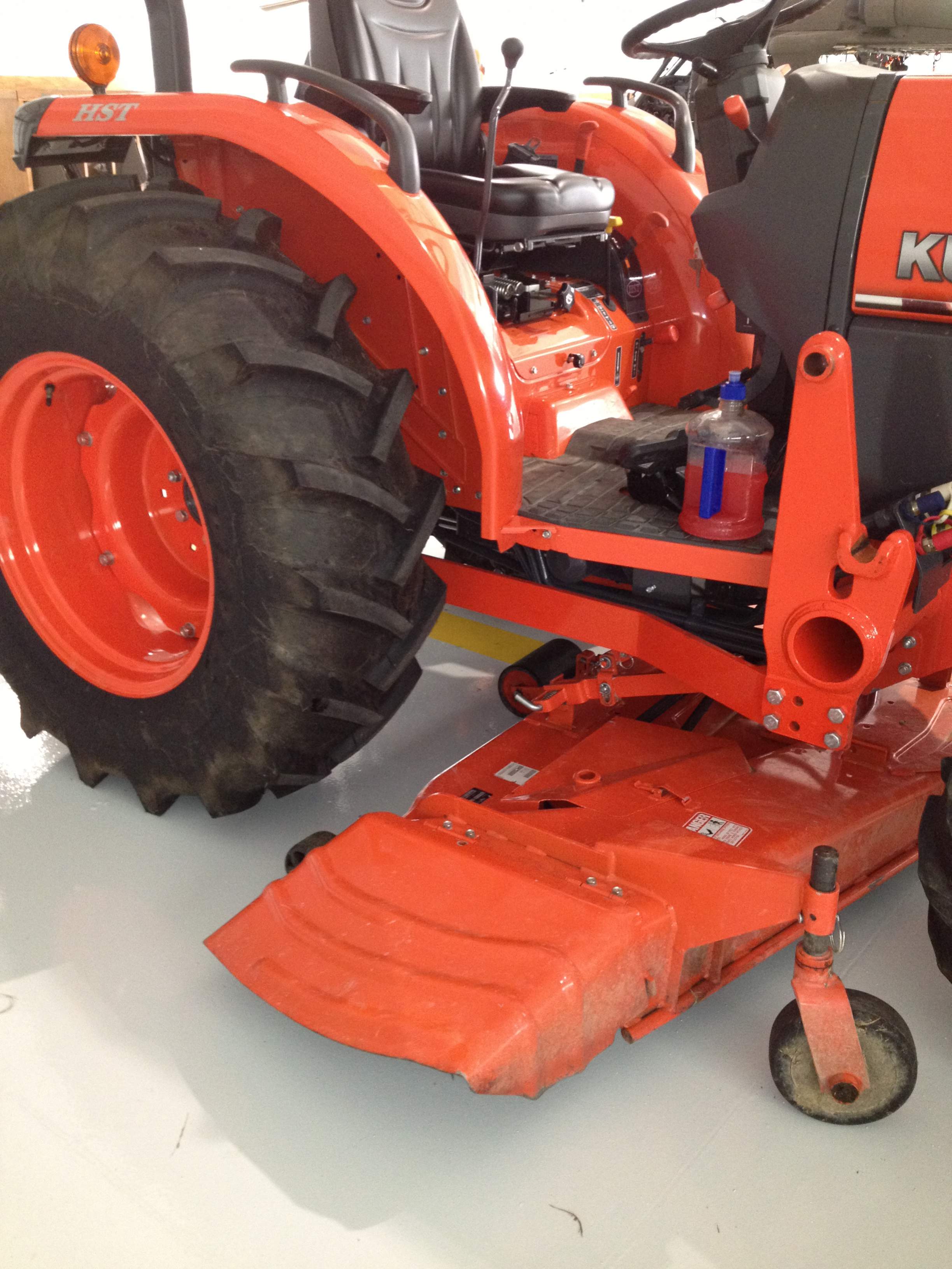

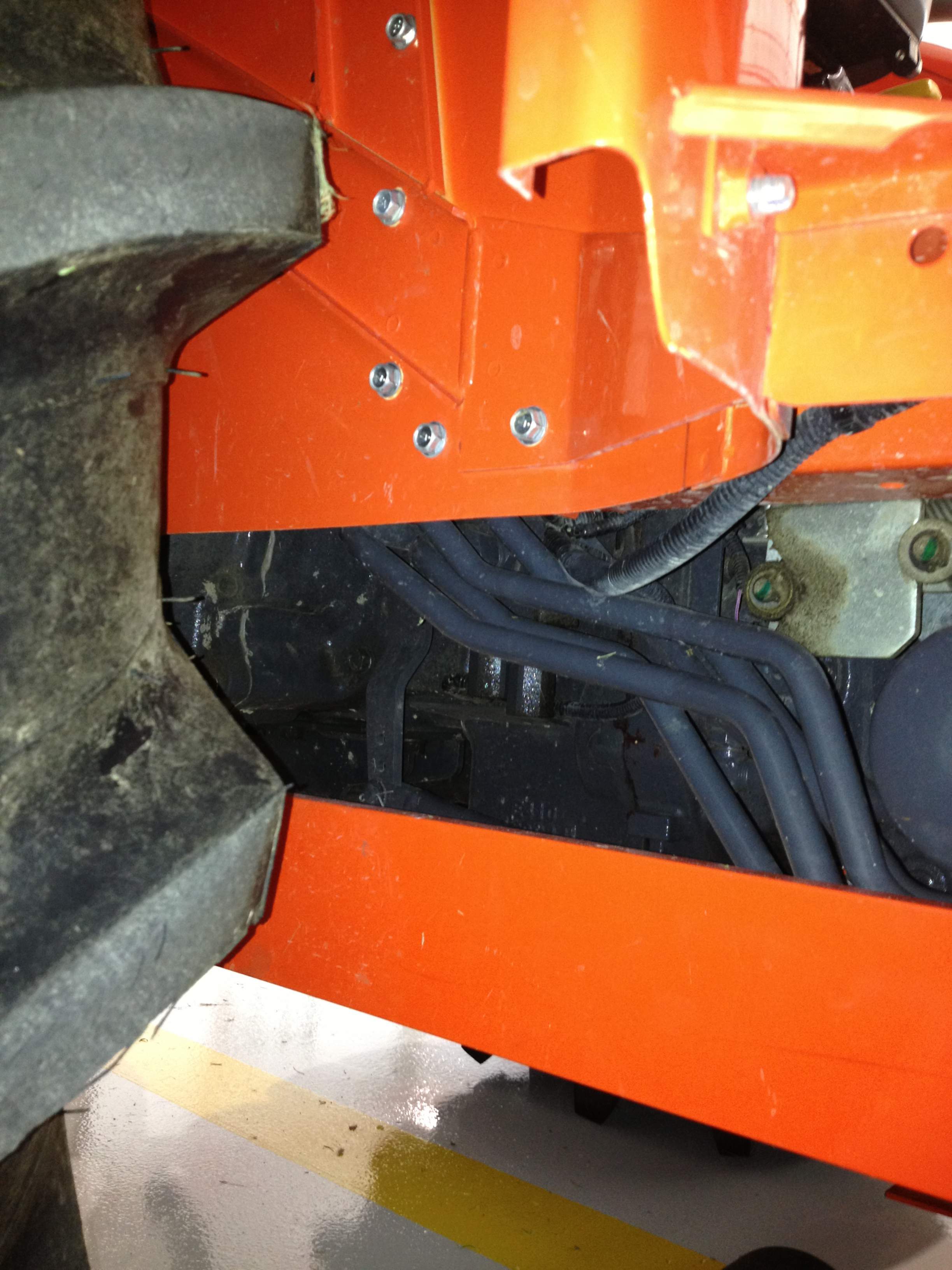

Sorry about that I have yet to buy the stuff to do a pressure check, so i put things off. The image in above post shows the block. The shim is itme 150 and 155. That pic is as if you were about to mount your tractor from the left side, and you are looking at the center of the right rear tire.

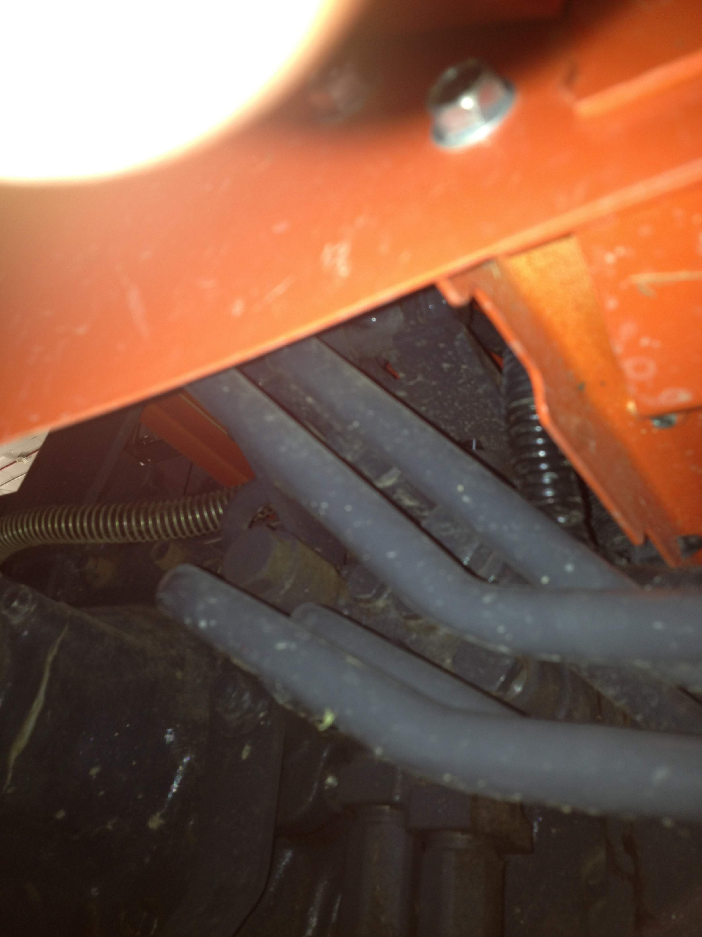

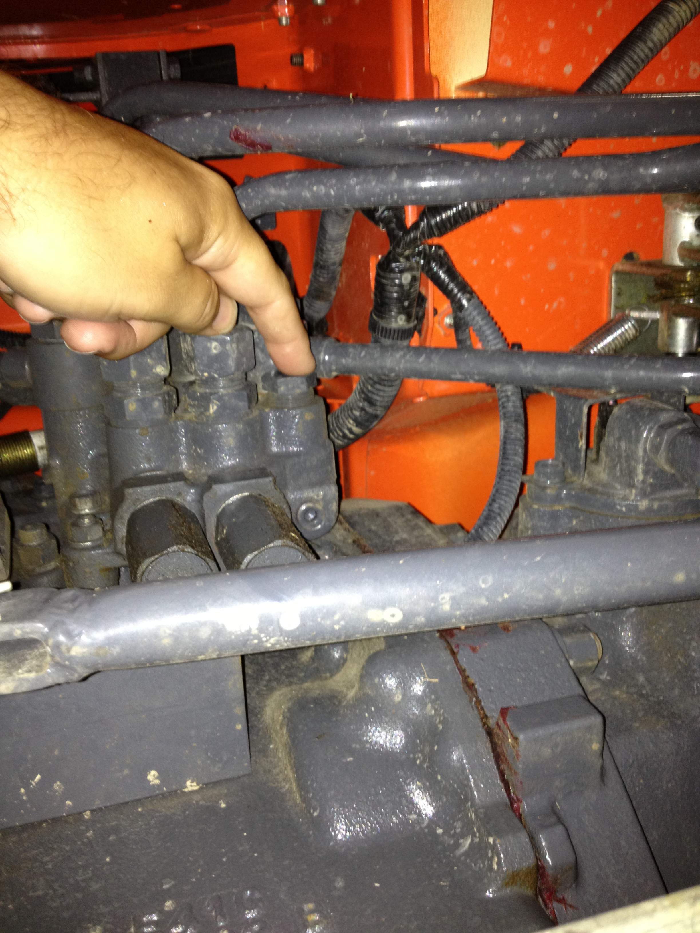

Id you crawl under your tractor it is near the axle behind(inside) the right rear tier. We have the same tractor here at work, i will try to remember to shhot pic in the morning. My tractor is at home which is 3 hours away
#9
the first three pic i just zoomed in on the same area. the last two are from under neth looking up. the front is to the right, the rear to the left, and the camera is looking straight up near the right rear tire.
now i have not taken mine apart, but as far as i can tell that is the place

So I added 1 washer .050" and brought the pressure up to 2950 psi; a 400 psi increase at 2600 RPM.
Still would not lift this 1900 lbs. pallet I needed it for.
