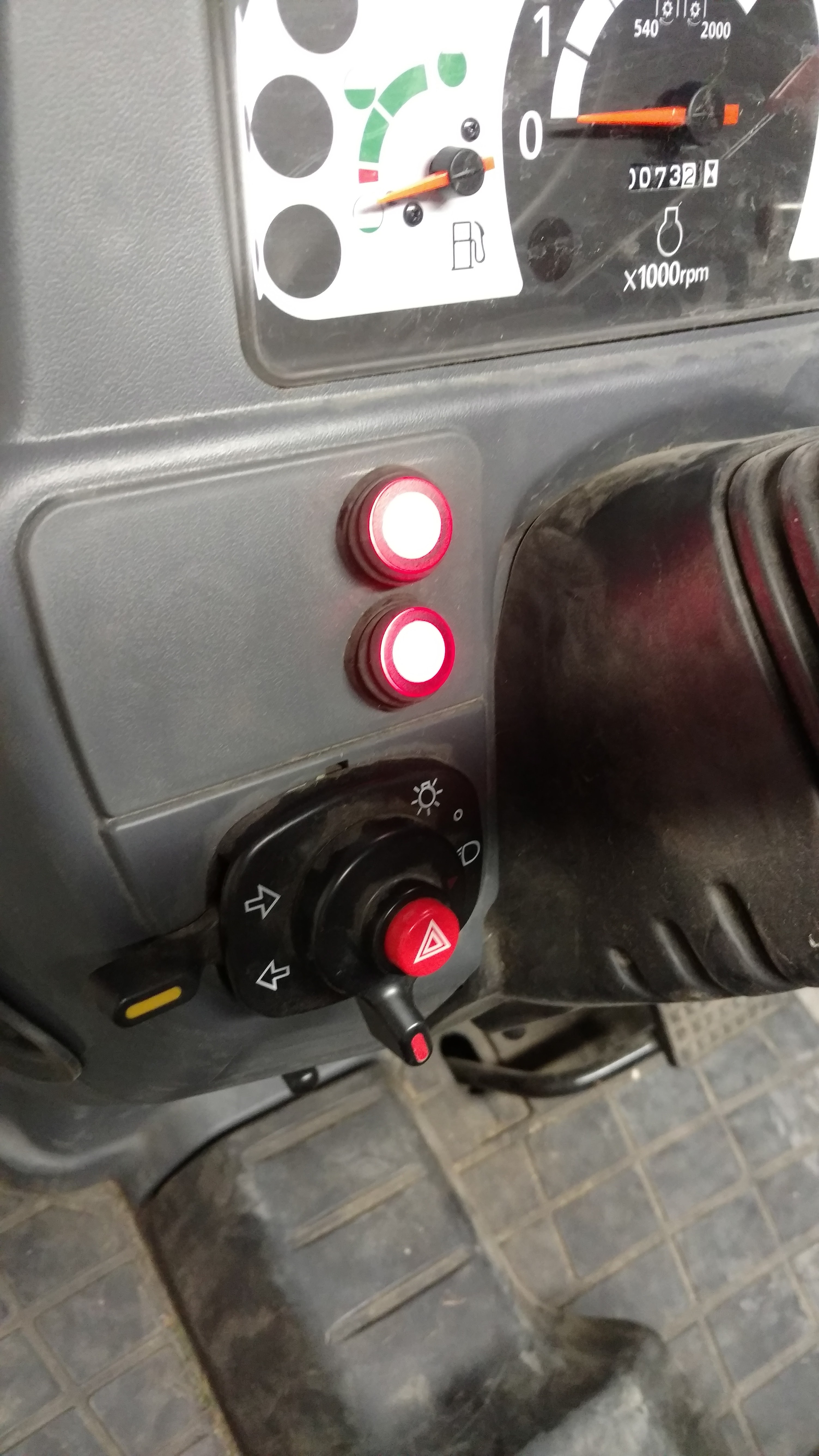

I did a lot of research on this site before attempting to install LED work lights on the ROPS and found various tips throughout different threads, so I decided to try to help the next guy and put it all together for how I went about doing mine. By the way, YES, my tractor needs cleaned, LOL, but it is a tractor after all.
1. Raise hood and remove both side covers from the engine bay

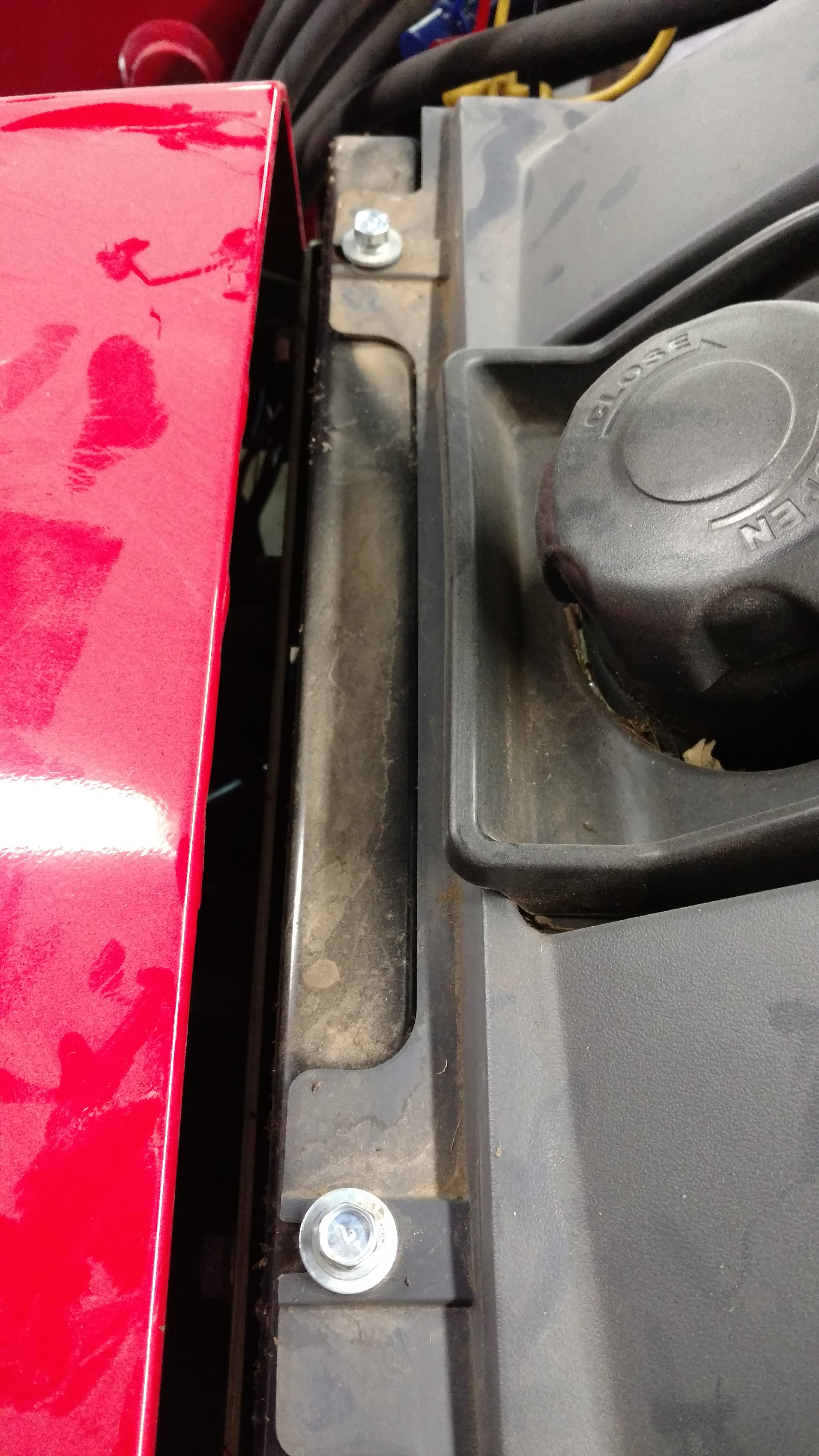

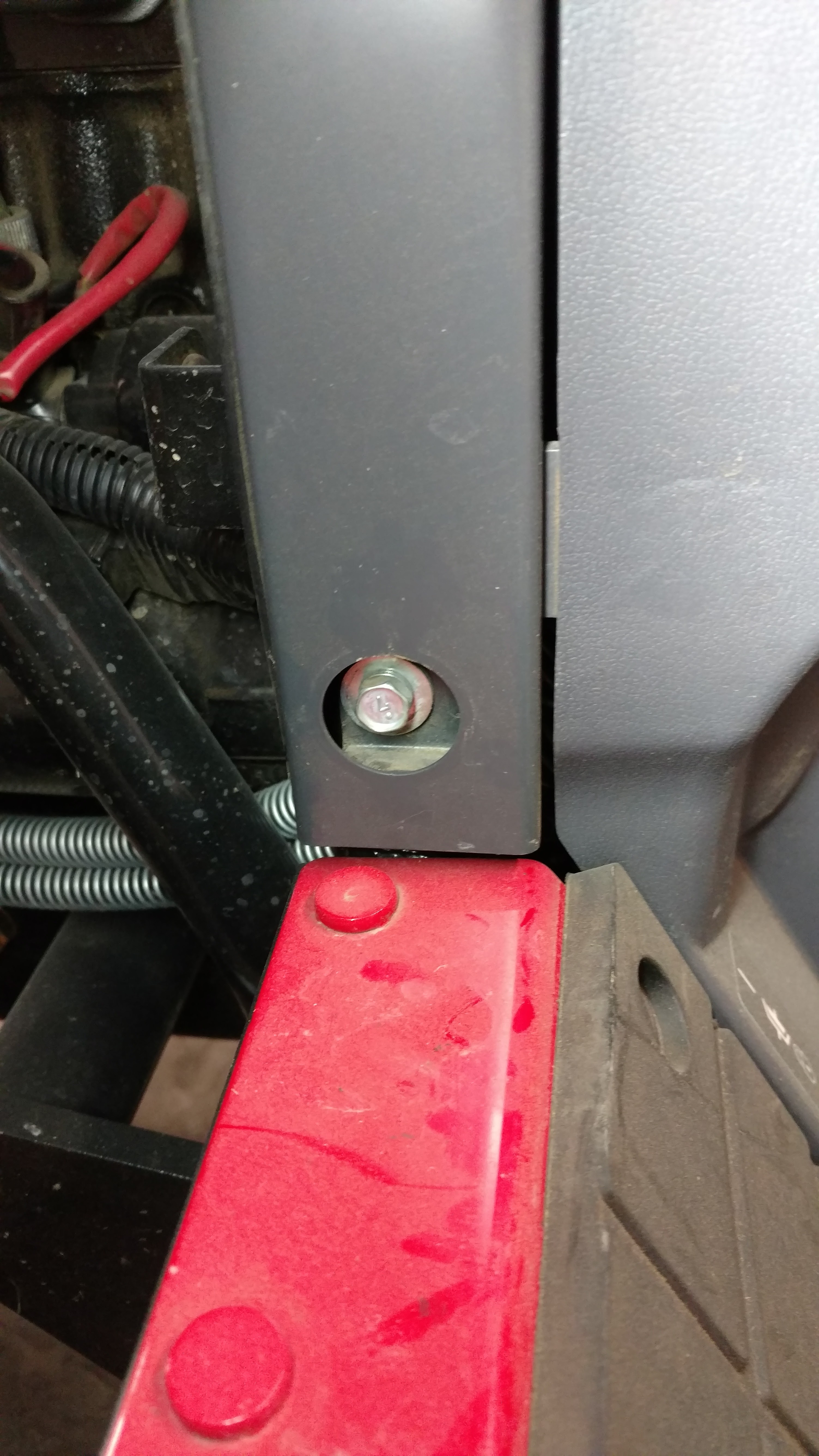

2. Remove 2 grommets and remove 4 bolts to remove the firewall cover (10mm socket)

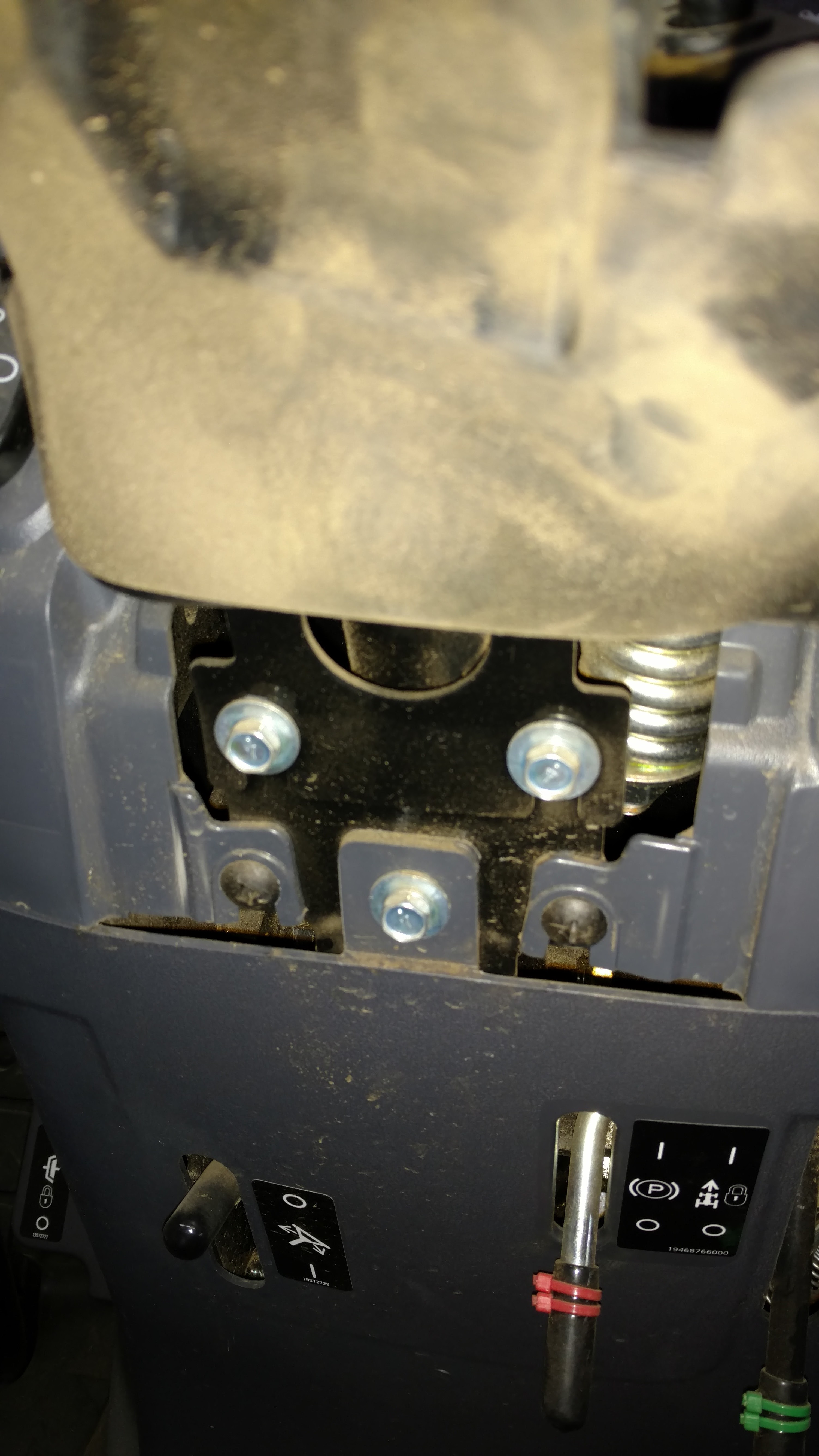

3. Lower the hood and remove the 2 instrument panel bolts (10mm socket) Also remove the gas tank cap.

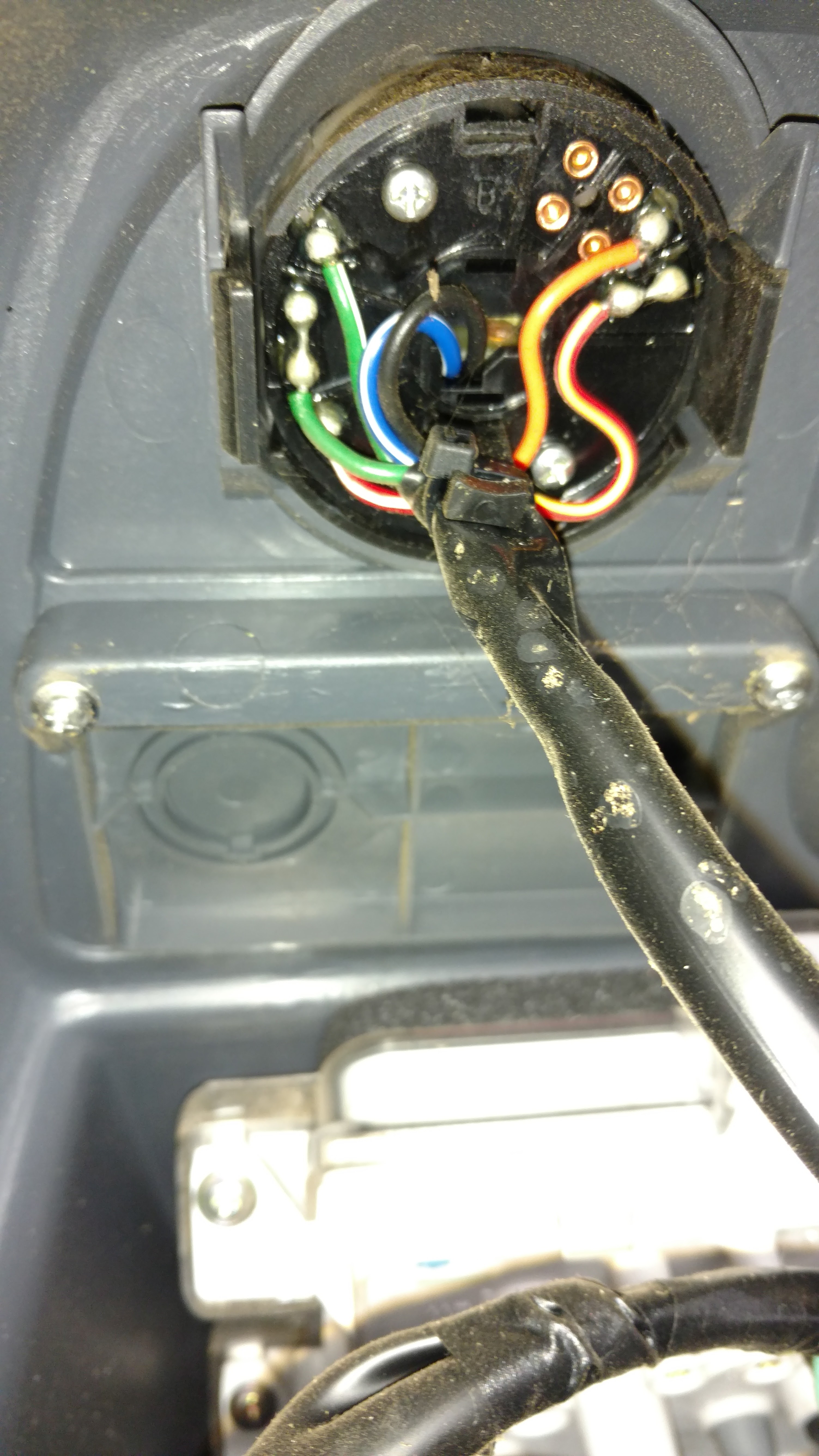

4. Lift steering column boot and remove 2 Phillips head screws from instrument panel (#2 screwdriver)
5. Standing on floorboards, lift each side of instrument panel over the steering boot and column

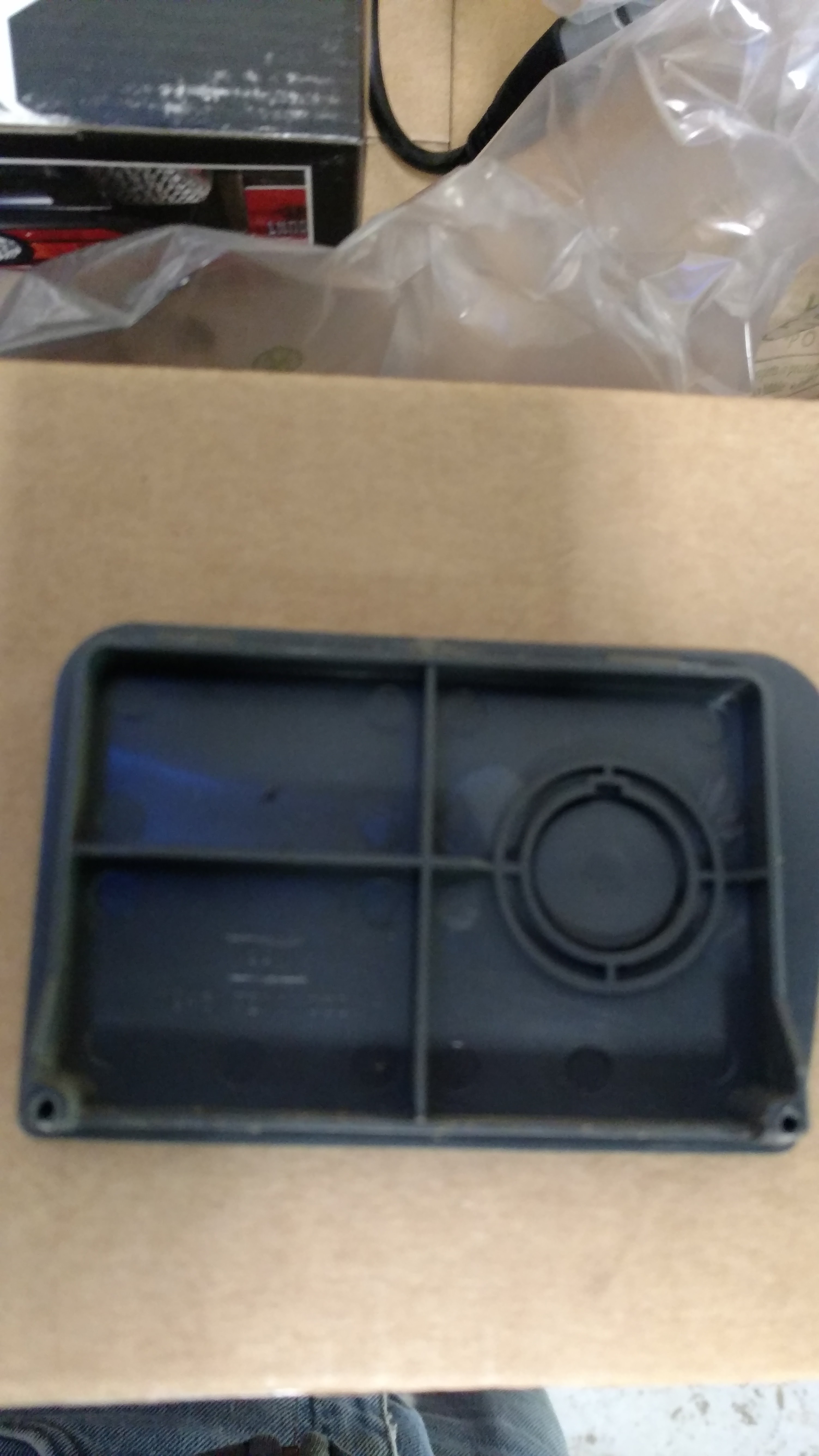

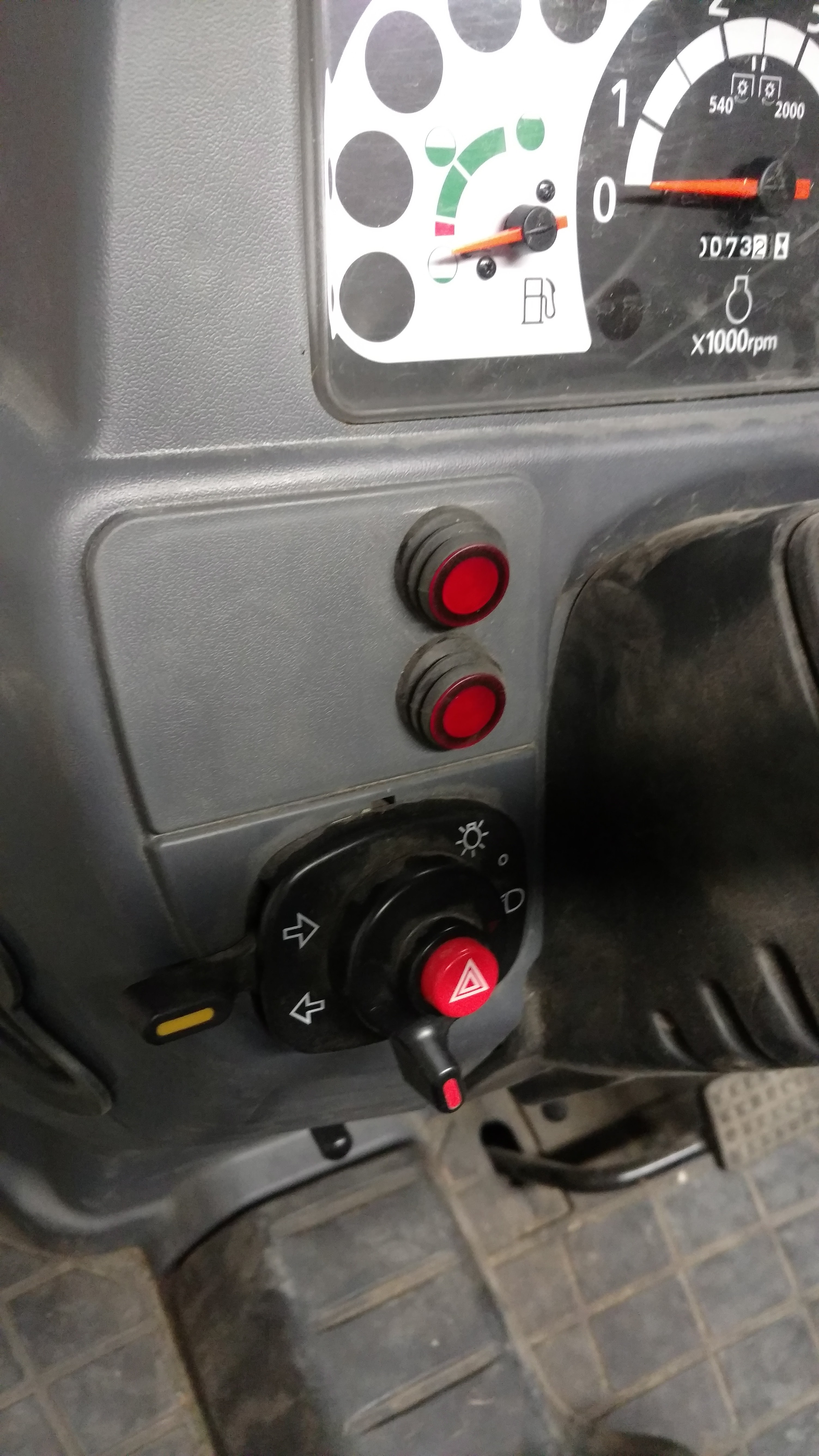

6. Remove 2 screws from the underside of the instrument panel to remove the auxillary switch panel (#1 screwdriver)
7. Drill holes for new switches in the auxillary switch panel (mine were drilled 3/4")

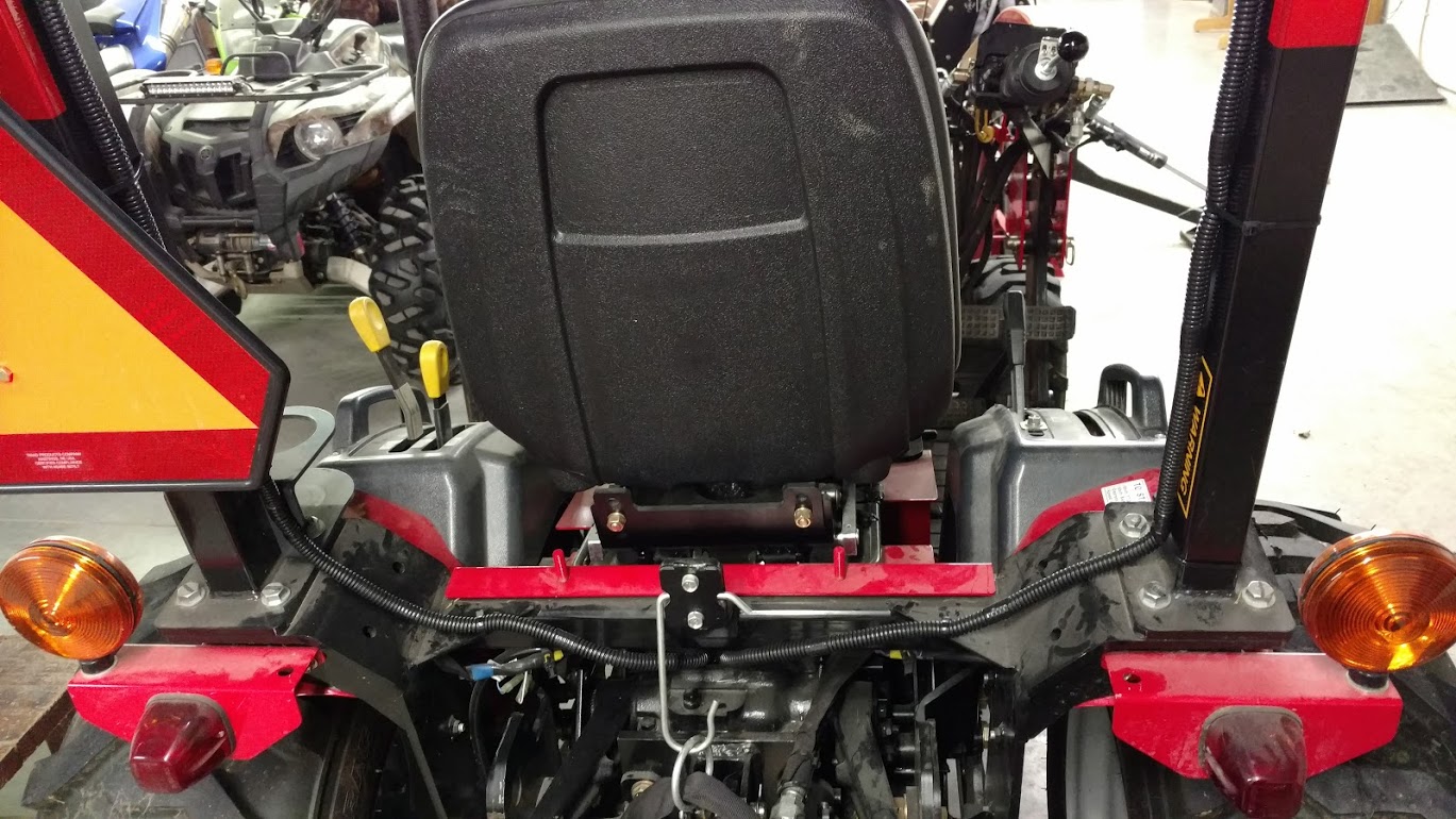

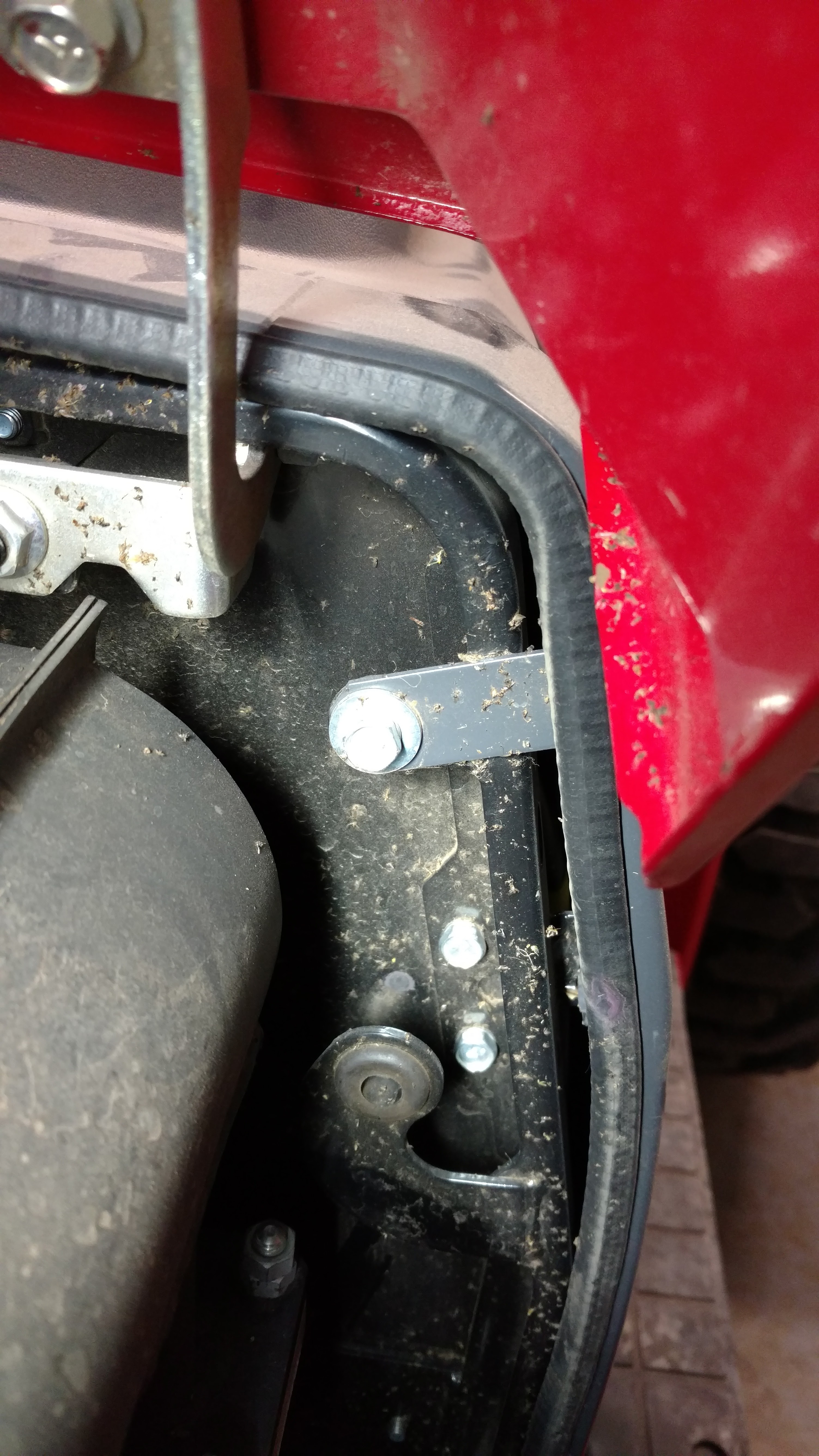

8. Depending on your lighting system harness you now have to route the wires to the battery, and to the lights. I didn't take pic's because I'm sure this will be different for every harness. I used the existing grommet in the firewall for factory wiring to run to the battery. I ran the wires for the switches straight down behind the steering column cover, under the rubber mat on the floor board, and then under the fender and below the seat mount, and then split to each side of the ROPS for the lights.
9. Reinstall the auxillary panel into the instrument panel, install the switches and connect the wiring. Connect the wiring to your lights and battery. Reinstall the instrument cluster, steering boot cover, firewall cover, side covers and hood.

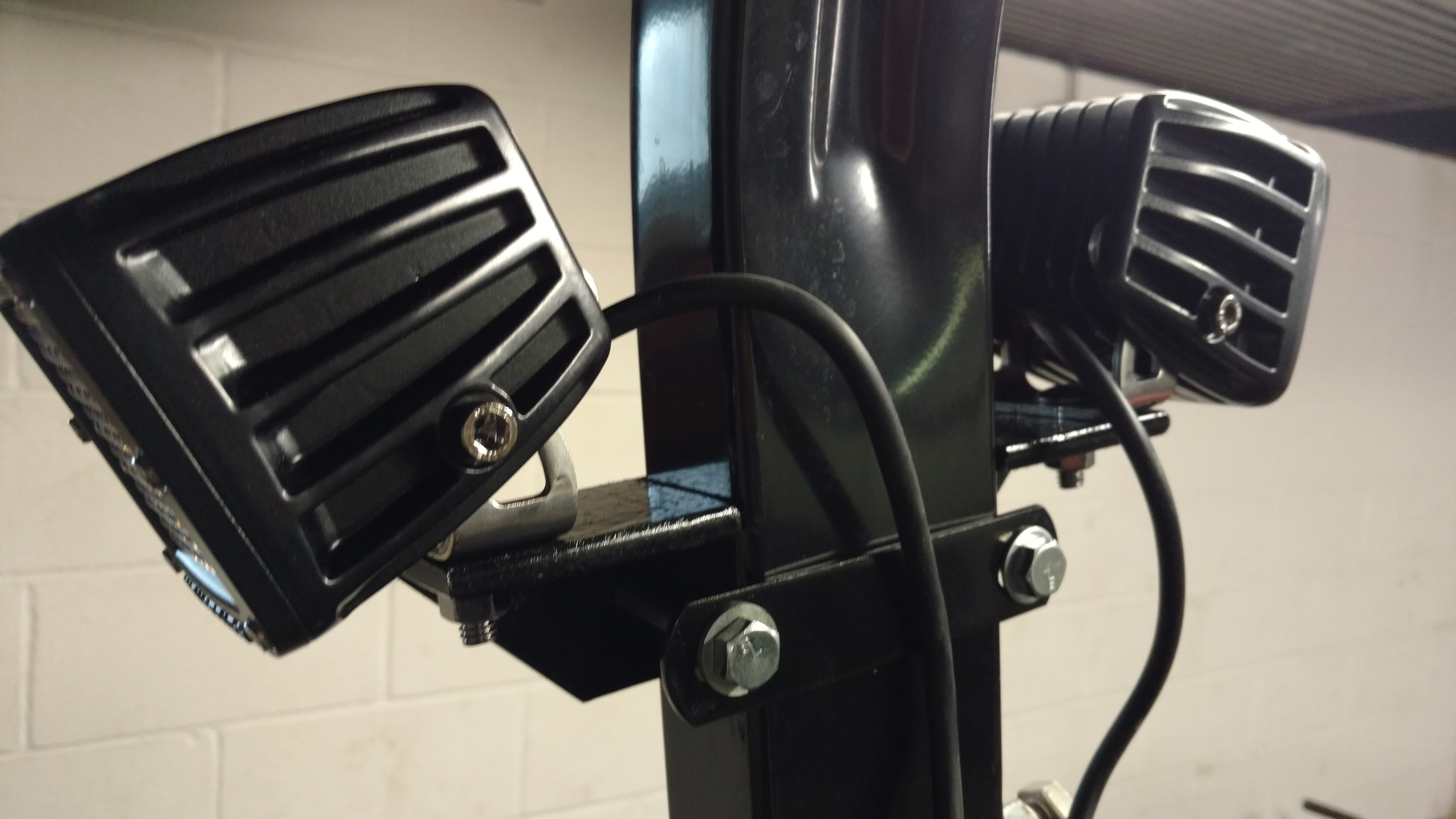

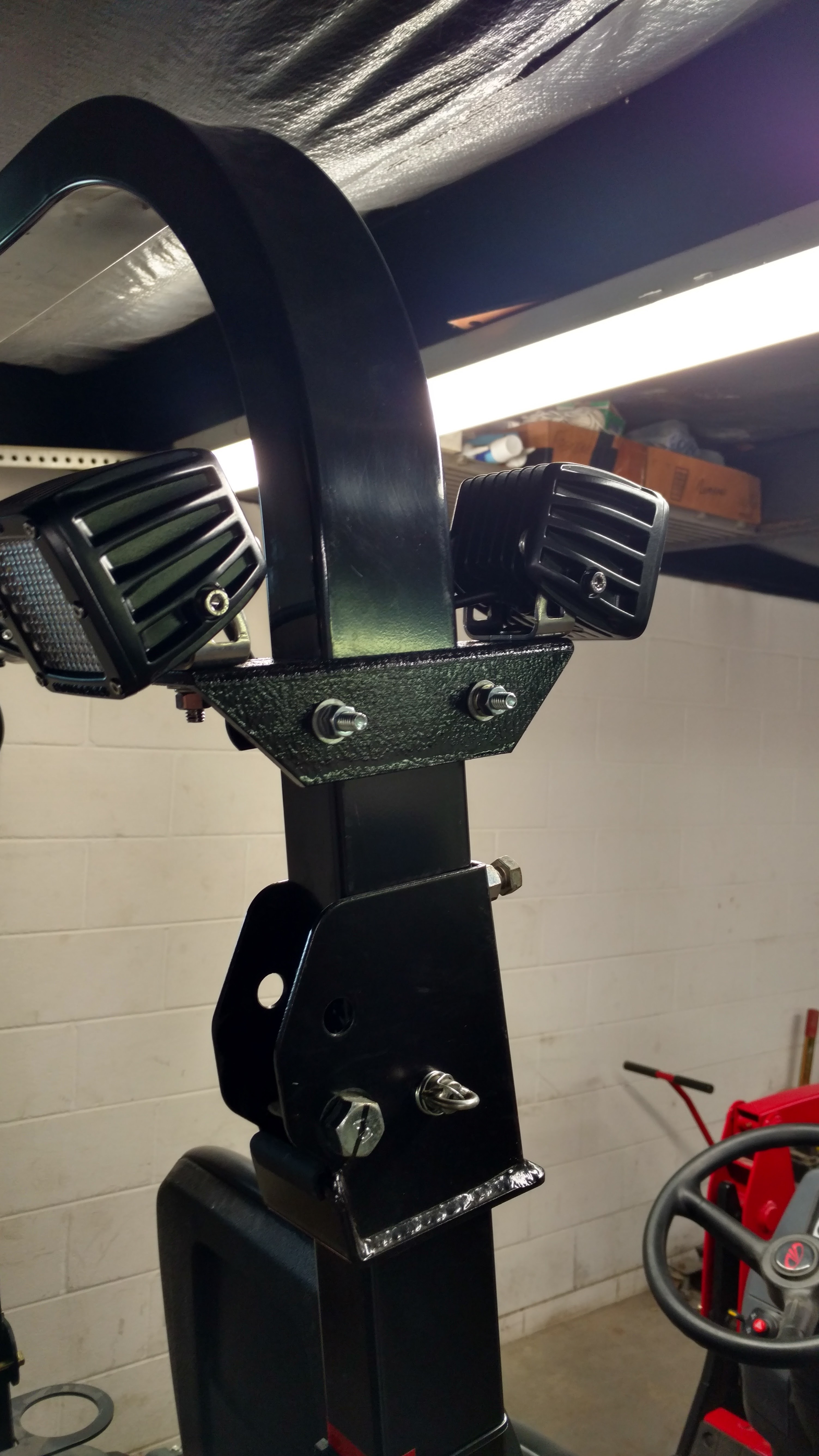

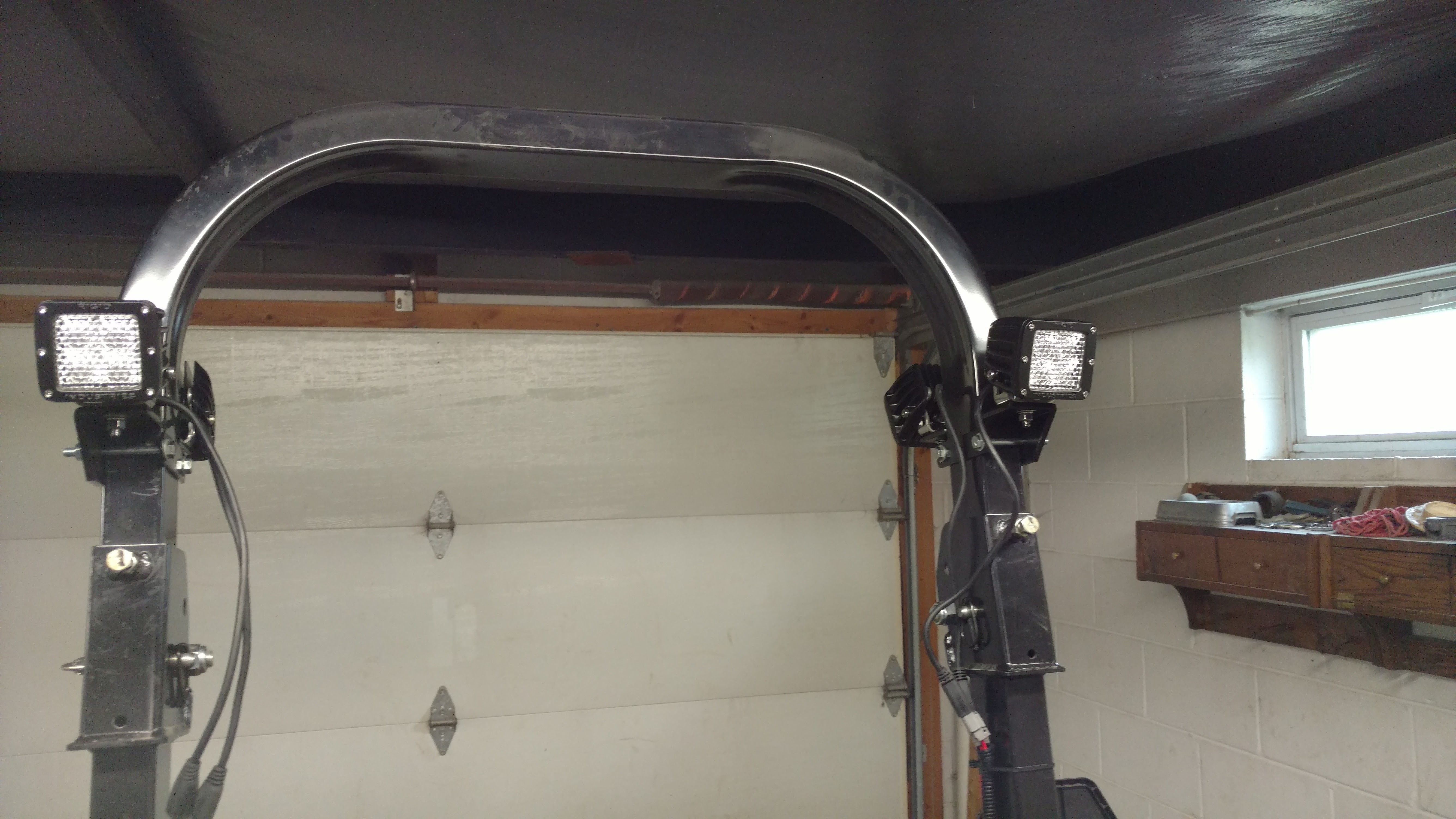

10. Light mounting on the ROPS is another story. I work with fiberglass reinforced plastics so I used 2 pieces of 2" x 2" x 1/4" angles, notched them to fit over the ROPS, and drilled the light mounting holes. Rather than use U-bolts, I used the flat plate that comes with a u-bolt and two 5/16" bolts to mount the angles. Here's a pic of my light mounts and switches.
The lights are Rigid Industries Dually LED lights with the diffused lense. I also used wire loom to cover all of the exposed light wires from the floor board back and zip tied them to the ROPS, except for the upper sections so they are flexible when lowering it. I'll have to get some before and after pic's of the lighting difference and post up later.

I had originally wanted an LED light bar on the center of the ROPS but in messing around with an LED worklight just held in place there it pretty much shown right in the back of my head and cast a shadow of me over the tractor and several feet in front of it, so I went with the Dually's mounted on each side of the bar instead. I did notice that when you look to the side or turning to look backwards they are glaring bright in your face. But I typically wear a hat so a minor head tilt blocks the majority of it so you don't get blinded. I had considered installing the rear ones next to the factory tail lights but much of the light gets reflected and blocked by the backhoe or blade. It seems the higher the better so the ROPS was the best option I came up with for front and rear facing lights.
By the way, when I said I routed the wires below the seat mount I guess it's more like under the fender body directly below the seat. They are pretty well protected there and are not in the way at all for turning the seat for the backhoe.
Rigid Industries lights are a very simple plug and play system. It comes with the illuminated switches, battery terminal connections, inline fuse, and the plug in connectors at the lights. In my opinion Rigid LED's are top notch and quick and easy to install. They are expensive but I think they are worth every penny. I just spent a few extra dollars for the wire loom to protect the wires and have a cleaner appearance anywhere they are exposed.
