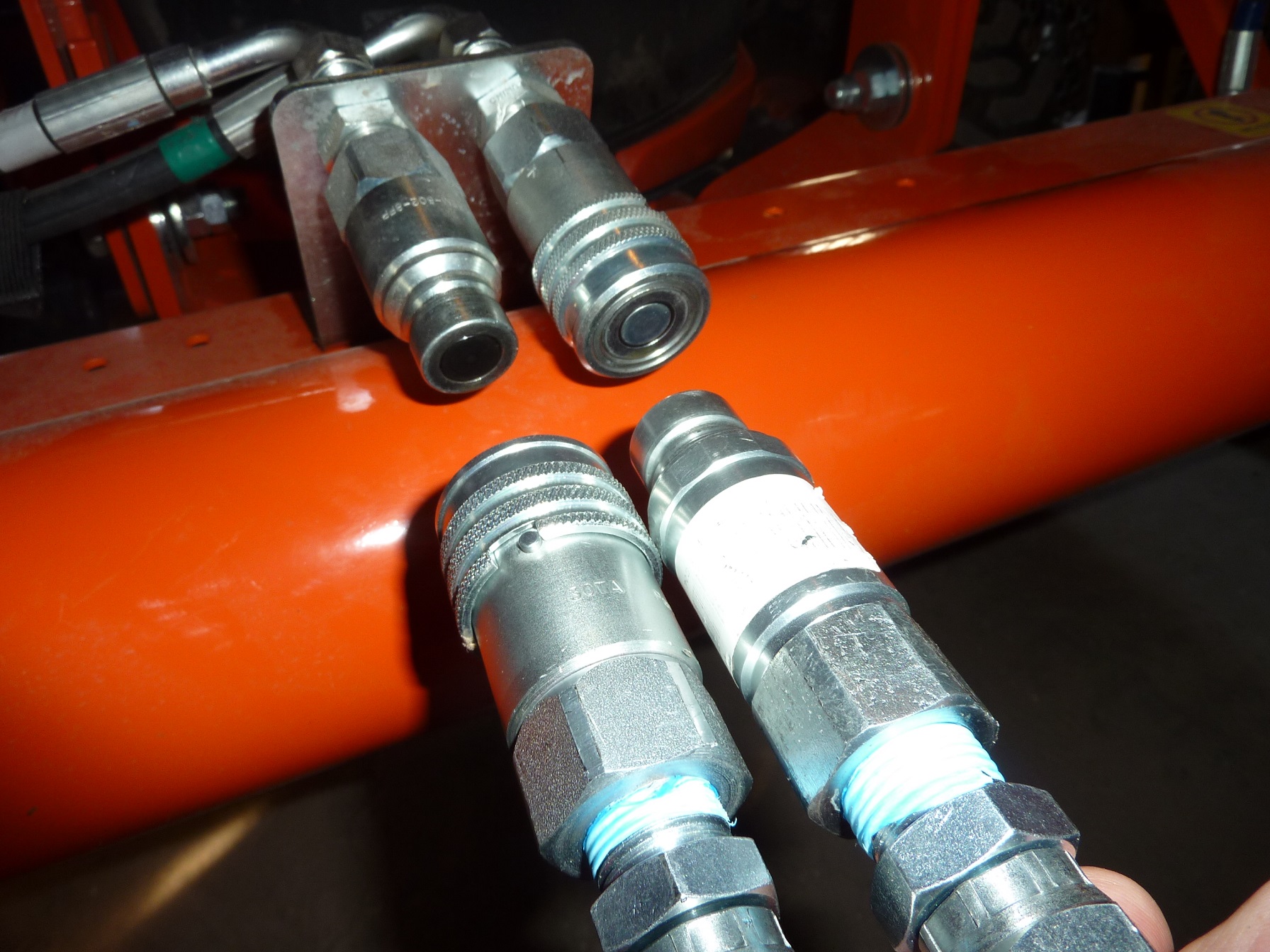

All the Kubota dealers I've dealt with over the years seem to prefer flat faced hyd. couplers on the 3rd function valves and FEL mounted implements they sell. IMO, flat faced couplers have some advantages. They don't load up with debris, don't leak much oil during connection, are easily cleaned with a rag and don't require protector caps.
They are expensive though and are prone to pressure binding. The pressure must be completely relieved on both sides. For my Kubotas, Relieving the pressure on the tractor side requires lowering the FEL to the ground, shutting down the tractor and working the FEL valve in all four directions while holding the 3rd function valve open. I sometimes have to do this multiple times.
My implements are more of a challenge. Even though the pressure is relieved after disconnecting, it always builds again due to temperature changes, cylinder bleed down or movement of the implement itself. Most of the time, I have to loosen one or both of the hose fittings to bleed the pressure off when connecting again. To me, this is a PIA and defeats the purpose of the leak free coupler design.
Am I missing something here? Do other users of flat faced couplers have similar problems?

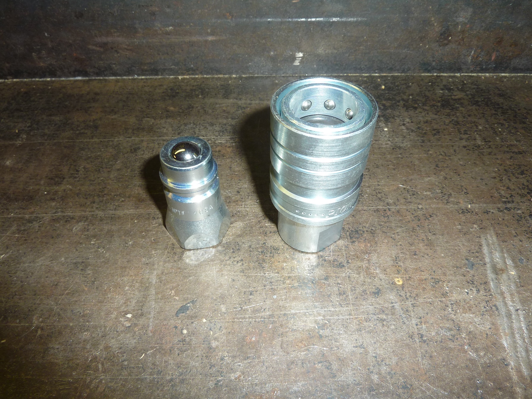

I've been thinking of switching to the Pioneer style with pressure check on both sides:
Before I spend considerable $$ to convert two tractors and several implements, I'd like to know if they will be any better. I'd appreciate the opinion of others here.

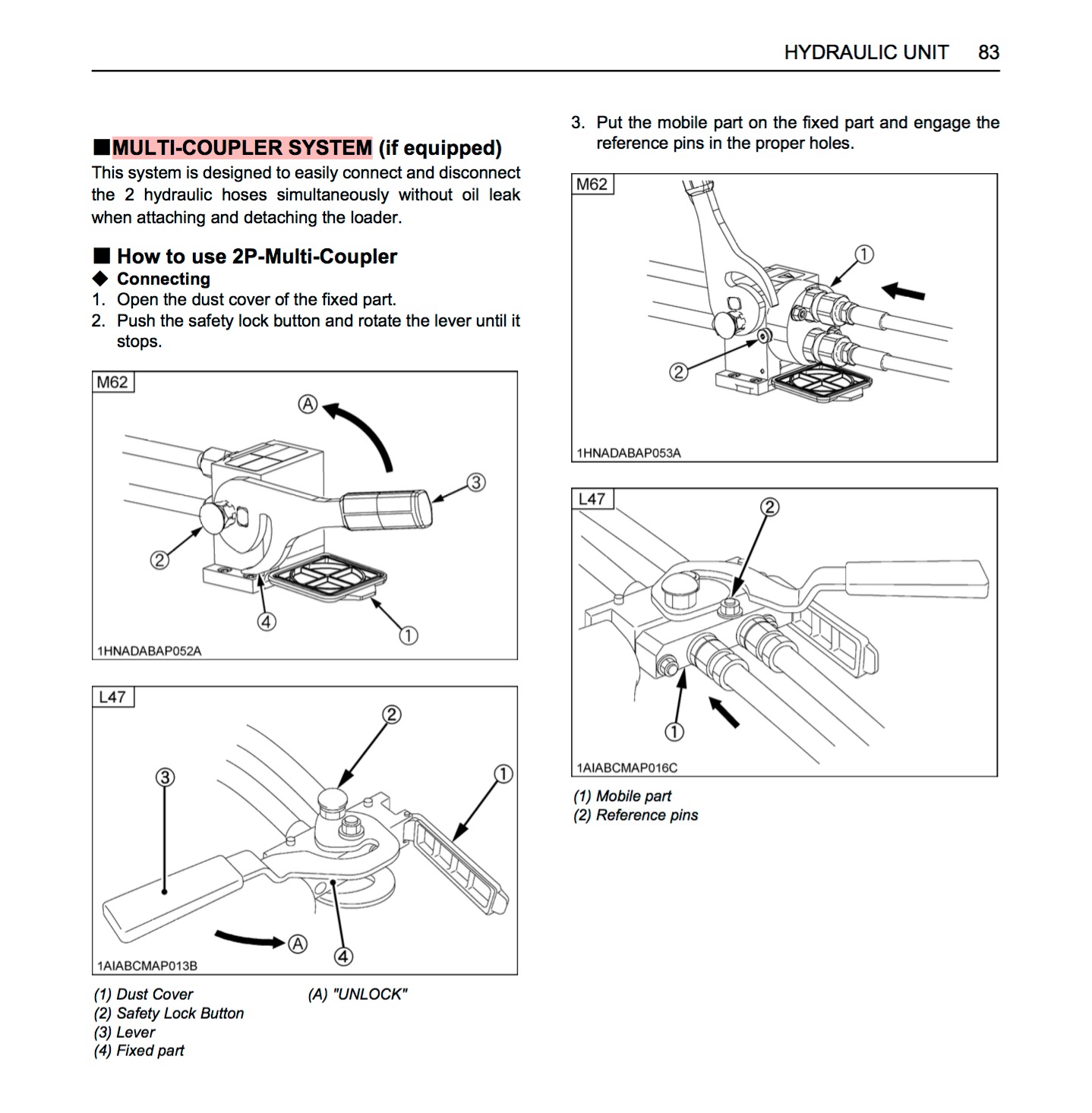

Has anyone tried the new M62 MULTI-COUPLER SYSTEM?
My solution has been to power off the tractor and leave the hydraulic remotes on float to relieve the pressure in the implements. The biggest problem I find is when the implement has been sitting outside in the sun especially if I disconnected it earlier in the morning when it was cool out.
