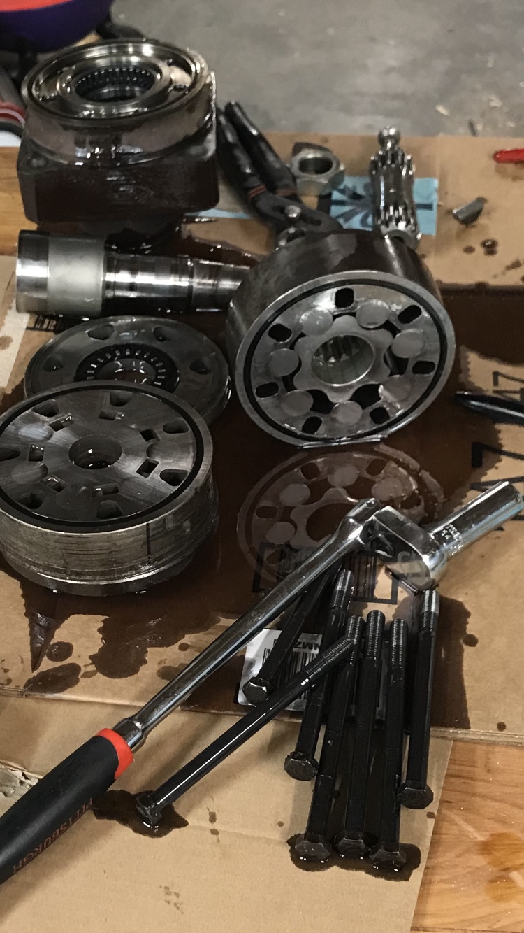

I just put seals in my Grasshopper motor. What’s your background working on stuff? An experienced wrench turner could probably do it. If changing a flat tire or changing spark plugs would be challenging than move along with plan b. IMG_1575.JPG

hey thanks to all of you. yes it's hydro gear commercial grade. i'll check out the schematic on line, just not sure how far i have to tear into the hydraulic motor to get to the seals, etc.
have machining & mechanics bkgrd, so will proceed step by step....or let my good small engine guy have a look
