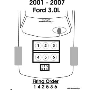

Buddy has this car, it is showing a misfire on 3... which plug is 3?
With hood open, 3 plugs are easy to get to, 3 back ones are under the intake.
Thanks
   / 01 merc sable,wich plug is 3? #2
if its the 3.0L V6

yep.. it's the 6 cyl. not sure how i missed putting that in.
thanks
I see we will be pulling his intake to get it. ;)
