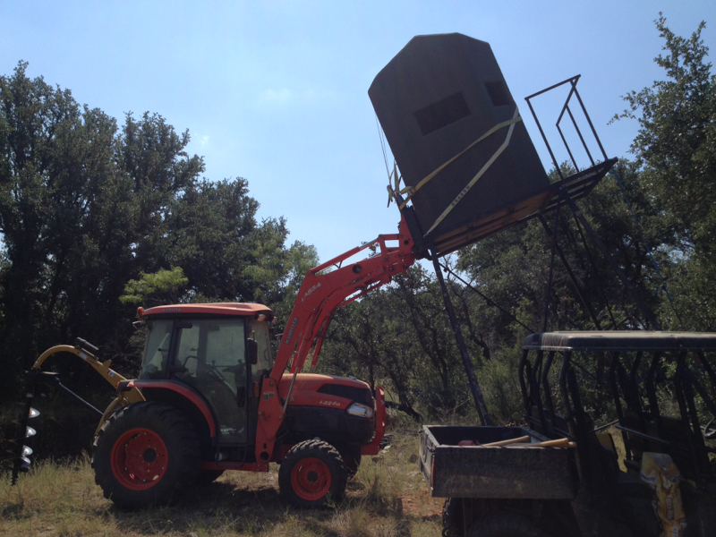

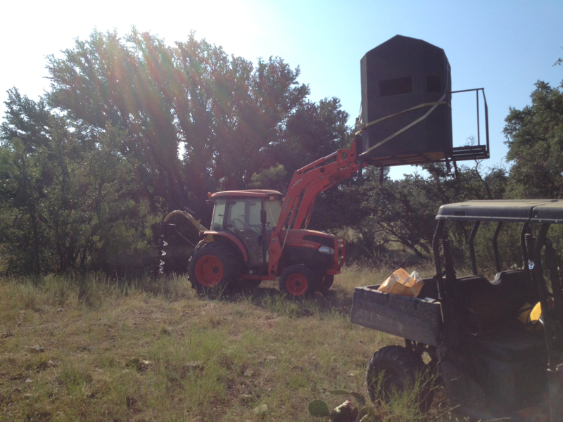

Well, 1 man and a tractor. Would have been easier if I had just 4" more lift on FEL...

Max lift
Finished product

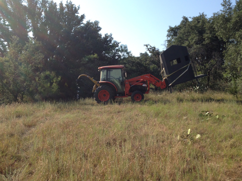

so how are your nerves after the final push to get it upright?

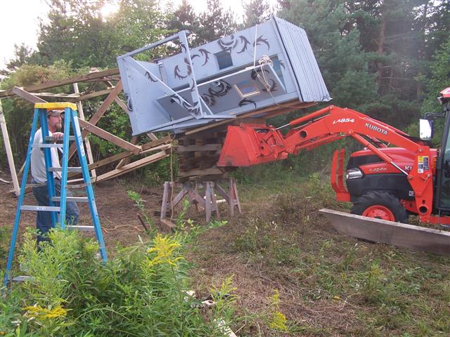

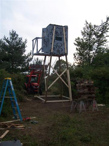

Mine is 14ft.to the bottom.Much bigger project that anticipated.Fortunately I had lots of help.

Next year set a couple pallets or 4x4's across your forks first to give you the extra 4" lift you needed.
Nice setup.
Ugg. Why didn't I think I'd that!!
It really wasn't that bad. I used a tether line on the Ranger so once I dropped the forks down I hopped in Ranger and slowly inched forward for a soft touchdown.
Hardest part was dealing with the heat. I found myself in the tractor cab just to cool off.
