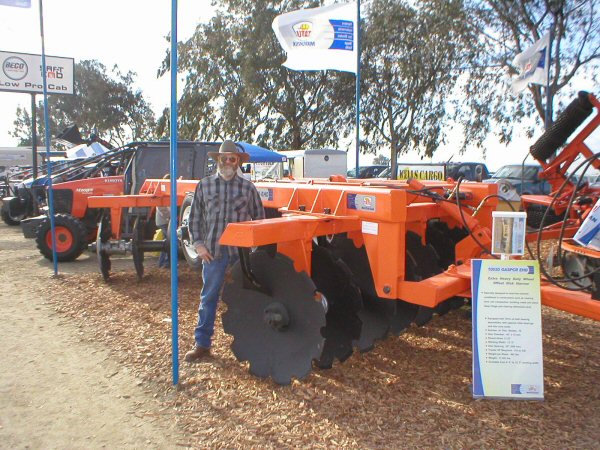

Before going to look at a Ford 10' offset disk I would like an opinion if my 83 hp 4wd tractor is enough?

With it being 4WD I think you will be o.k but I guarantee you it will be all it wants. Do you know what size the disc blades are?
   / 10 foot offset disk #3
It should be fine. My 70 HP tractor pulls an 8' offset set wide open quite easily. I used to have a L3650 (36 HP) that would pull it in 4WD and low range.
Besides, you can always gear down and take your time.
   / 10 foot offset disk #4
The width of the Disc Harrow does not relate well to the draft force generated in pulling.
The important metrics are PAN DIAMETER, (A=πr2), where the weight is, and the NUMBER of pans.

Depends on the weight of the disk and size of the blades and a photo would be great. You probably could pull it.

Not all offsets are created equal. Some are super heavy and aggresive and designed as primary tillage tools. I have thought of a 10-12' offset but wonder if my 135 HP 4440 with duals will pull it. Some it would I am sure but some it wouldn't.
   / 10 foot offset disk #7
Here's one at 992lbs per disk. Can be had in 9'-12' working widths. Something tells me that your tractor isn't quite enough.
