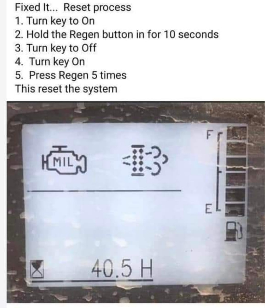

JUST curious, have you tried this procedure to reset the DPF controller?

Where did you find that reset procedure? I am sure my dealer never did that in his 20 visits. I anxious to try it. Thanks.
