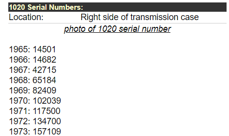

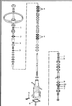

You can try to stop leak below steering wheel by replacing seal at the top of PS housing. I'm guesing you will end up having to disassemble & install a complete seal kit part # AT315816 . I hate to be the bringer of bad tidings but JD didn't build any 1020's in '75.

That's the same unit my 2240 has. I tried rebuilding it with no success, but, mine had other issues. A bunch of the thin shims were broken. I ended up buying a new unit to the tune of about 850.
You will need a very long set of o-ring picks and a lot of patience.
   / 1020 Hydraulic fluid leaking out the top of steering column. #4
The 6 large o-rings will try ones patience when someone R&R's them. Getting new o-rings is correct locations is very tricky.

Also Tx Jim, tks for the clarification on the date mfg. Nice to know it's a 73 model. Now to change my info.

You ever get yours fixed? I did a top end only on mine this past weekend. I did it on the tractor. Took off steering wheel and the large nut. Then the inner nut. After that the steering valve assembly just screws out. It's a jack screw kind of thing. Took me about 2 hours to dig out the old seals and replace them. They were hard and brittle and came out in pieces. Getting the valve back in was a pain. I had to take a wood block and a good size hammer to drive the valve body past the new seals. Once you get it in far enough for the screw to start catching it's threads I had to use a large set of channel locks on the shaft with a rag wrapped around it to screw it back in. Screw, hammer, screw till it was in far enough to screw the retainer all the way down. Large nut back on, new seal on top, and steering wheel.
Problem solved. Hopefully it will last another ten years.
