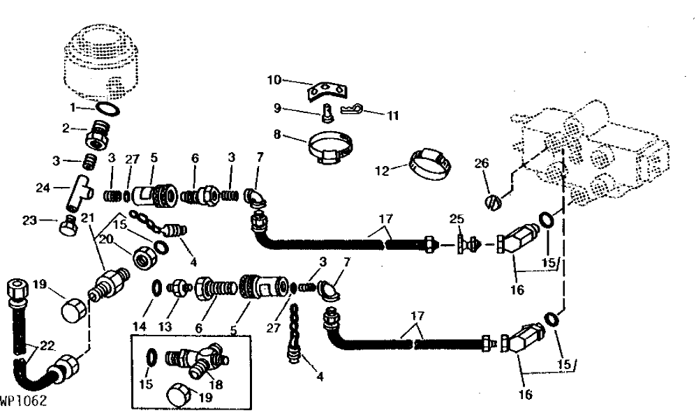

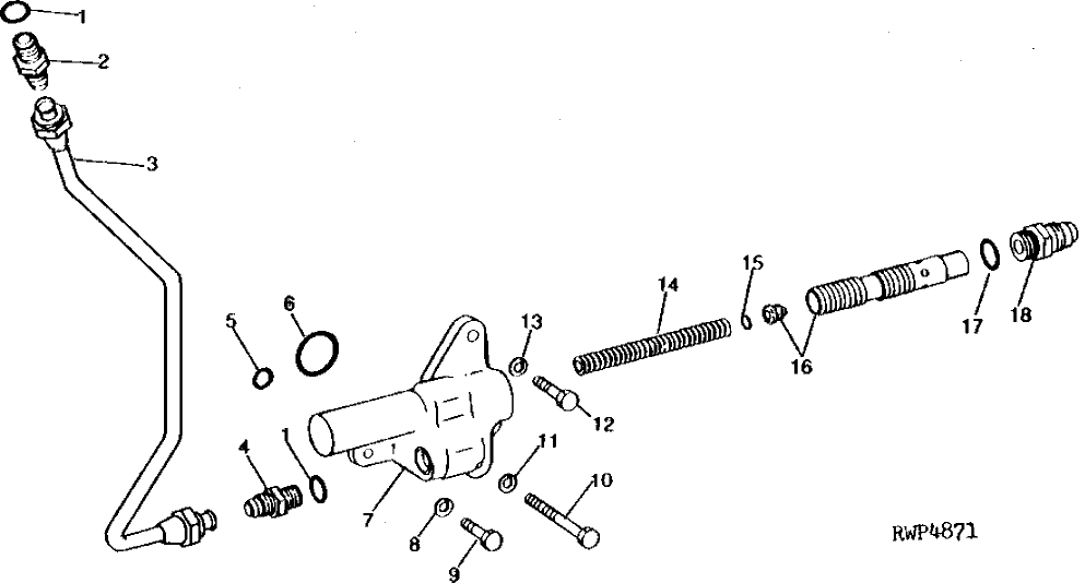

I'm wanting to put either a single remote or a double but in the future I'm also goin to install a loader but I don't want them to use the remotes goin to use just wanting to see if anyone knows or has directions and pics to install I'm goin to use after market control valves thanks again all help is appreciated
   / 1020 John Deere wanting to install remote hydraulics #2
Be sure to get CC valve or install CC plug in the valve. On FEL valve route return oil to a hyd filter ported cover. Rear remote(scv) can get pressure oil from hose(parts key 22) and have return oil tee'd into ported filter cover. Loader valve gets pressure from fitting(parts key 21) that would screw into pressure control valve(parts key 7) which is close to hyd filter above tractor SN 045200-. You could add a port to the tractors existing hyd filter cover in lieu of buying a ported filter cover. There's a serial break at 045200- which these tractors has a pressure control valve while tractors before that serial number use tee fitting(parts key 18).
HTH's Jim

Salvage yards are full of those Dubuque and Mannheim tractors with SCV . A simple bolt on upgrade. When plumbing in the SCV . May as well return it's oil to the ported filter cover instead of into the transmission sump. Attachments such as log splitters and hydraulic motors will operate much better.
Odds are the tractor is equipped with the 1000 series pump in the 0.7 1.4cubic in displacement . Can you see any numbers and if there are four or eight "nut caps" around the body of the pump?
The 0.7 is rather low in capacity for loader work. The 1.4 is ok but the operator has to plan ahead and start lifting early . The 2.4 is the premo pump for loader work but does not appear to be on the 1020 option list.
