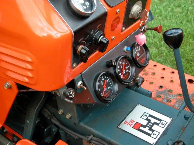

I added an oil pressure gauge, a voltmeter and a temperature gauge to my old B8200 for under $20. The sending unit for the temp. gauge installed in a plugged hole in the thermostat housing, using a metric adaptor that came with the gauge kit. It was an easy, and I believe fairly accurate, way to monitor how the engine was running. Look your cooling system over, and see if there isn't a place to screw in a sending unit?

That looks really good varmint. Do you remember the source of the gauge kit? I looked over the engine quick and found a couple screws holding nothing together on the cooling system. I think one of them might be a bleed screw. Ill try pulling those and see what comes out. You did a really clean install of those gauges.
