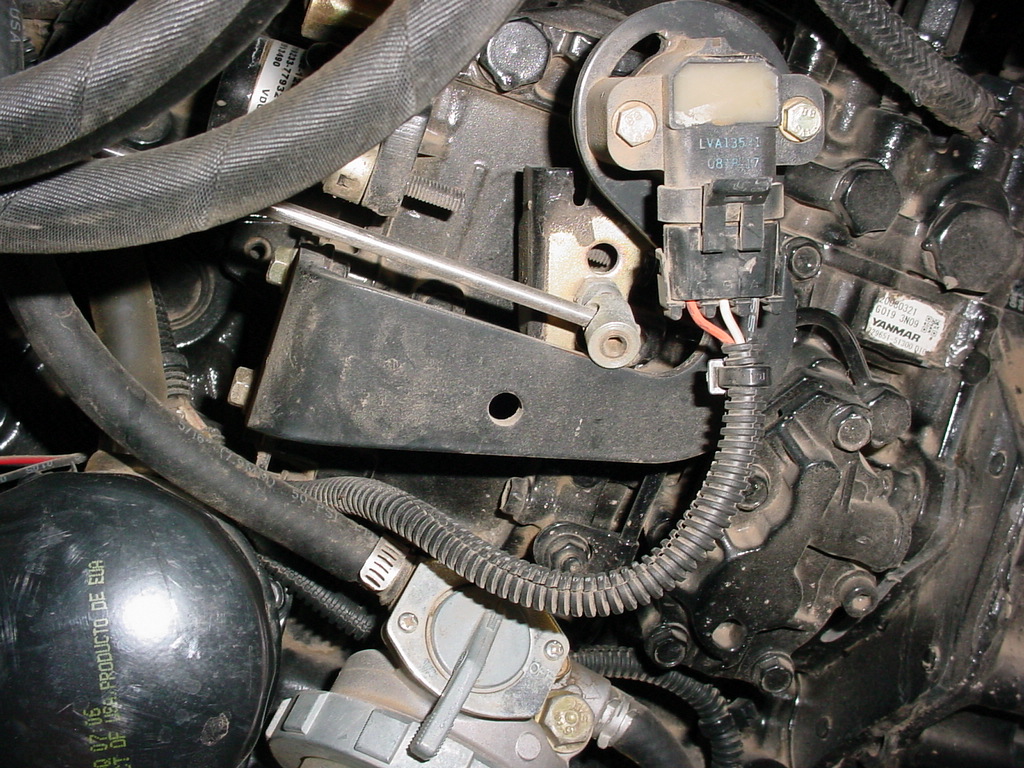

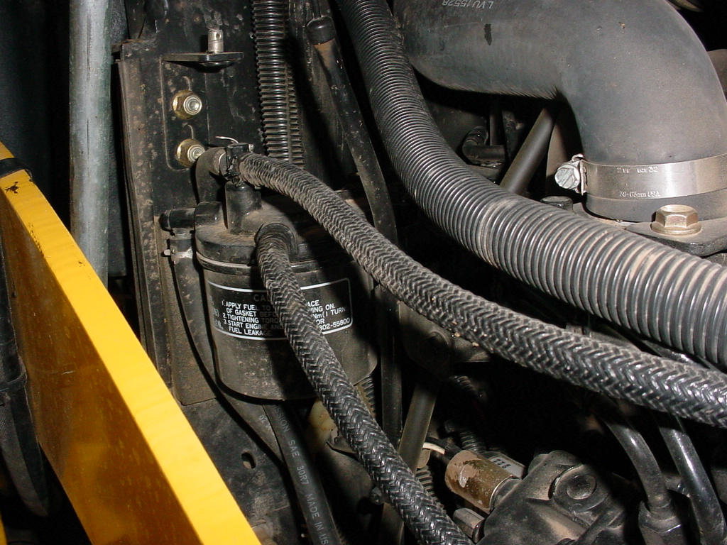

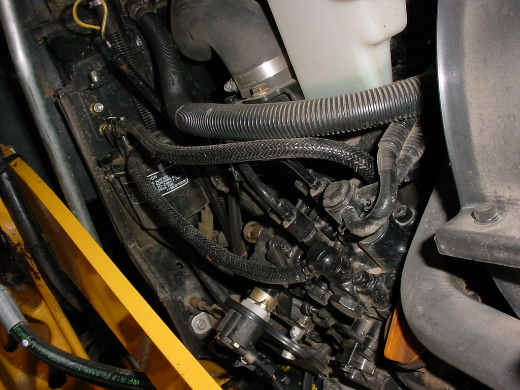

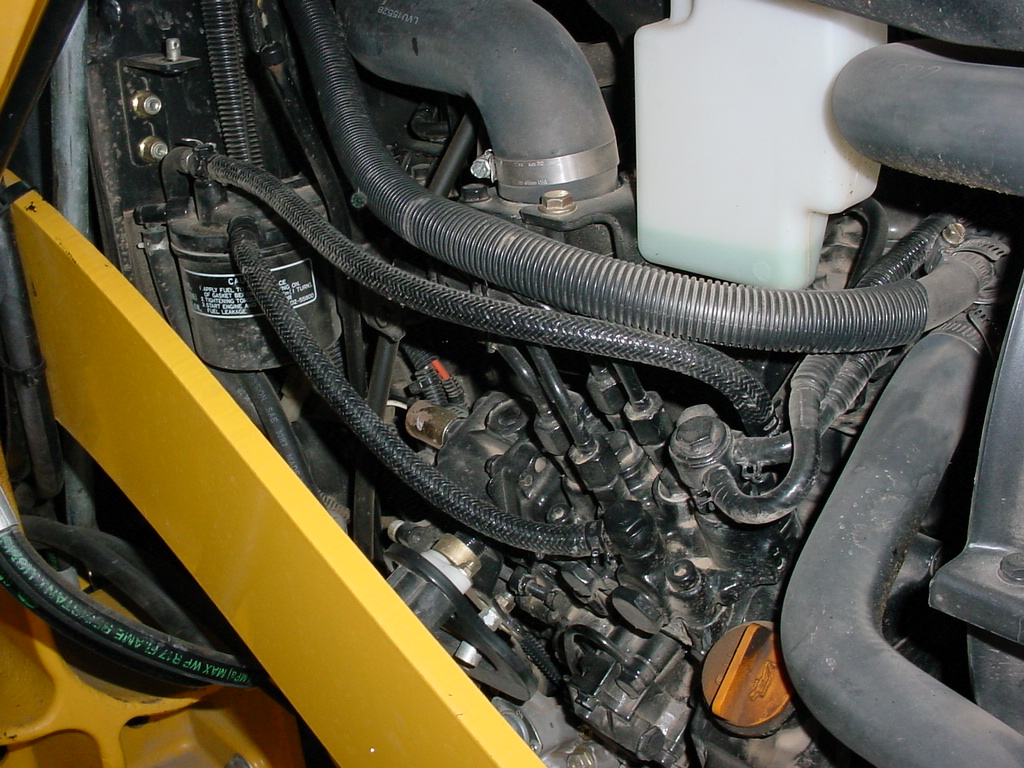

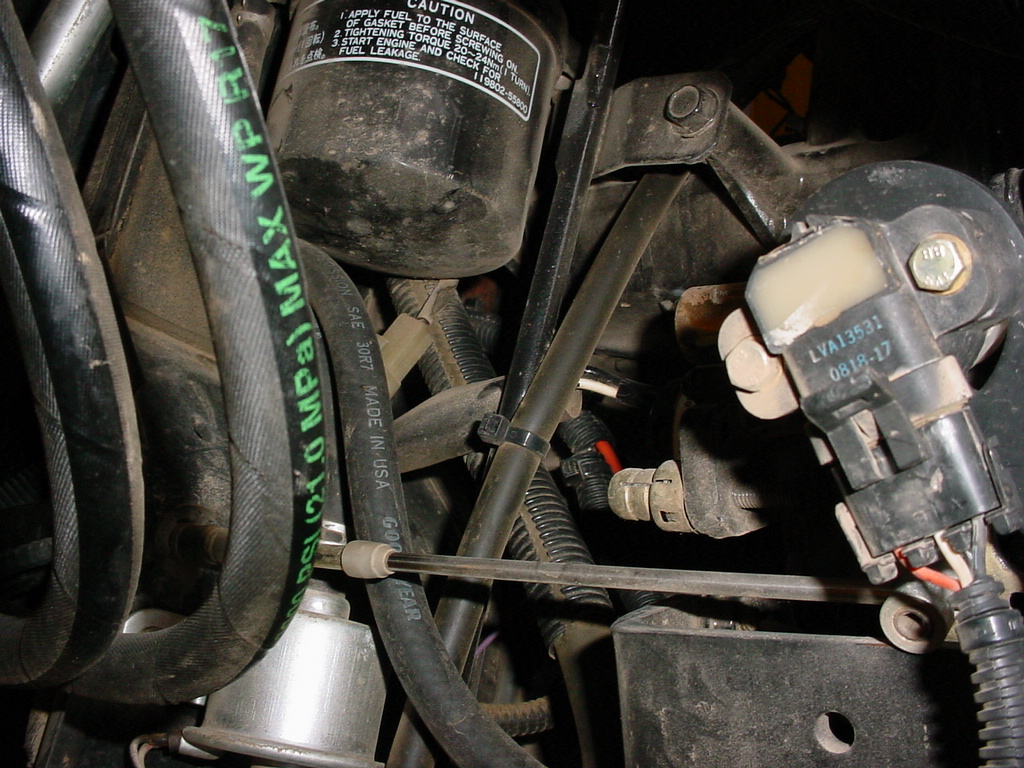

My 110 TLB is a 2004. Currently, I only have the one combination fuel shutoff/water separator/filter assembly. From a later, 2007?, I just bought the separate spin on fuel filter assembly and fuel shutoff/water separator. I'm now seeking images of the later setup for mounting and plumbing this setup onto mine.
If anyone can supply images of the entire setup, close ups of mountings, measured hose lengths, I'd appreciate it!
   / 110 TLB Fuel Supply, Pump, Filter, Shutoff, Water Separator. #2
If you need more let me know
