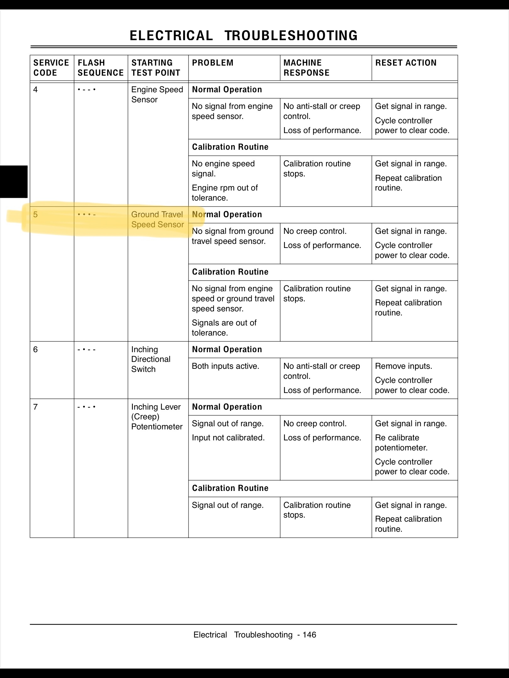

Hello, I have an 04 110TLB, serial #LVO110T312292
I’m having issues only when hot in which the transmission stops workin. In arizona, so hot a lot.
It has been years trying to fix issue with dealership service shop and reading on here. The codes are mostly #5, ground speed sensor but sometimes others. Tested continuty for seat switches, fine and cowboy rigged so thinks always sat upon.
Here’s the hitch, shop says it was not equipped with a ground speed sensor?
there is a hole for it and a tapped screw hole but I cannot find the wires that it would plug into?
don’t really want to spend the $ to replace HST controller if not the issue.
Equipped with sensor?
Thanks for any guidance I can get.

The MFWD sensor was an issue on the 4x10 machines, which the 110TLD was based on, strange things happen when it fails. Never heard of a ground speed sensor.

I got lucky in that a $50 sensor purchase solved my issue…
I credit my luck to TBN as the dealer would have been into me easily thousands…

were all 110’s equipped with the sensor? I got a replacement but rdo says my 110 was not equipped with one? The HST ground travel speed sensor?
