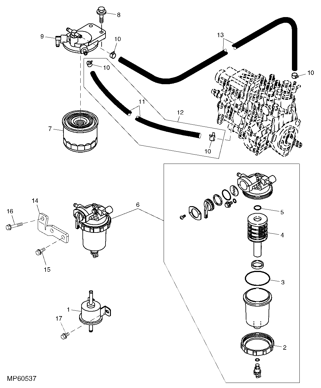

Hello. The 110 I use does not have the spin on fuel filter that sits on/near the firewall. (I also know of at least one other user on here that does not have the spin on filter) I am looking for a few pictures, or a drawing (does not have to be a good drawing...just correct and legible) that shows the order from the tank to the high pressure pump. Basically I would like to know if it goes from tank to supply (low pressure) pump (I am assuming the pump is before the filter and water separator) and then what is the order of the spin on filter & water separator bowl before the (now dry and filtered) fuel goes to the high pressure pump. As always thanks for any help, and there is no hurry, but it would be nice to get a response (or two) saying you'll check when you can. It should also be in the service manual under fuel system, for anyone that has one of those.
Once I know how it should go, order it, and HAVE TIME to install it, Ill post pictures for others that may want to add it to their 110tlbs, as the parts are not expensive, and your fuel can never be too clean....
   / 110 tlb owners, req pics/ drawing of fuel lines to add jd oem spin on fuel filter #2
Does this help? From JDparts catalog
It helps a little. Hose #11 would be from the spin on to the to the high pressure pump, but we still would not know if the line goes to water separator or low pressure/supply pump first. We could assume it goes to the pump first, but I hate to make assumptions when I can avoid it. Thanks for the response:)

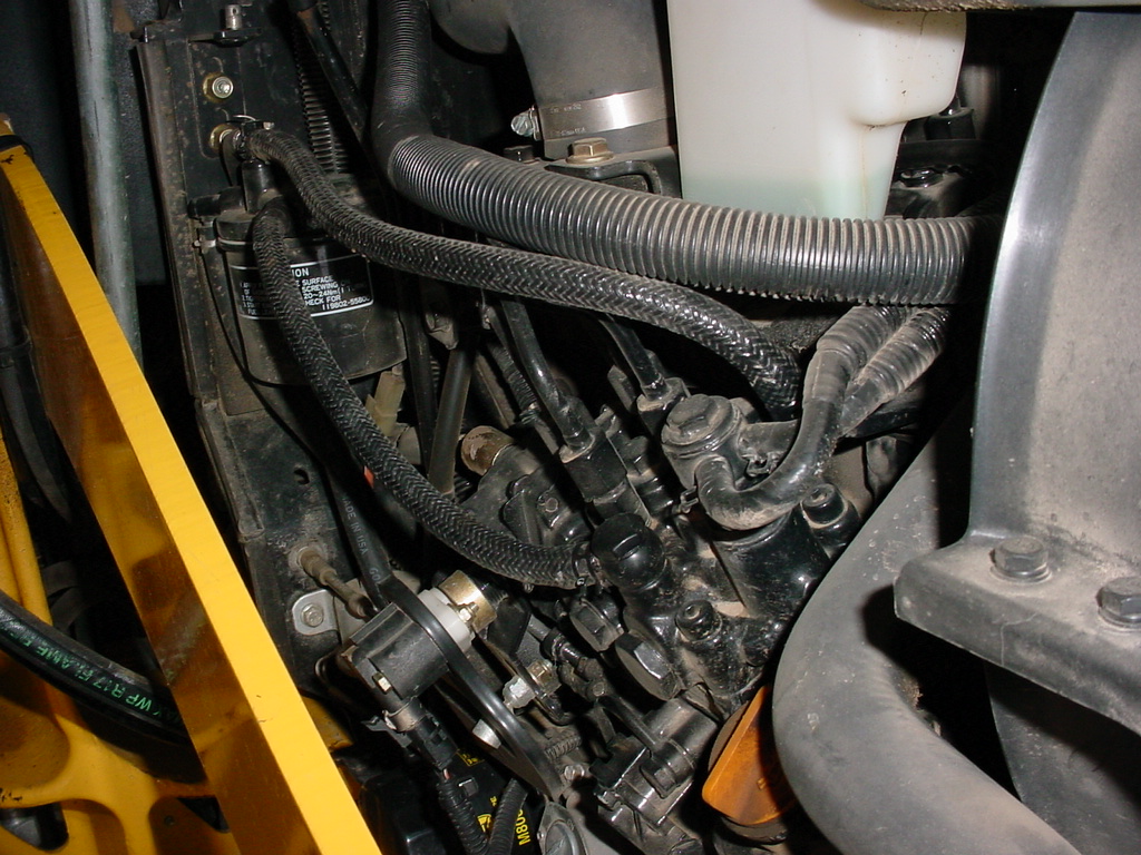

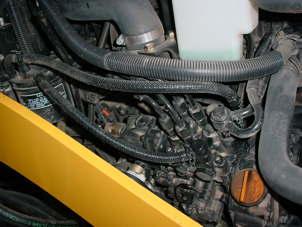

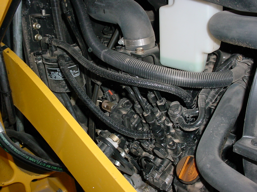

Here's the photos, I hope they help
