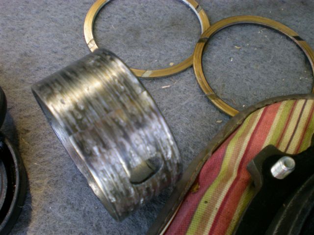

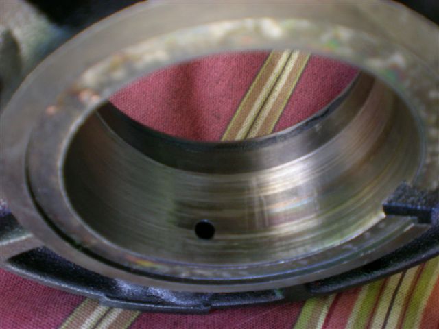

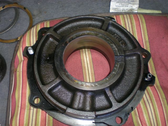

Grabbed some pics. Yes the backside of the bearing is pretty torn up.
I'm debating on whether to have the machinist build up the main journal and machine to standard to keep the relationship to the rear main housing as tight as possible.
If he machines the crank and I undersize the bearing, the outside diameter of the bearing is the same as a standard right?
Maybe better said, bearing just gets thicker to maintain relationship to undersized crank correct?
There is definitely wear in the housing and I cannot see where there is any tab that would maintain a relationship between the bearing and the bearing housing. I think it's just press fit and if that fit/relationship is marred then I would think I would be susceptable to again spinning the same bearing no matter how well I clean the journal.

If you don't have a service manual you can get one from Hoye along with the undersized bearings. It will give the tolerances on the bearing plate which the machine shop will need if you decide to go the route of repairing the plate and turning the crank.
You are correct in how the undersized bearings work. The outside diameter will be the same as a standard bearing.
You might want to consider comparing the cost of repair vs locating another bearing plate and replace the bearing in it or even the cost of repair against getting another used engine and taking the parts you need from it. There are a few dealers that keep used machines for parts. Either way the engine can be repaired, just depends on what method you want to go with. At this point of repair, I would go with rebuilding the engine as much as money will allow. The important thing to do if you keep the block is to get it flushed out thoroughly. Most of the metal from the bearing will have gotten caught by the oil filter but that means it also went through the oil pump to get there. The oil pump needs to be checked for wear tolerances.

Thanks fellows. You can probably deduce I'm a bit over my head but willing.
Found a local machine shop that is sending the crank out for repair. Just turning the two mains likely .030. When we receive it back we will order the bearings and check the fitment. Machinist believes the best option will be to sleeve the rear housing and we will be back in business. It's a slippery slope so I plan to do a thorough cleaning and reinstall staying out of the upper end even though I'm having to completely ignore the small amount of play that I've relegated to worn pin bushings.

Looks like the race just spun in the housing. The bearing might of froze up and caused the race to spin. The shop might be able to put a very thin metal sleeve in the housing and press the new bearing in tight. You could also buy a very good bearing (temkin sp?) and have it spot welded to the housing if push comes to shove. Good luck and a good machine shop will have a good solution.
