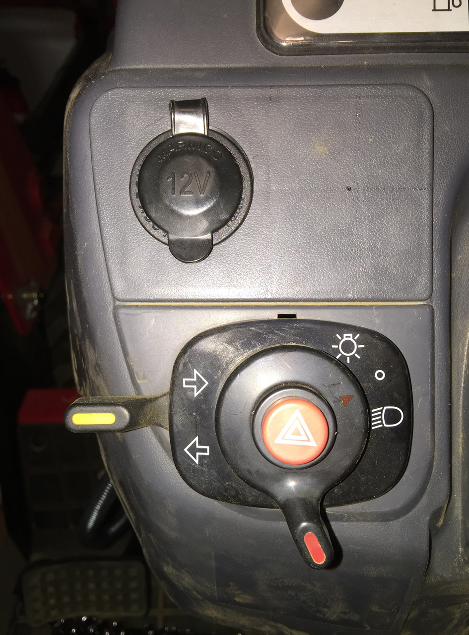

One of the minor annoyances about my Mahindra Max28 is that it has no cigarette power plug. This ranks right up there with the lack of a cup holder.
So, I've installed one onto the left side dash control overlay cover plate. IMG_5245ts.jpg

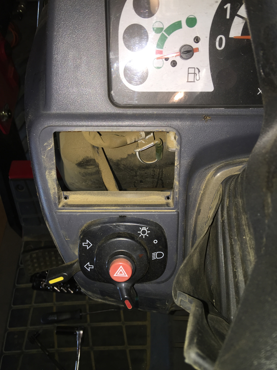

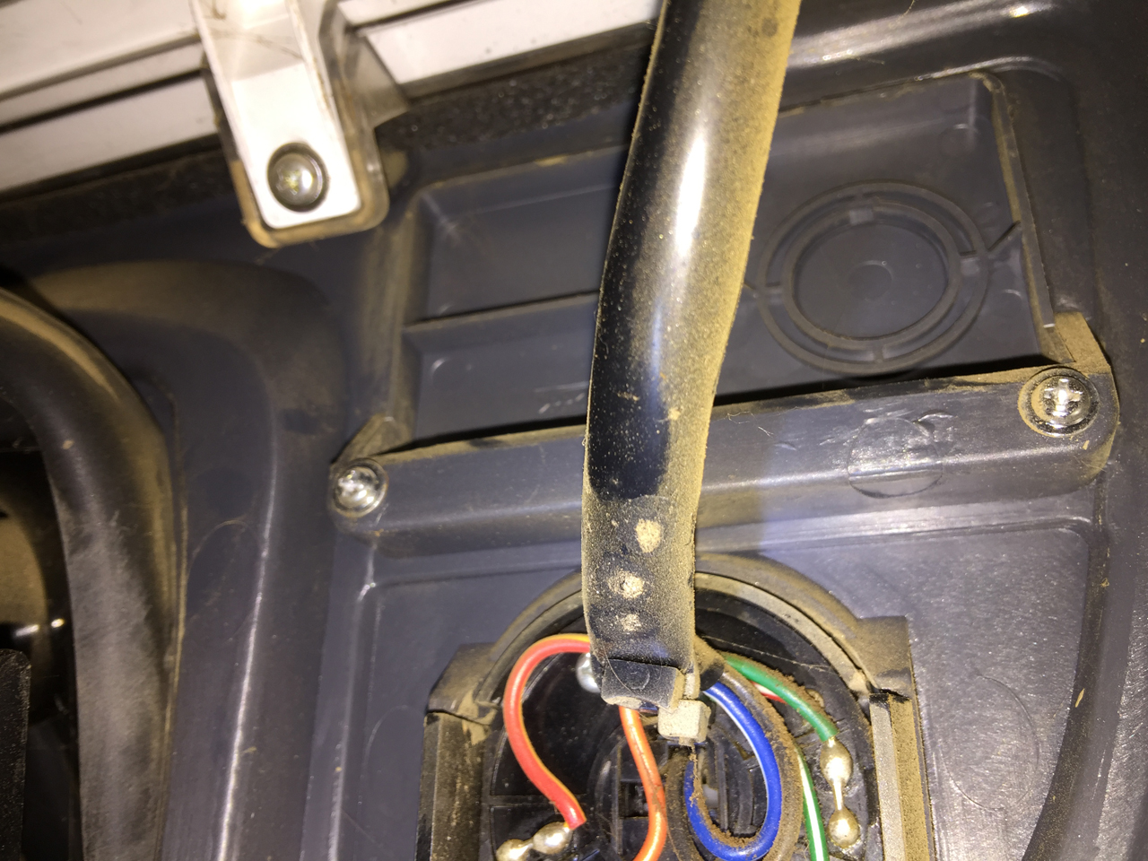

The dash is a bit of a pain to take apart and linuxman51 did a write up of his removal during his light install. http://www.tractorbynet.com/forums/mahindra-owning-operating/349663-max-26-work-lights-woo.html The cover plate is attached from behind with two little phillips screws that you have to remove to get the plate off. IMG_5238ts.jpg

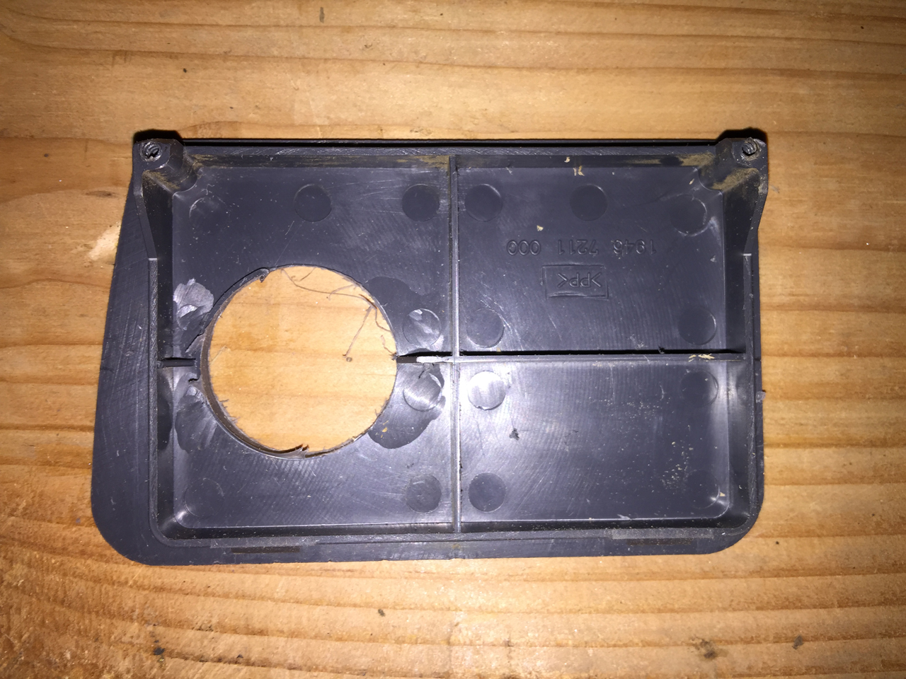

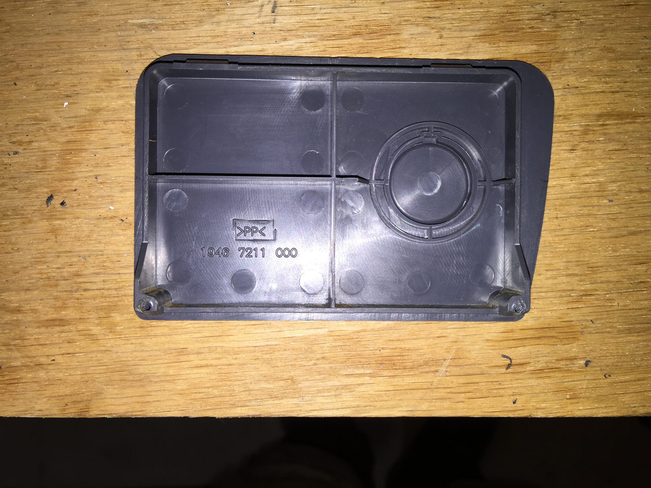

The backside of the cover plate has a circular reinforcement in exactly the spot I wanted to use, as if Mahindra had planned to put an outlet here, too. IMG_5248ts.jpg

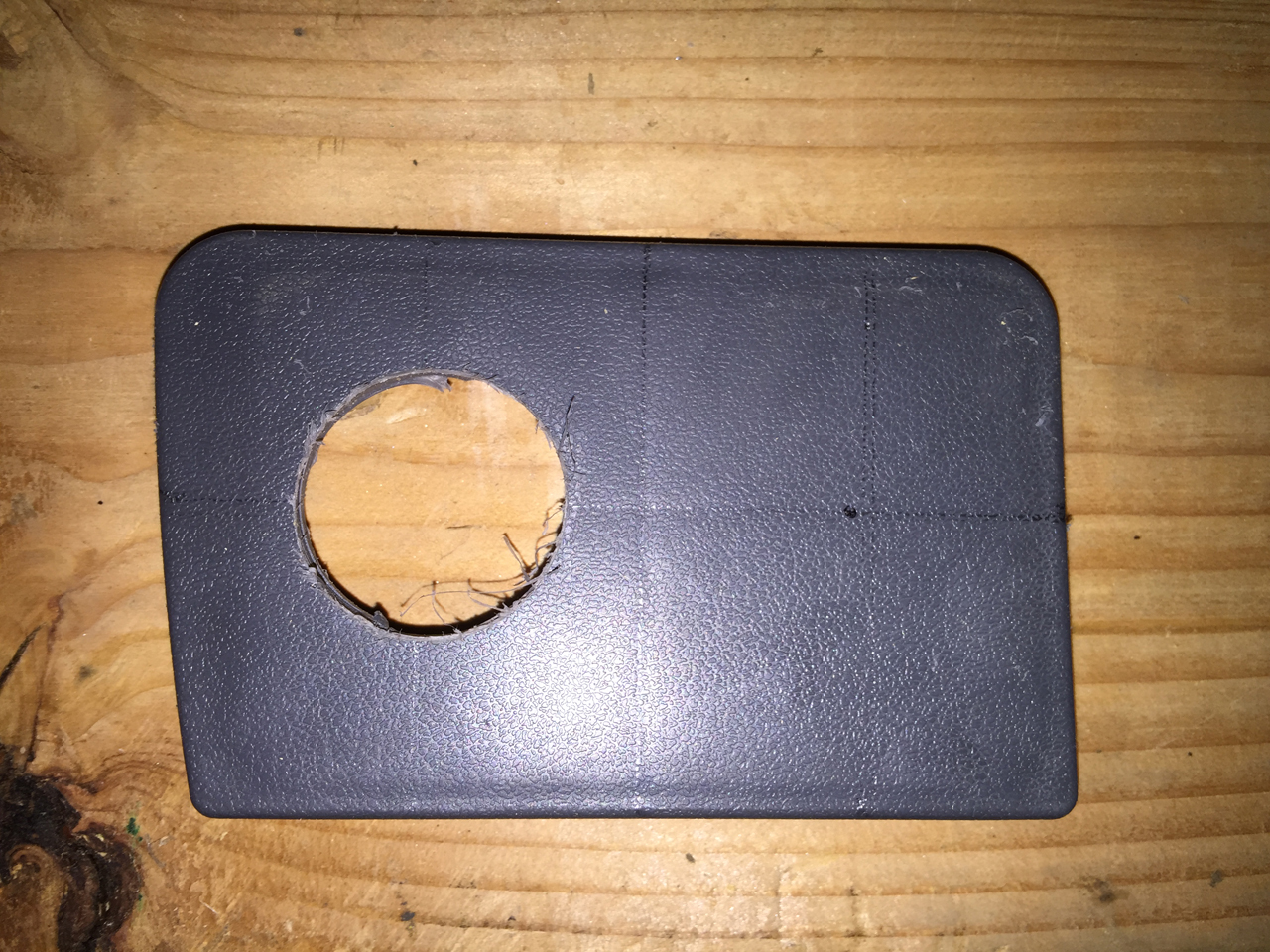

I laid out some reference marks (I'm planning to install a light switch next to the outlet) on the cover plate and drilled it out. IMG_5250ts.jpgIMG_5249ts.jpg
The wiring is pretty easy to run. I added a tap to the battery and ran overkill 12 gauge wire adjacent to the existing wiring along the left side of the engine and into the dash area. An inline fuse was placed near the battery for easy access if it's ever needed.

The advantages are that I can keep my cell phone charged, or my music playing, or to top off my battery from a charger (I wired direct to battery), or for when I pull my lawn fertilizer sprayer which runs off 12 volt.
Really, it can run anything that needs 12 volts, and I won't have to open my hood to attach alligator clips to the battery.
Also, if you look at the picture of the completed installation, you can see that the outlet has a rubber cover on it to help keep moisture and debris out when not in use.

There was no mounting location anywhere else on the tractor that would allow for a clean, recessed installation. And it's still easier than stringing an alligator clipped wire from the battery every time I need power. It might not be everybody's cup of tea but I'm very happy with the install.:):D
