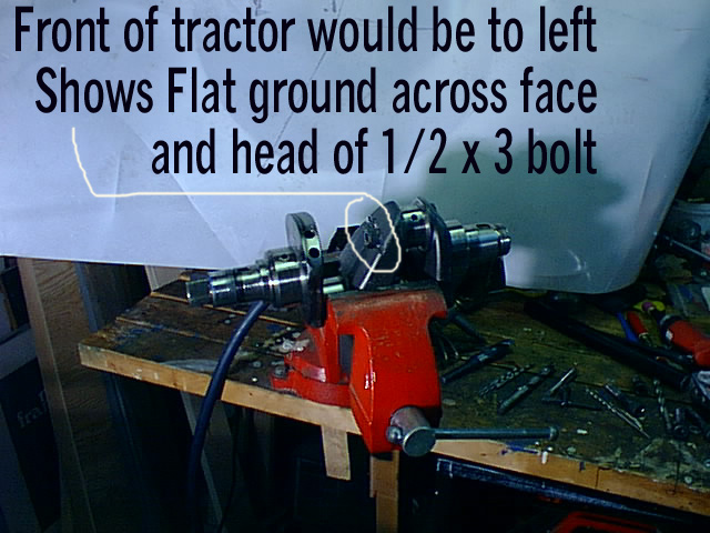

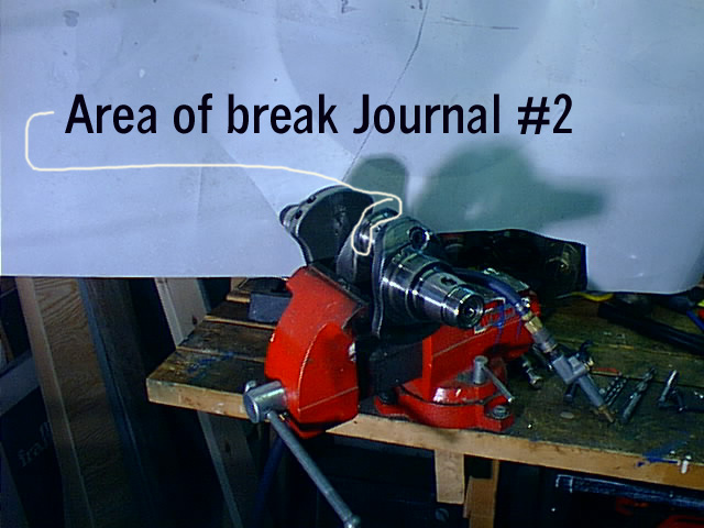

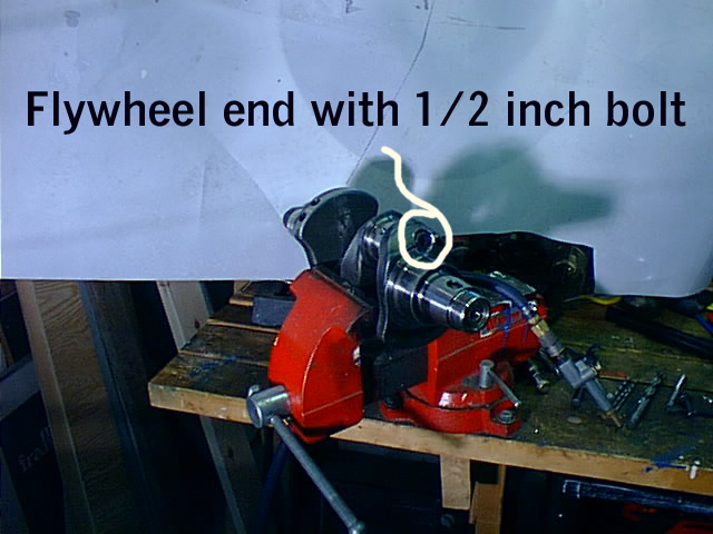

I...I...didn't know.....the mere possession of a...gulp.....a.....repaired crankshaft.....was such a baaad thing. The five and six foot mower decks the forum members are buying are worth more than this tractor before the break! I enjoy the challenge of the unrepairable! It'll make at least a good portable dolly for those pesky 3pt implements./w3tcompact/icons/smile.gif

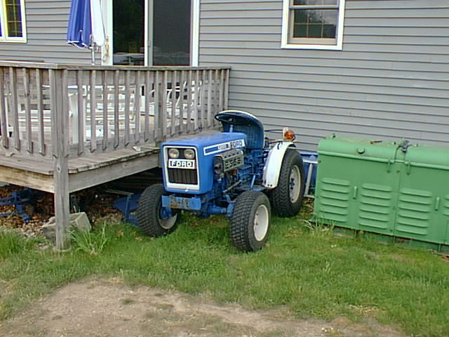

Just an update to let you guys know I'm not logging armchair hours here. In addition to testing the crank repair, I'm also testing for that elusive break-in-half problem. Things are dry at the corn patch and that's a sprinkler post I'm planting. See attachment. The machine is running better after an hour and a half, the injector pump must have passed an air bubble I missed when bleeding the system. SteveV

Well time has past and so has the faithful friend. The repair loosened up after 3 hrs to a point where the clank sound and the rap in the seat were back. Not wanting to destroy the block or bearings, I just stopped using the machine. A neighbor of mine is looking for a crankshaft for his 1200 rebuild project. In retrospect, I would leave the old slipping clutch in these gear machines; it's protecting a very unreplaceable crankshaft (I had replaced the clutch a couple of months before the break). Investment wise, the machine, blade and the Woods finish rm59 cost $2600. ten years ago. Another possible lesson here is to remember that this was a early generation compact tractor; there weren't all that many imported, and it is not going to be a significant Smithsonian piece. The machine owes me nothing./w3tcompact/icons/smile.gif SteveV
