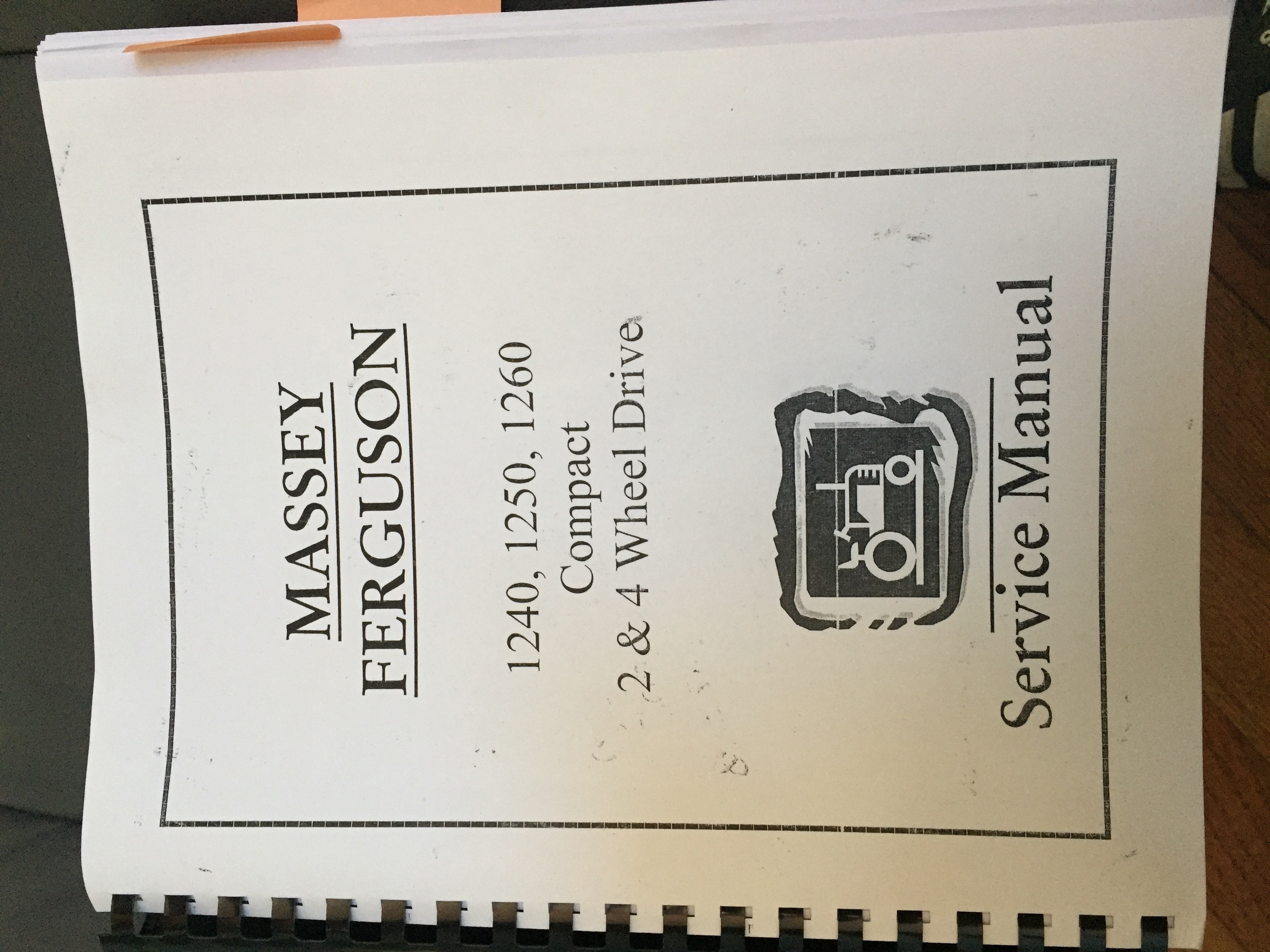

Picture of Manual - You have to be careful in picking a manual. For instance the water pump pictured in this manual is not the same as the one on my tractor. I think that had two different engines during the 1998 model year and the name plate data is not helpful.
My manual has a Massey Ferguson part number and seems to be official. If I run into a question, I call my parts guy and he sends me a .PDF of the info I need. My next major maintenance item will be valve lash adjustment on the engine. That should be fun. I doubt the engine valve lash is out of spec (it starts at the second engine revolution hot or cold and pulls smoothly at all RPMs) but, I need to be sure.

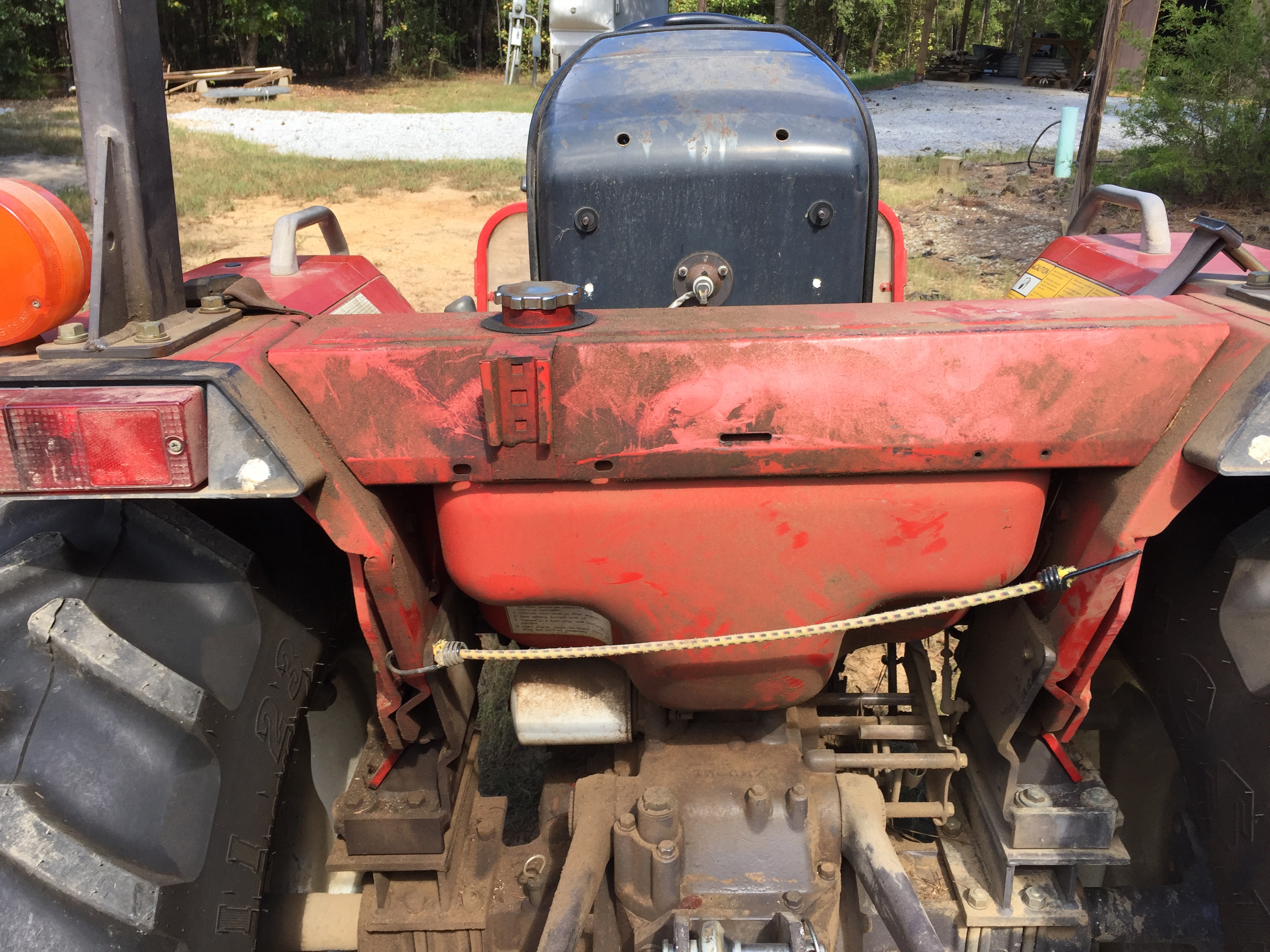

My 1250 does the exact same thing. I believe mine has something to do with the gauge cluster. When my gauge acts crazy i can beat on the dash and it will go back to working correctly.
   / 1250 Fuel Gauge Issue
#16
Now that i have my water pump issue fixed, I will undertake the next task of fixing the fuel gauge. My first task will be to find out where it is located on the tank and then check connections, including the "grounding" test. I believe that is part of the issue.
The event happened after I washed the tractor and I think water may have entered some connectors and the resulting corrosion causes the issue. But.....
