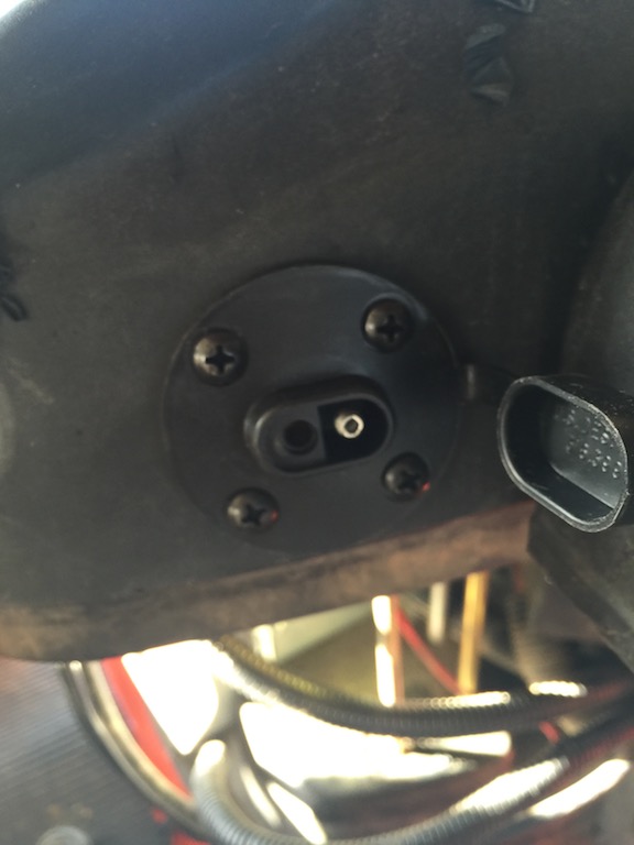

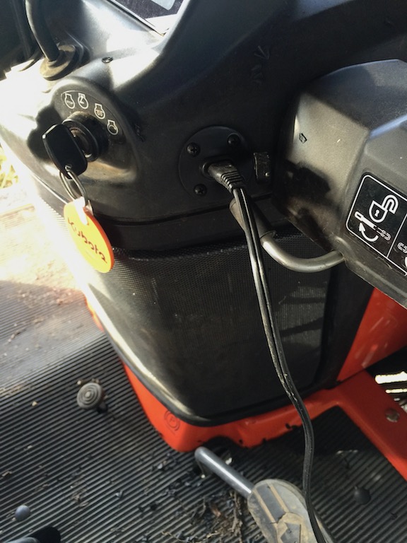

I installed one on my B2620 same as how you are doing it. Direct battery power, made sure wires were routed so as to never rub through, fused and just bought a factory power port from a tractor model that came from factory with one.
Like you say, not keyed power, so you have to be sure you don't leave something plugged in over night. But I wanted it for the heated shield on my snowmobile helmet I use when snow blowing. Works great.

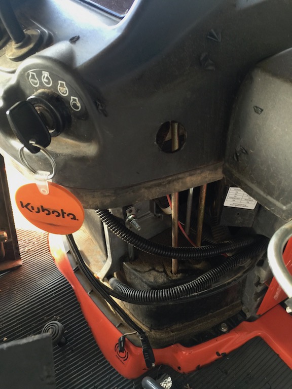

I have 2 laying on my "projects" shelf to be done on my Kubota. I got them from Amazon and they are marine grade for boats.

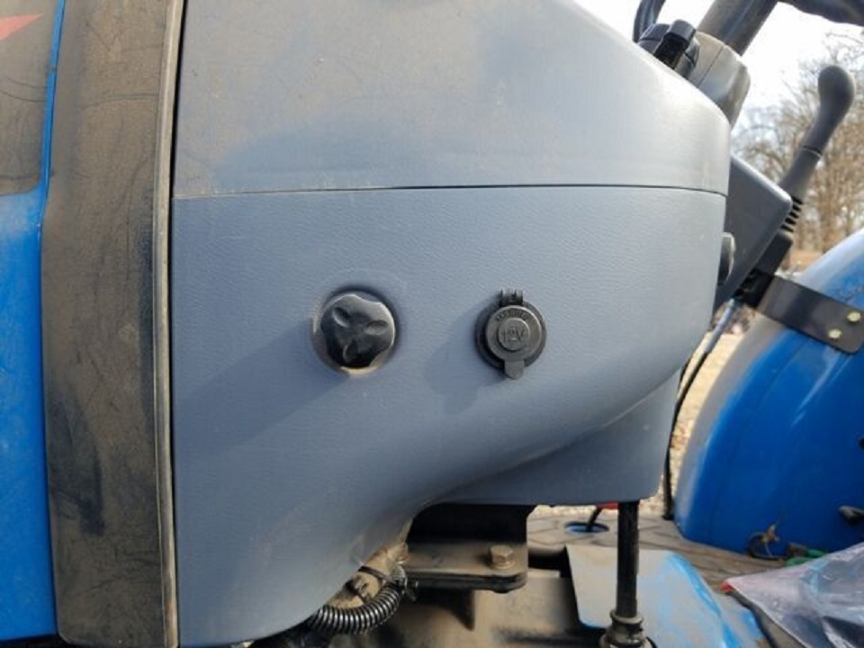

Finished the install of the 12v power port on my XG3037 today. Installed it on the lower left console cover. Here are the parts I used:
*Inline 15 amp fuse holder (included the 15 amp fuse)...Amazon $4.99.
*12v marine grade power port with dust cover (included two female terminals)...Amazon $7.99.
*2 ring terminals (to connect wires to battery terminals).
*1 butt terminal (to add an additional length of wire to the inline fuse holder).
*5.5' of red 16 gauge wire
*6.5"of black 16 gauge wire
*5' black flex tubing for conduit.
Total cost was approx $20....give or take a $1 or $2.

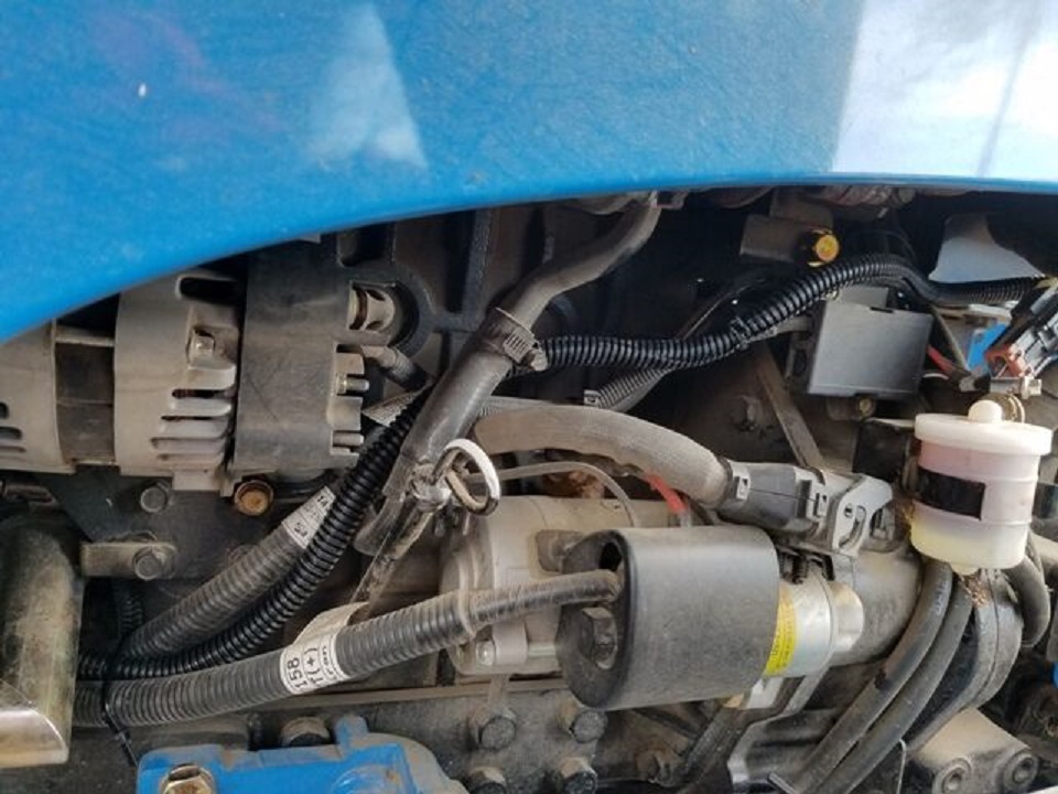

Made up the wiring harness first. Removed the lower left console cover and then carefully drilled a 1" hole for the power port. Had to slightly enlarge the hole using a Dremel w/ a grinder bit. Installed the power port, connected the wiring harness to the port, and reinstalled the console cover. Ran the wiring harness along the same path as the other wiring harnesses and connected the wires to the battery. Zip-tied the wiring harness as needed.
Glad to have this done....will use this 12v power port for many tasks and always good to have alternate power sources in case we lose power at the house.
