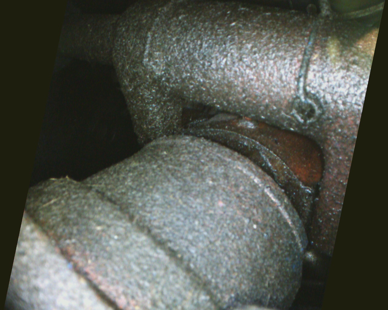

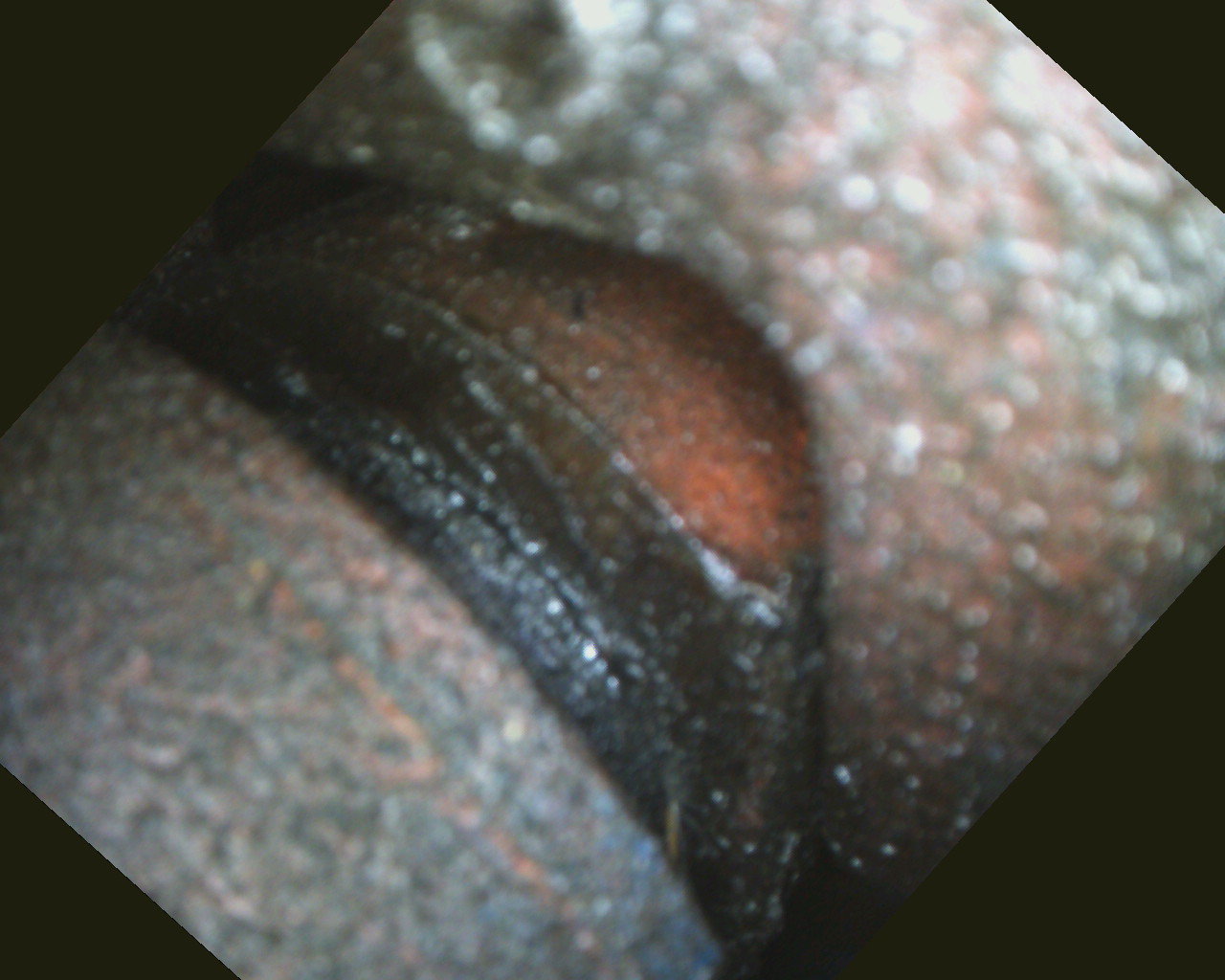

It is like an input shaft on a regular trans. There is a clutch right in front of it. The charge pump is part of the HST assembly. I think it may have been a quirk that it leaked a bunch of fluid. When I plumbed my new backhoe and tried it out, the quick connect on the pressure side was not plugged in all the way, and it got started up a couple times like that. I am thinking this may have forced fluid out of that seal, and dumped it in that case. Then when I ran it and the pin jiggled around, it leaked out. I plowed snow with it for about 20 minutes yesterday, and it idled for a while as well, then put some tupperware under the pin to see how much leaked out. The tupperware was dry this morning, and no oil dripped while I was running because the plow bracket directly below was dry when I parked it last night. I will watch the fluid like a hawk for a while, but I think I may have dodged the bullet for now.

might have just run down the side of the case if it's dry now...

It is still dripping a little every time I use it. I went to my local dealer and spoke at length with the service manager. He said I would not have hurt my HST by starting it with that one quick connect off. He said doing that would only hurt the hydraulic pump, and it appears fine as all hydraulics are working as good as ever. They are a little slow this month, so they are picking up and delivering for free, so they are picking it up this week, and he will do some tests and look it over, but it does sound like it will need to be split. He said ballpark 1000-1500 in labor, plus parts. He says it usually ends up just being a seal job. As long as the HST is good and can be re-sealed, I am okay with this. I just don't want to wait for it to blow all the fluid out and do real damage. With only 1400 hours on the clock, I am hoping for minimum 10 more years out of this thing, but will try for 20!
