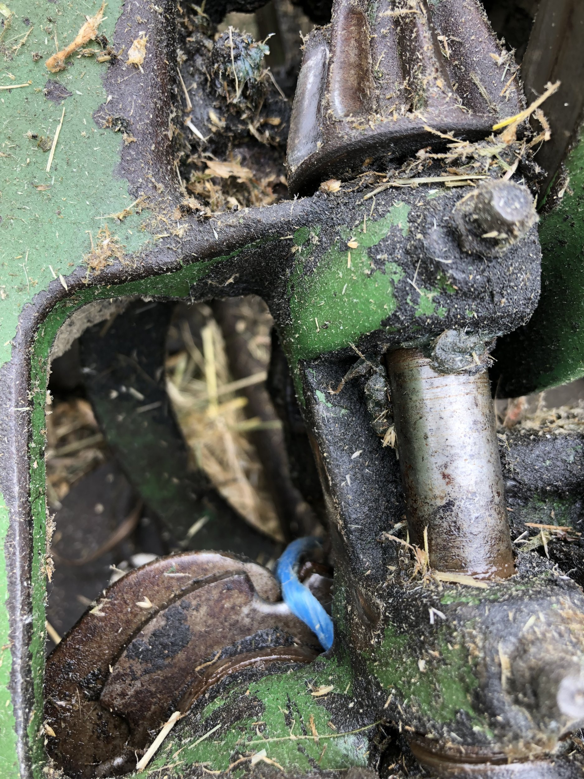

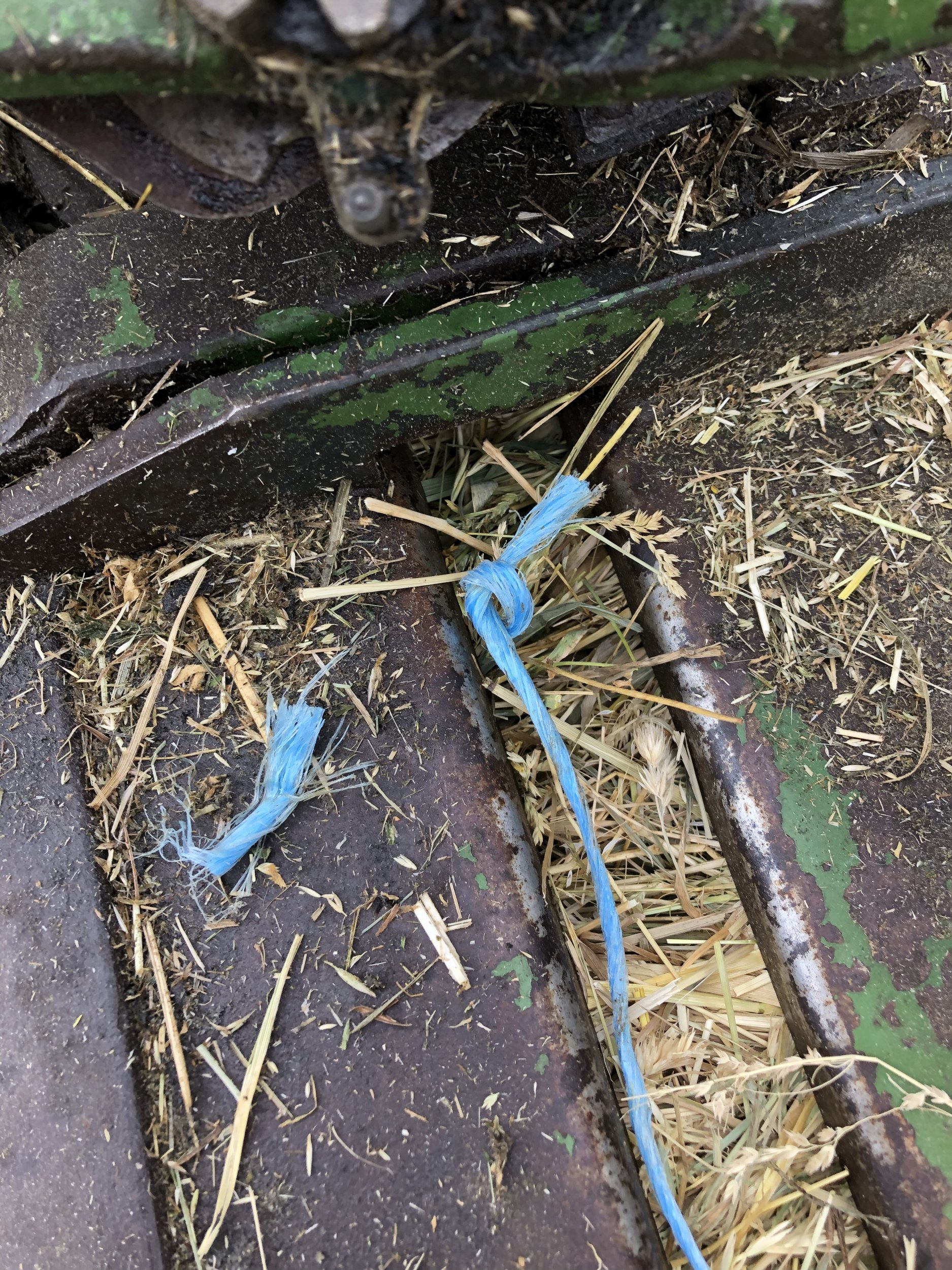

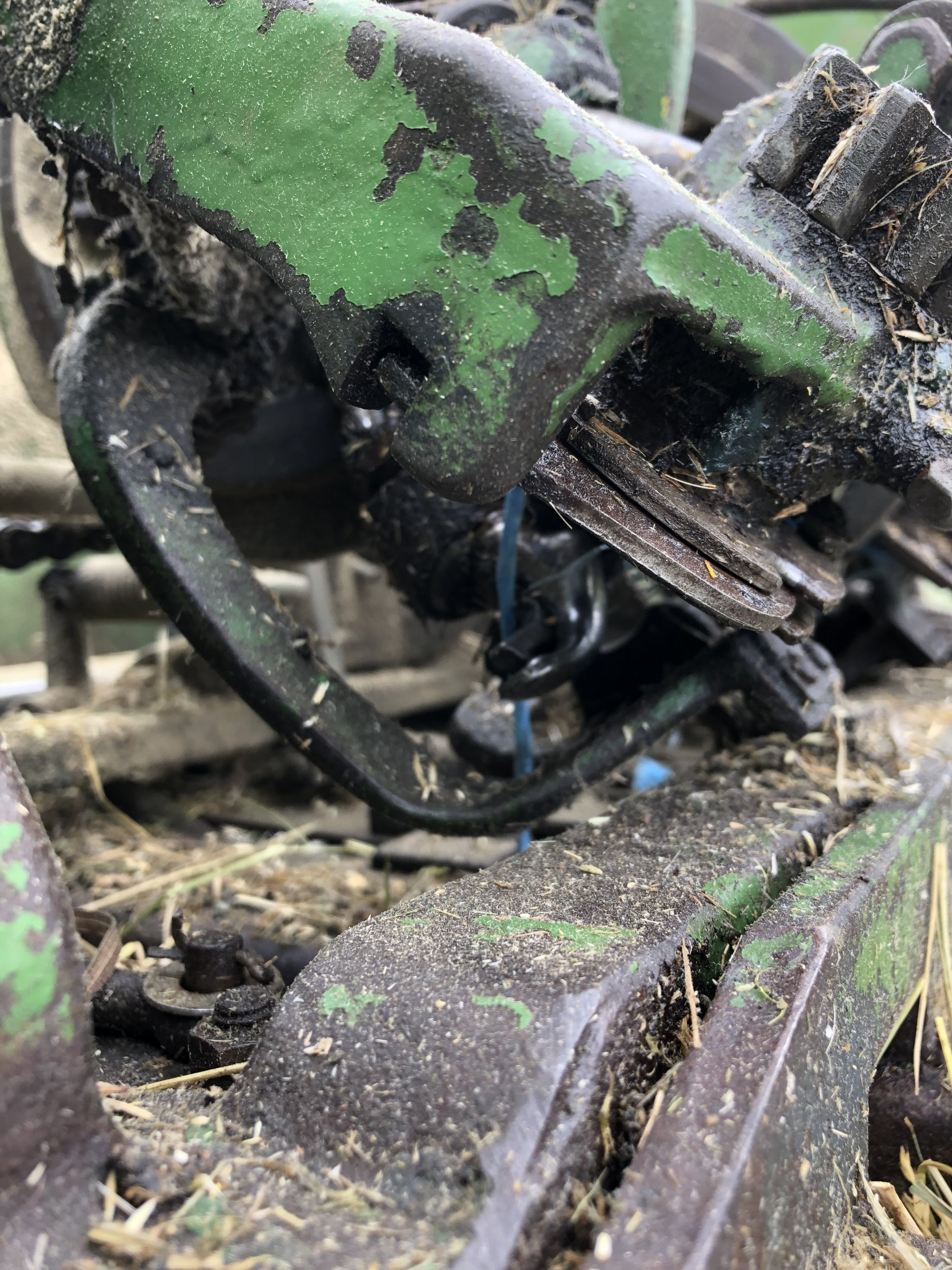

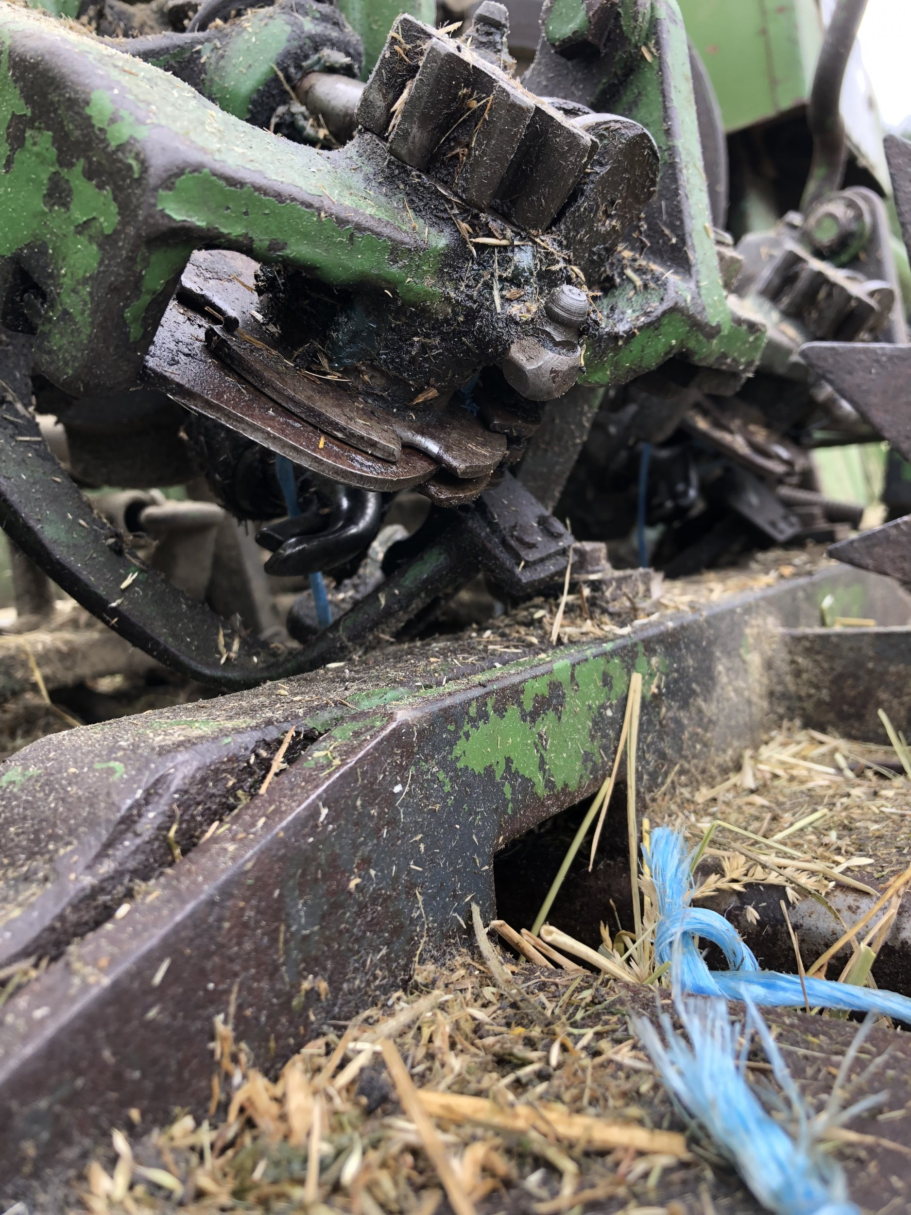

My 14 T won’t complete its knot or the knot won’t hold. Have followed all the manual tips including needle alignment. This is happening on both sides. Hay dogs are working, have adjusted tucker arms, tension on twine, bale chute loose and tight

First off, the 14T is set up for sisal, not poly. The twine discs are incorrect for the thinner poly twine.. You'll never get it to toe correctly with poly with those sisal discs.
   / 14 T bale knot #3
The other issue is, the knotters (billhooks) aren't hardened and poly will destroy them pretty quickly (if it has not already). Poly twine bailers have case hardened bill hooks and multi segment twine discs. The 14T don't.

-- I don't think this is your problem, but it looks like your twine knives need some touch up. Are they riveted on? Are they sharp. Your twine ends looks kinda ragged.
-- On the bright side, it looks like the wiper arm is properly sweeping the string off the billhook. Don't mess with that.

-- I would make very sure that my twine discs were super clean and greased. Blow everything out really good with compressed air. If it was tying for you before, I wouldn't start adjusting the twine discs until I eliminated the tucker fingers as a problem or replaced them with the new updated design tucker finger shaft and control arms.
-- It looks to me like . . . maybe . . . just my impression from the pics . . . if I'm looking at the pics correctly . . . (think that's enough disclaimers?) . . . . that your tucker fingers aren't bringing the string from the needle over to the billhook in order for that end to get spun around with the billhook and the other end of string and then wiped off as a complete knot. That's why you have an open loop laying on top of the bale and the other end is not part of the knot. Looks to me like it never made it to the billhook so there was no sting tension to pull the knot closed/tight after it was wiped off the billhook. See if you can cycle it slowly enough by hand to confirm. (BTW, mine usually won't cut the twine when cycling by hand, but you can see if things are moving and in time.)
When you said you adjusted your tucker fingers, did you also verify that the tucker finger control arm/shaft is not bent and that it cycles them smoothly and completely on each tie? Is the spring that pulls the control shaft back good and strong? Are the tucker fingers sloppy? Are they hitting or hanging up on the heavy wire guides that keep them low as they complete their swing?
Do the needles bring the twine up and into proper position for the tucker finger to pick it up and sweep it across?
