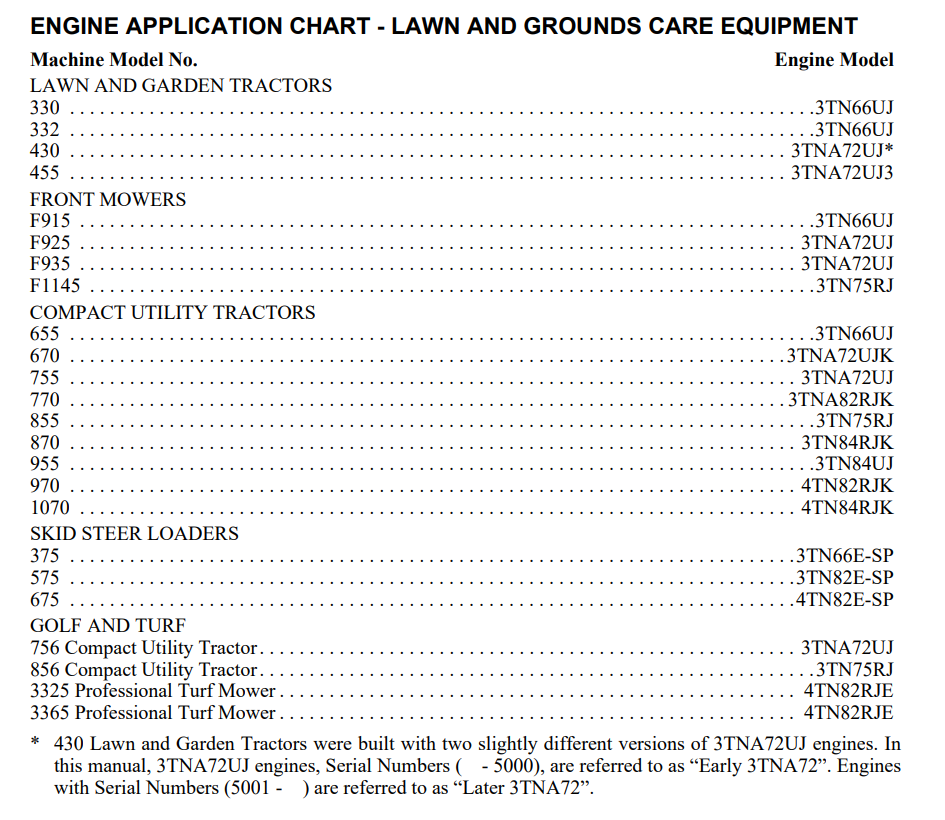

Thank you ! I pulled the head off today to get a look the three smaller bolts were hand tight also found a intake air leak at the gasket as well as a crack in the manifold right by the back bolt so someone has been inside this tractor before me . I have owned it about a year and a half with no problems till now . Cylinders look good no scratches I had no blow by , I’m going to slam a head gasket on it do the heat cycle and re torque . Would air leaks play a roll in my problems ?
   / 1401D missing and running rough
Yes California
   / 1401D missing and running rough #8
These Yanmar engines have a certain way to put the heads back on and a 3 stage torque method. Do not, these tractors are build to JIS standards and from the Japan industries. Doing it the American way would only ask for trouble. It's another reason why Deere compacts made by Yanmar have lengthy service manuals too. I'll poke around for a 3T72 engine service manual or a 3T75 version because they are setup in that size of engine family.
OK the US domestic sold YM186 has the 3T72HA engine. The parts manual is all in English.
The John Deere JD670 has the 3TNA72 engine. The NA just means it has the first generation emission hardware added. The head is the same casting. TM1470 Technical Service Manual and CTM-3 is what you need to follow getting the head back on the engine. :)
Here's the engines covered in the CTM-3 manual.
OK, found the page we are after. Note to dip the cap-screw (bolts) in CLEAN engine oil before the torque down procedure.
