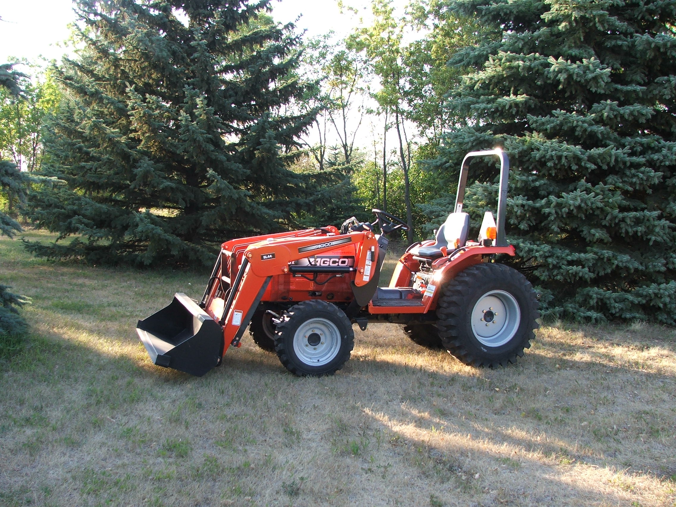

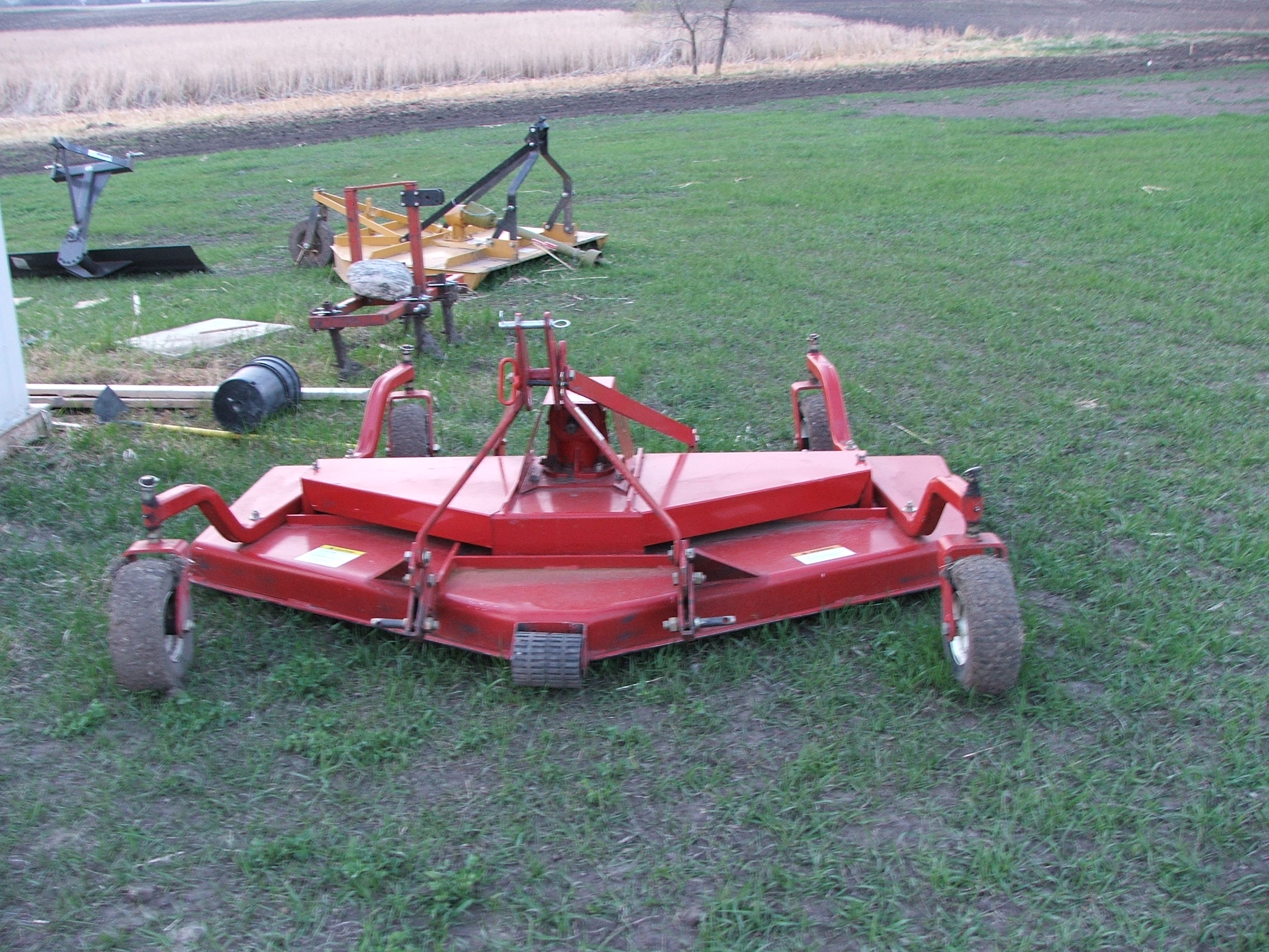

I use a 7ft Farm king mower on my Agco St30x basically a 1428v. i have included a picture of the tractor and mower. I have no problem running the 7ft i basically run at PTO speed and a ground speed of about in the middle of mid range.
i do it every single weekend on about 7 acres
