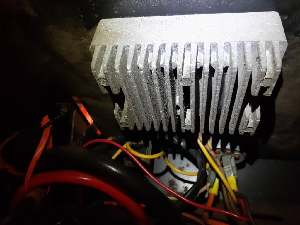

Original regulator/diode, 3 leads, 2 stator pins I get 22.8 vac at 1500 rpm...but 12.6v motor wide open.
So I assume reg/diode is bad.

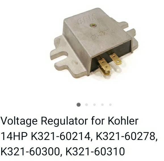

1) On Ebay sellers have 3 pin regulators for the 321...I assume they'll work ok? They're much smaller than original.
2) I charged battery here on high, it never got over 12.6v engine running. Unplug regulator it drops to 11.8v.
3) there's no parasitic draw...I checked.
I would think having it on high charge rate shouldn't it be 13.5v or so?

You do seem to have a charging problem. It should be hanging at about 12.6 volts and when charging it may approach a thirteen volt or higher surface charge. Try charging the battery on a house powered trickle charger. It does sound as though something is wrong with your regulator or rectifier. Newer units may be physically smaller than the original because newer solid state devices are smaller than they used to be.
